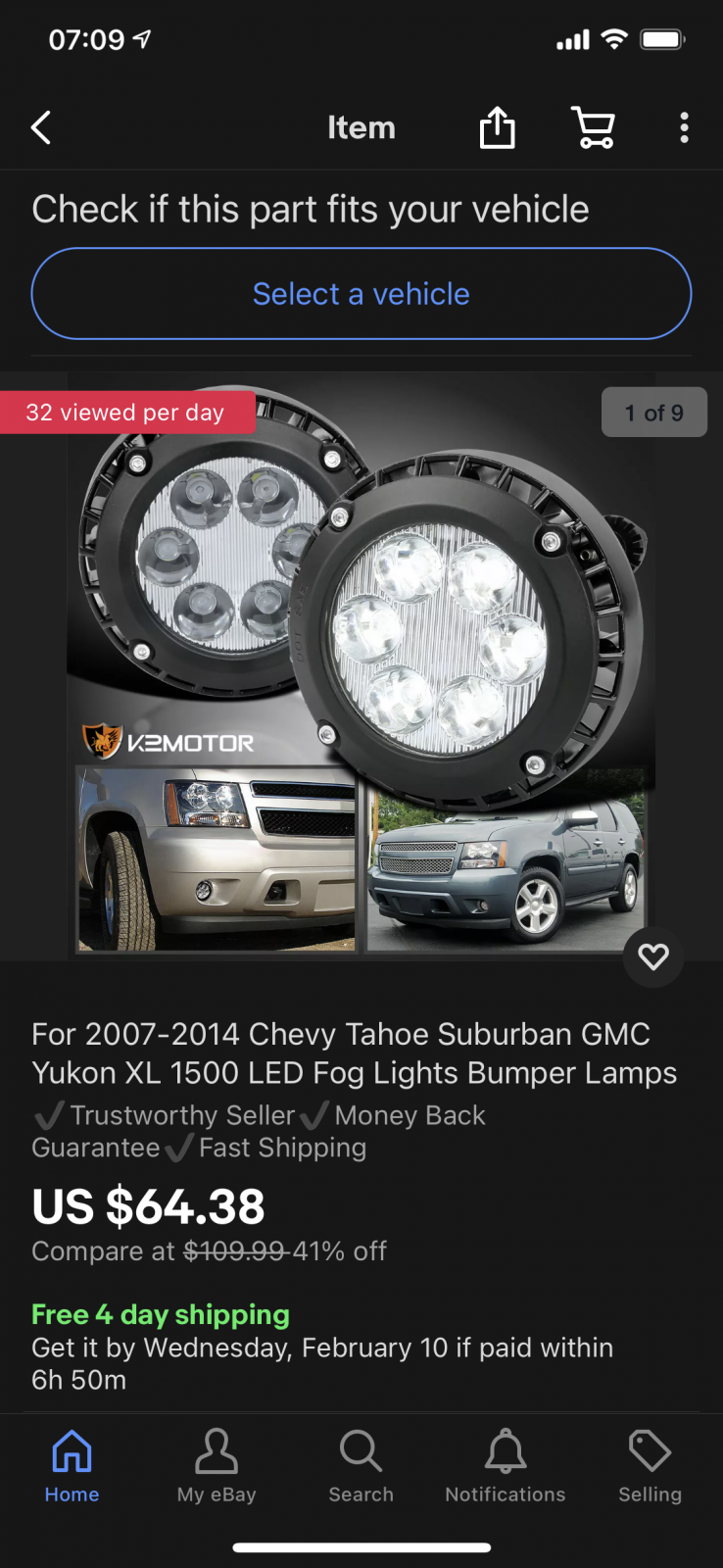

I think I may just end up ordering these I like how bright they are. I went with the square ones on my Tahoe because they put out 2k lumens each and was only 40bucks.

Those are not fog lights, and neither are the round ones you just posted.. that is why people are pissed at you. Because the light shines right in their face.. neither would pass inspection in my state because of this. Fog lights have a cut off line like factory lights do to keep from blinding oncoming traffic

Those are lights, but not the ones made for driving on public roads. Avoid a potential rage episode, especially if you’ve got a wife or kids in the truck.
The performance is in the reflector, not the bulb. Fogs are engineered to have a saw blade pattern so the light doesn’t reflect back at the driver in the mist. Reflectors to house an led bulb in a fog pattern isn’t here yet.
