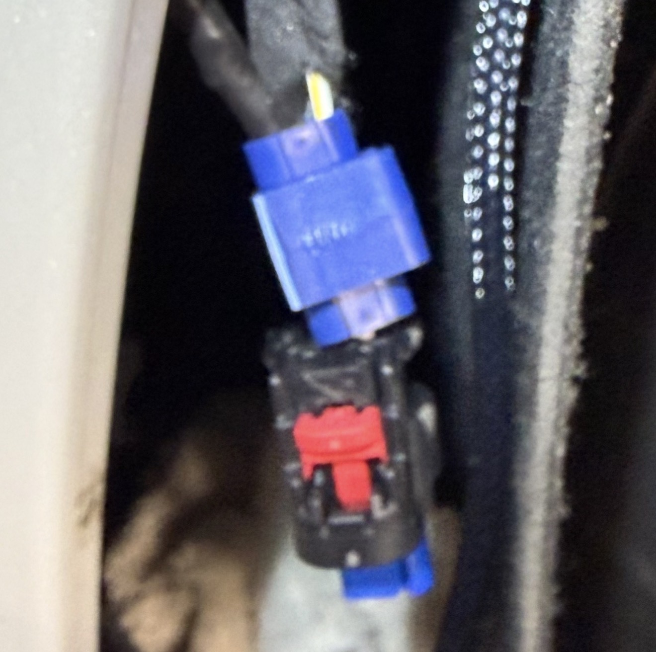

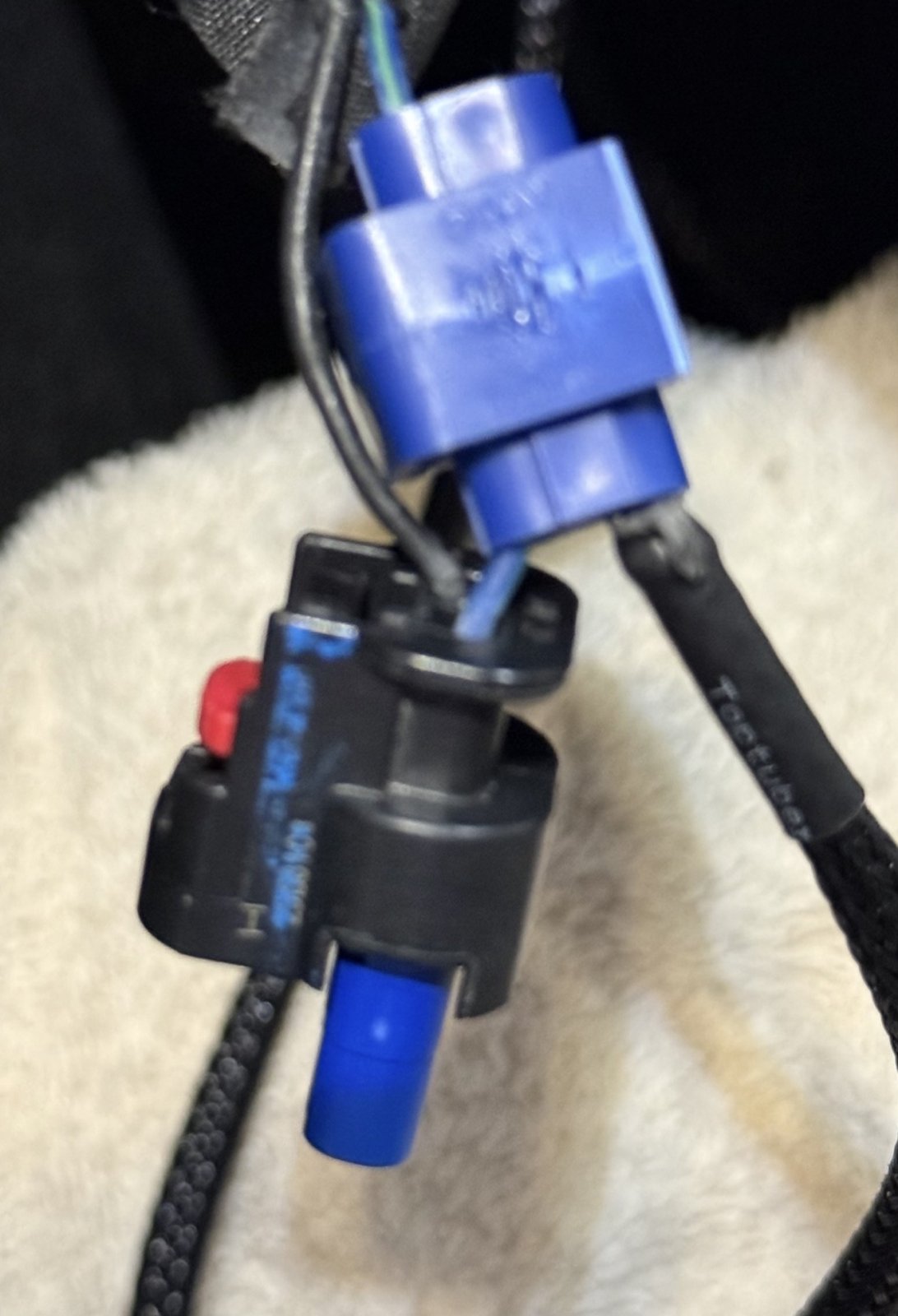

I installed after market fog lights with backlighting on my 2025 Yukon Denali Ultimate. To the extent helpful to others, I tapped the side marker lights for the backlighting. On the passenger side I tapped the blue wire. On the driver side it was the white/yellow wire.
