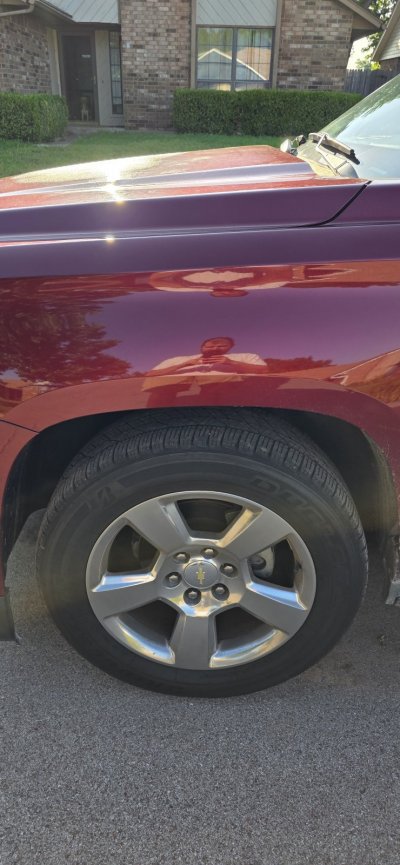

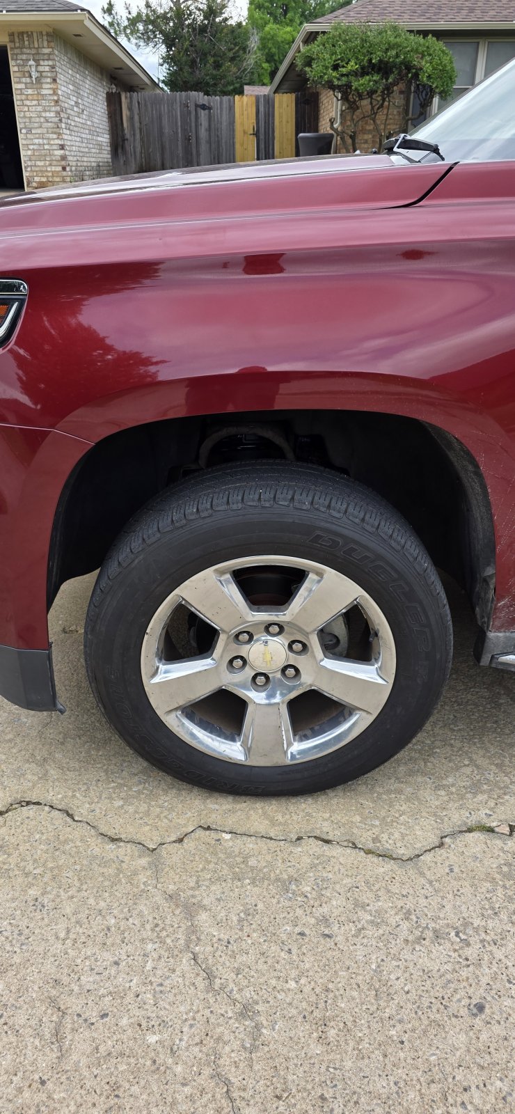

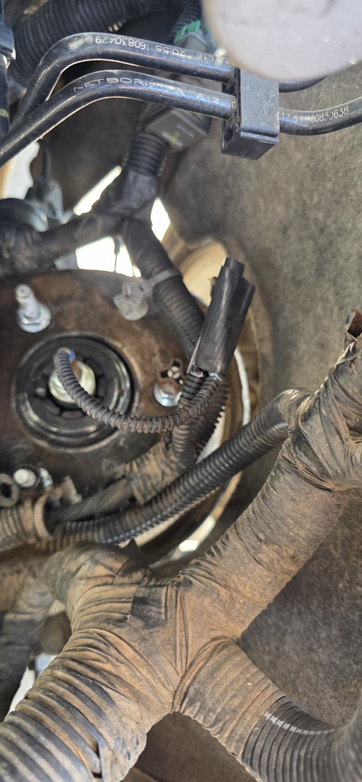

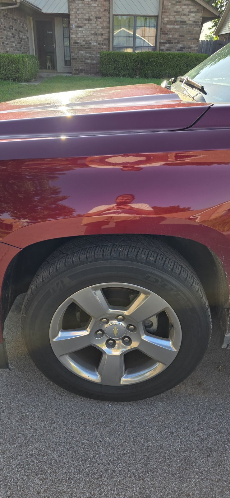

Im so glad I found this page. I had a shop install the same stuts on the front of my 2017 suburban and had the same problem, struts were stiff and bounced quite a bit, but also raised the ride height back to stock that's how worn the og stuts were. About 2 months after install I had noticed the driver side strut was hardwired with duct tape not plugged into the factory harness. The shop that installed them had crushed the plug on the strut when installing and they said the replaced the plug with a 2 pin universal, they lied about that. I didn't think anything of it at the time and didn't check the mechanics work so that is on me for not doing my due diligence after the repair. Well I thought the plug being missing on both the strut and the factory vehicle harness( that shop cut it off when they hardwired the strut ) that would be the problem. It was part of it sure but not the root cause I think. Had my best friend that's a body/ mechanical tech wire in new plugs on the strut and vehicle wire harness so thats back to how it should be now. Called my local chevy dealer and got right in for service that day! Had them do the trim height relearn on the suspension control module and also had them do an alignment on the front and that solved my issues completely. Now the front rides like it should, like a cloud! 20250725_164526.jpg20250602_080707.jpg
