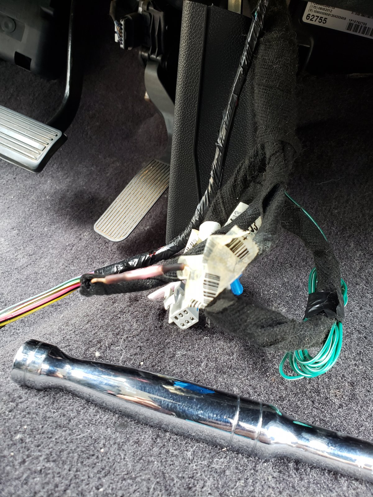

For the horn, here is a recent post about solving that.
Today, I got the horn working. :happy107: Thank you to you guys for the advice and the pics. They really helped. Got the wiring from under the radio, found the cut light brown wires, spliced them back together and HONK! It works! :D

Horn... wires are normally cut under the dash beneath the radio... tan wires... just butt connect them back together.. pink butt connector in pic is horn wiring...
