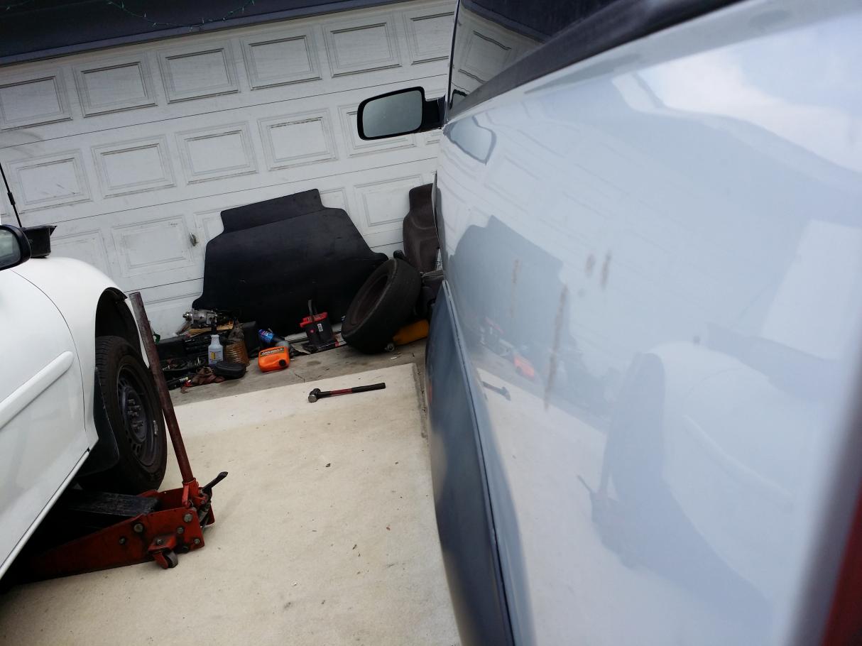

so you just grinded out the rust and stuffed it with filler? the rust will be back with a vengeance soon....

cleaned away the rust, and used ospho rust treatment generously. I stuffed nothing, i used fiberglass bondo and a mesh screen to create a solid wall and filled in the low spots with bondo. I know It's not a permanent fix, but it will last a while. I dont have access to a welder, nor do i know how to use one. The body shop was going to do the same exact thing, if they had cut the rust out and used a patch panel, they would have had to cut farther up the fender and then I would be dealing with a paint job that would have to be blended into the existing one... on black :eek:
This way it is all hidden under the body line, which is being bed lined.

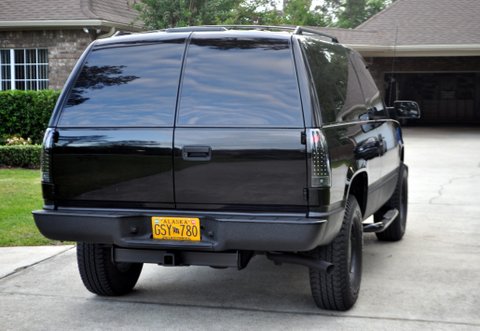

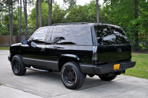

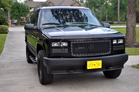

bed Lining
got the bumpers back on, honestly The bed lining looks really good from 5-10 foot away, and i'm not complaining... but the guy that did it seemed like he was rushing :( if you look closely you can see that he went up over the body line *i specifically asked him to go below* and in some spots it may have been put on too thick because it looks wet still. I guess that's what i get for shopping around and going with the lowest price. The bumpers, on the other hand came out amazing. he warrantied the rockers for life, but wouldn't warranty the bumpers, he was actually not going to do them at first because they were chrome, but i had already taken them off, scuffed them, done the body work, primed them, and left the truck at the shop. They definately dont feel like they're going to peel or chip off... *already had this problem once when i tried to used the spray on liner from duplicolor*
HID's from ddm and cold air are on the way, just have to track down a small oil leak... I thought it was brake fluid ^^ but turns out it just hadn't been cleaned after they did the brake job. Now I'm seeing small spots start to pool up near the front driver's side in front of the wheel. I'll take pictures of everything this weekend, maybe someone else has had the same problem and can help me out.

i would have sandblasted the chrome bumpers personally. then top coated them with primer/liner

after i tried the spray on stuff from duplicolor, i would agree 100% didnt stick at all... although it dried to a consistency of plastidip, which is supposed to peel. I'm sure I'll figure out whether or not it was good enough when I drive it up the alcan. not familiar with sandblasting, do i have to have a device to shoot the sand?

yes youd need a compressor and a sand blaster..paint doesnt stick to chrome really...i would have at min sanded it with 80 grit and then sprayed it with an etch primer to try and get the paint to stick to it

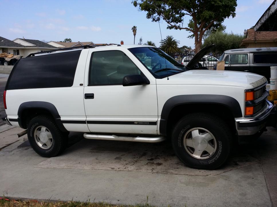

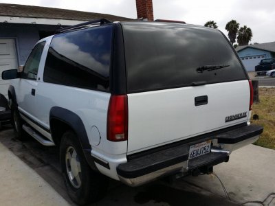

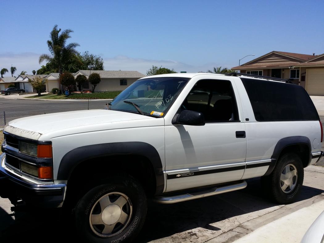

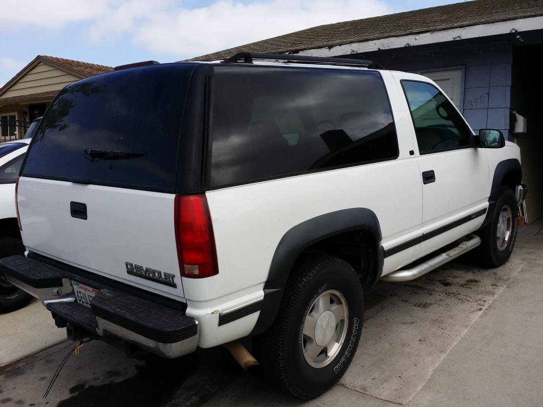

Hey what's up just looking to get some input on whether or not I should buy this 97 2 door 4×4 Tahoe 6.5L Turbo Diesel. It has no barn doors but doesn't really matter. I heard that only 200 of these were made in 97. This thing runs great and is bone stock. I don't have much experience with diesel motors but have always wanted to buy one because of the rarity of them. 200k miles LT model. Friend of mine only wants 3k for it. Is this worth considering? If I decided to buy it, and sell it what could I get for it? Or is this something that I should keep?

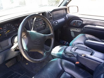

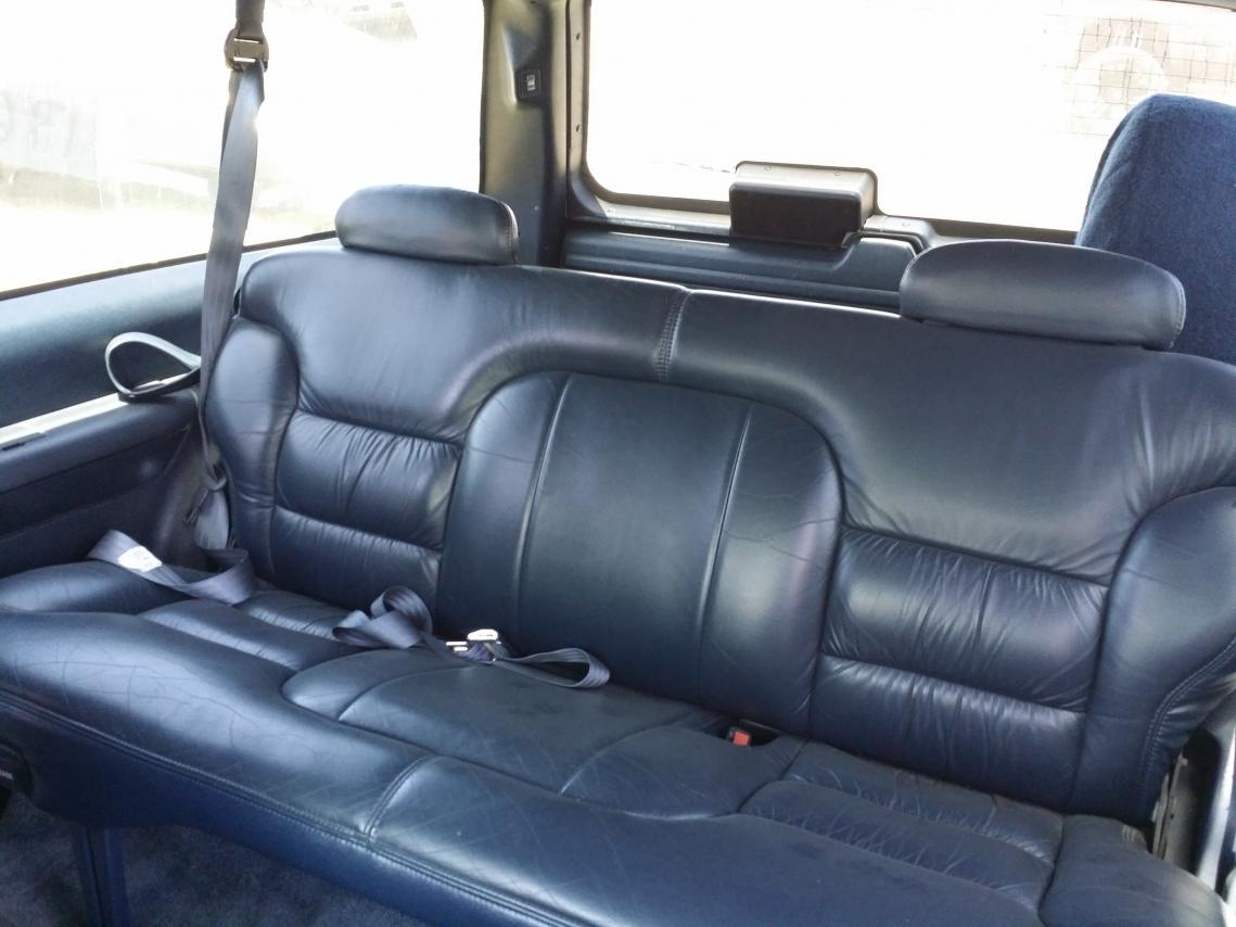

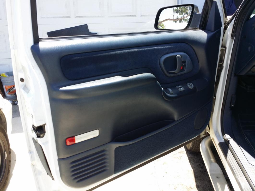

Here's the interior.

if you have the money laying around buy it NOW! the diesels are a easy sell if you decide not to keep it. and lots of fun if you do.

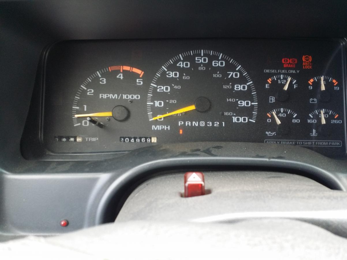

That's a sweet diesel two door, but looks like it has some low oil pressure at idle.
Noticed that also but the gauges were all over the place. The needles were bouncing back and forth. Looks like the cluster needs replacing.

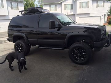

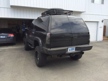

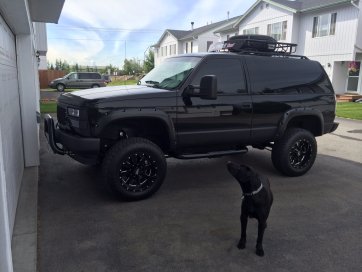

Update
Finally made it up north, put the new wheels on, and got some new towing mirrors...

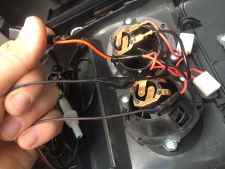

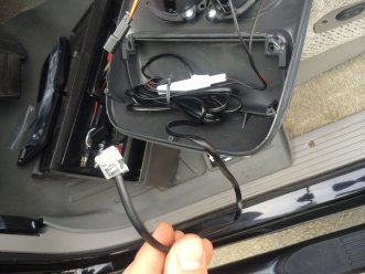

now the only thing i need to do is figure out how to wire this radar detector in... I wanted to wire it into the button that turns on my reading light (I saw my uncle did it with his BMW M5) but it didn't work for some reason... anyone know if it doesn't have enough power? its a passport 9500x, I wired it directly to the power and ground wire. please help :)

forgot, i got a bull bar and lifted it 4" too... its been a while since i've been on :chair:
I had one problem recently, coming down out of a pass, I started smelling something burning... i pulled over and my front breaks were smoking... are the wheels really that much heavier? or is there something else going on? It just recently had a brake job and new pads before i bought it. should i get slotted rotors and new pads? thanks
on the 2 door diesel... I'm for anything 2 door tahoe/yukon/blazer, but i am definately not an expert, never owned a diesel, and the FEW people i know who have, told me that that year of diesel was riddled with problems :( said they were surprised that it even made it to 200k (not the engine, that will last forever) BUT it's only 3k, so if it runs and drives right now, go for it! you'll get AT LEAST 50k miles out of it, then you can just part it out to us or buy another 2 door when it explodes :D
