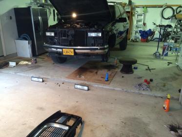

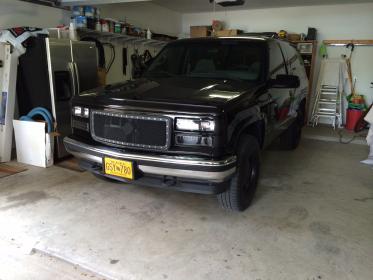

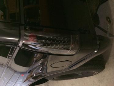

Finally got around to getting the pictures off my phone... So far it's just been cosmetics, havent done enough research in the performance mods section yet.
Question: in the 2nd photo, can anyone tell me if this truck has a trans or oil cooler? or both?
Ebay photo: before
Immediately ripped off the side moulding and running boards and installed a new grill and lights

I really like that grille. Did you smoke the turn signals?

Check to see if, from your oil filter, you have these two lines running off of it. They should actually run up and plug into the drivers side top and bottom of the radiator.
If you have that setup (which I believe you do), that would be your oil cooling.

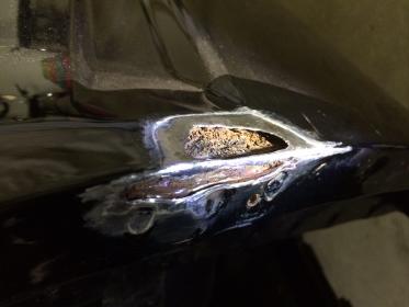

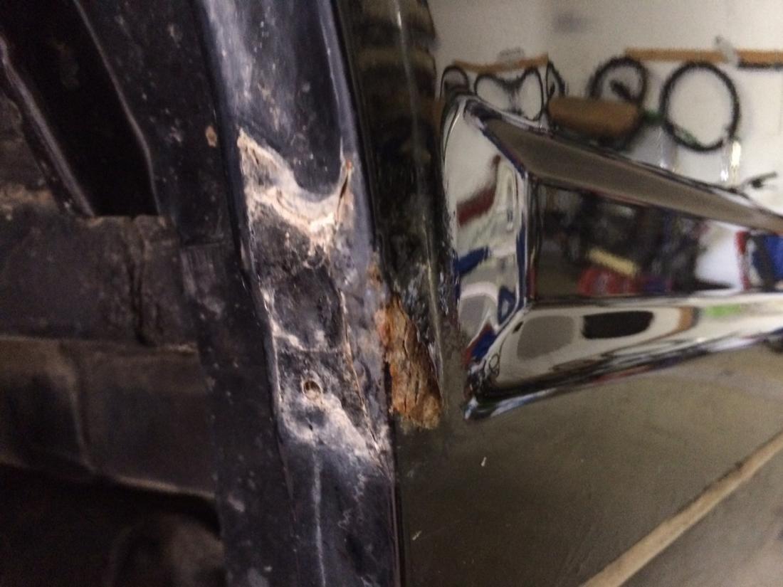

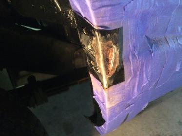

Here are some pictures of the rust spot i found under the trim. once i started grinding away, the inside caved in as well! luckily a small sliver of the actual corner steel was still in place! I dont know if i could have mimicked the corner otherwise.
I was really impressed with myself at how simple body work is. Saved $300 and the supplies were only about $50
*with bondo, that is, i know nothing about welding
I was so impressed that i took off the bumpers, removed the molding on those, and after scuffing the crome with 80 grit filled in each one. then i primed them with self etching and epoxy primer and the truck is now at a shop being bed lined (rocker panels and bumpers) and tinted.

I blacked out the corner lights, wheels, and third brake with plasti dip :D
I absolutely love the stuff and cant get enough of it.
The actual turn signals are just black housing LEDs though

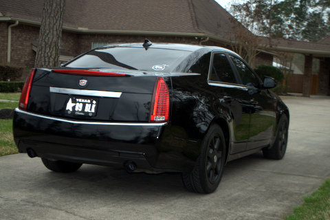

*my last car also god dipped in similar places
This baby is still for sale if anyone wants to take it off my hands!
