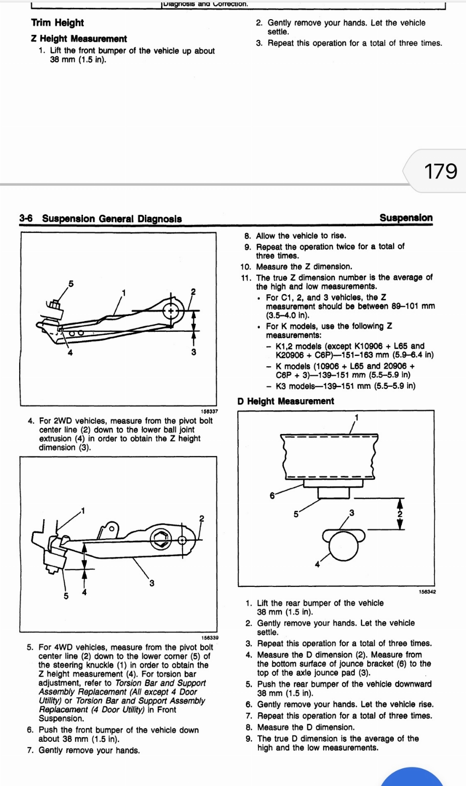

I am in the market for new shocks but need to compare my 97 Tahoe 4wd 2dr ride height against a known stock trucks.
I believe mine may have a small lift, 2" or so but need to know stock to be sure.

Not sure if you still need it, but here is the measurement from the manual. Use the 5.9 to 6.4” for gas.
On my 98 (2-door sport) the bottom of the front fender flares are about 36” above the ground. It’s leveled (torsion bar crank) though. Stock was probably an inch, maybe two, less.

Thanks for the response.
I got lucky yesterday and came across a GMT 400 Tahoe 4dr and driver getting gas at the same island as I was.
After admiring each other's rides, I asked if had a tape measure handy and fortunately, he did.
His is a stock 99 Tahoe, also never seen salt, and very nice stock leather interior. His is a completely unmolested elderly-retired owned Tahoe and it is a beauty.
After measurements, I am about 1.5 to 1.75 higher at the fender like then his.
I need to know this as I am going to get shocks for this, likely Bilstein 4600s.
