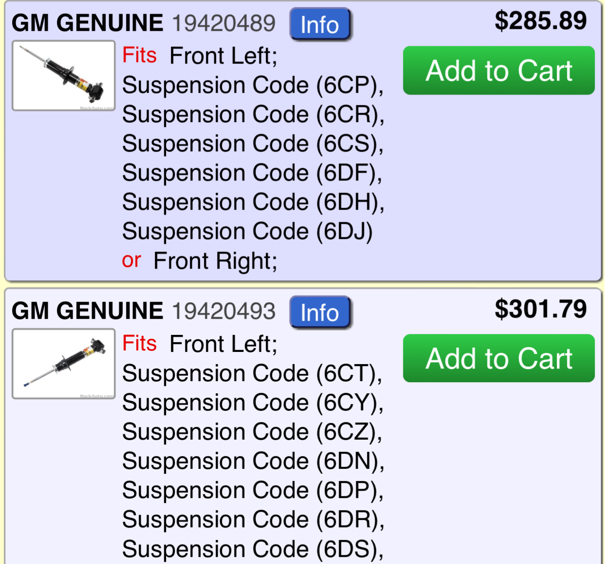

Appreciate all the info. I have z55 on my glove box tag. None of those other numbers appear on there. I’ll post pic. I have 6jk and 7jk.

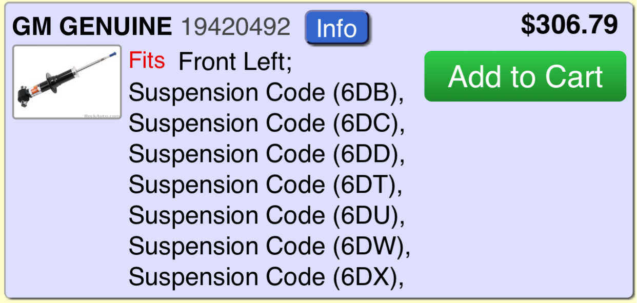

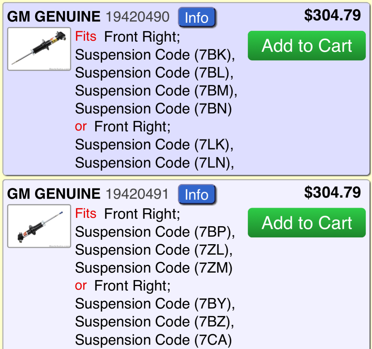

Some of those numbers from the RPO will appear on the R/A description for the front.
I forgot to mention that those screen shots do not show all the suspension RPO’s unless you go into the R/A app, open them up and scroll down.

Had to look to put my money where my mouth was. The RPO code is 6JK which specs you out to buy two identical front struts #19420493

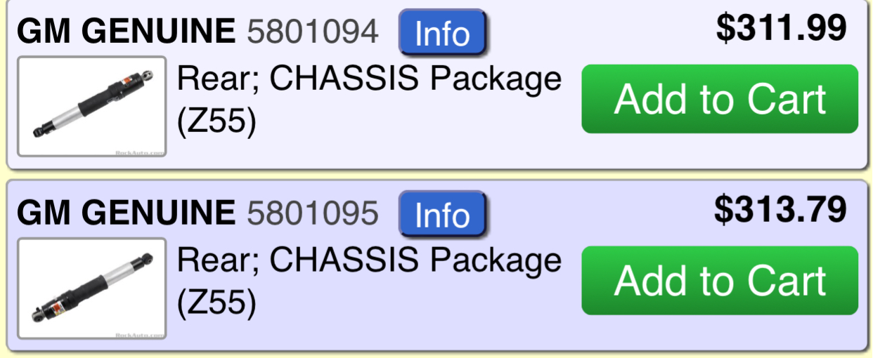

Both of the rear z55 part #’s will work. May as well as use the higher part # because it’s the latest version. No coil over set up offered unless you go to overseas made junk or off road capable which will give u a bounce house.
All rear z55 are air adjustable for ride height via the compressor controlled via height sensors in the suspension. The front is active like the rear but not height adjustable.
