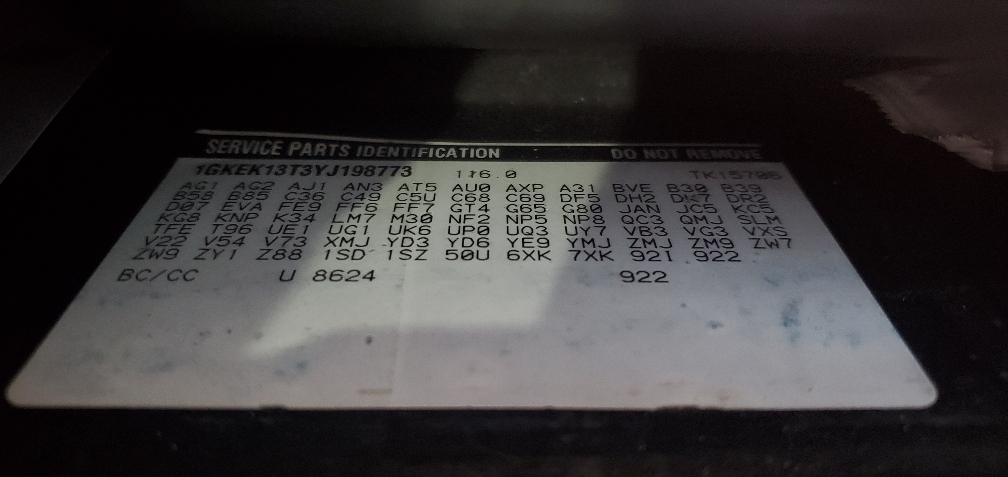

Post a picture of your RPO sticker in your glove box. Then we can see what your vehicle came with from the factory at least.

Heres the sticker

When I see that ZW7 RPO code that is a self leveling rear system and as I look thru all the options at RA, it only lists this as an option for the rear: https://www.rockauto.com/en/moreinfo.php?pk=1298060&cc=1440055&jsn=955
Not saying there isn't something else out there but I don't see it listed at RA. I know that some guys here eliminate that system and use different rear springs and standard rear shocks of some sort to bypass all that but I cannot pretend to know all about that like others will.

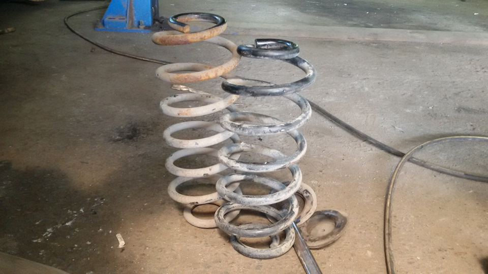

My Tahoe had original Autoride shocks at the front, and GM shocks from Hummer at the rear when I bought it.
Previous owner tried to switch car from Autoride to Z71, but did it wrong (even coils were original - too soft without pneumatic).
Now I replaced front with KYB Gas-A-Just KG5040 and rear with KYB Gas-A-Just KG54341. These series Rockauto recognized as Increased Handling/Performance group of goods.

Oh, sorry, as well mentioned by @Fless - you better check what coils you have at the rear.
Original Autoride coil is left - 16mm bar diam, and it is higher - because of it is softer.
Z71 coil is 17mm bar and shorter but harder.
