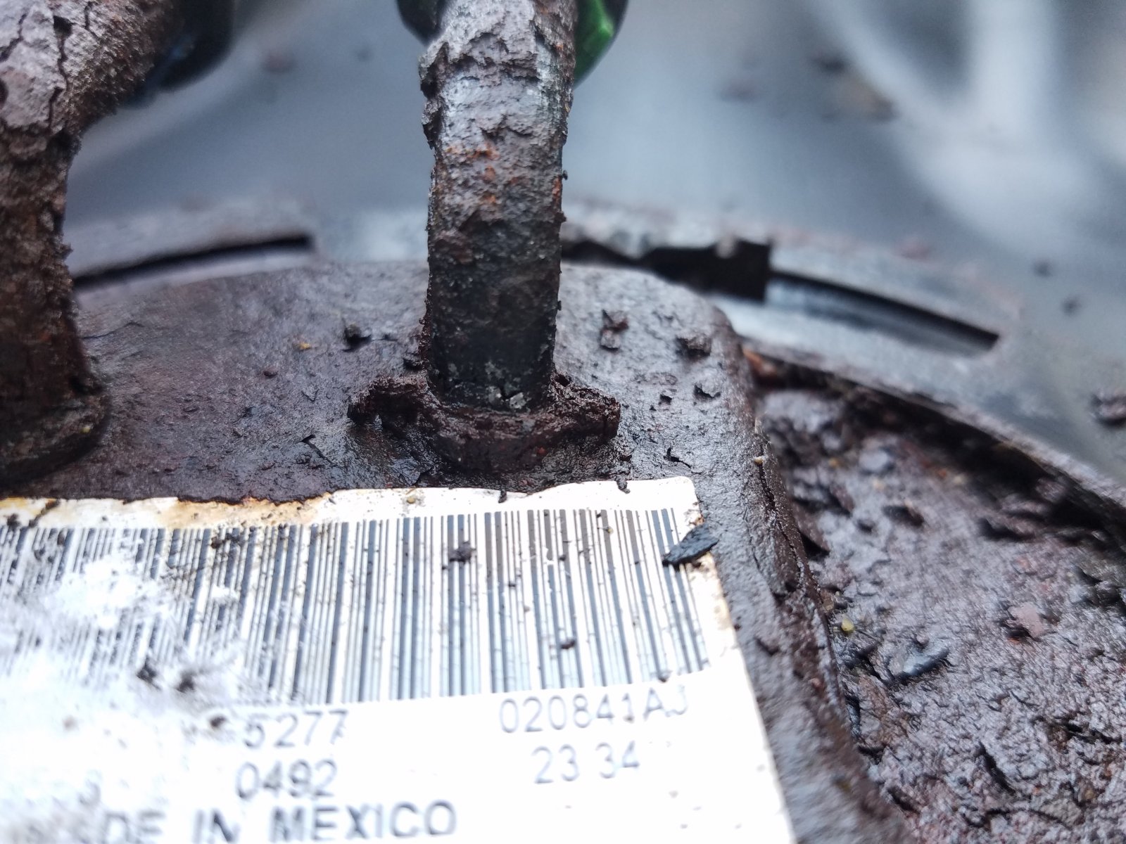

Well I crawled under the car and saw fuel dripping all under the gas tank... no need to even look on top. I guess it's just a coincidence that this happens when I change the sparkplugs...
Yup. Mine did that, too. One of the lines on the pump head is probably rusted through with a little leak. Changed my pump. All good.

Lol. I wish. Fixed. Pic for good measure....

Kinda crazy that the label outlasts the metal.
Yup. I coated the new one in bedliner before I installed it.

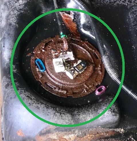

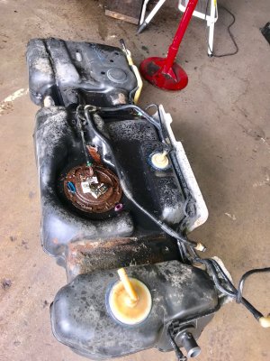

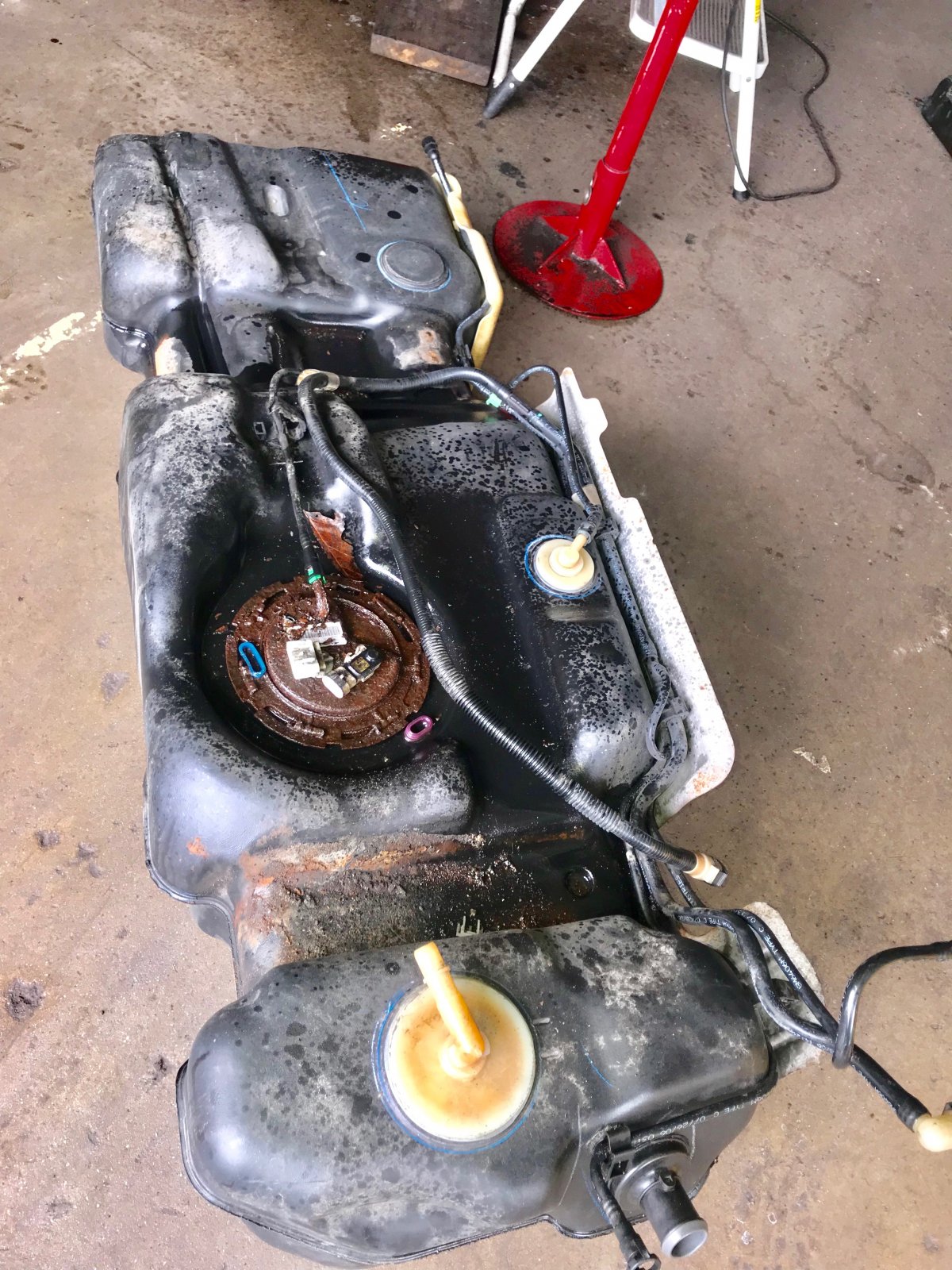

I had a bad fuel smell but no leaks at all, even had it up on a lift looking for a leak with another mechanic. I finally stuck my cell phone above the tank to get pics and I saw the rusted pump lines and fuel. But wasn't leaking enough to run down the side of the tank. These tanks have a sump built in around the top of the tank in that area so it can't drain well. IMHO that is what helps these to rust out in the first place, take a look:

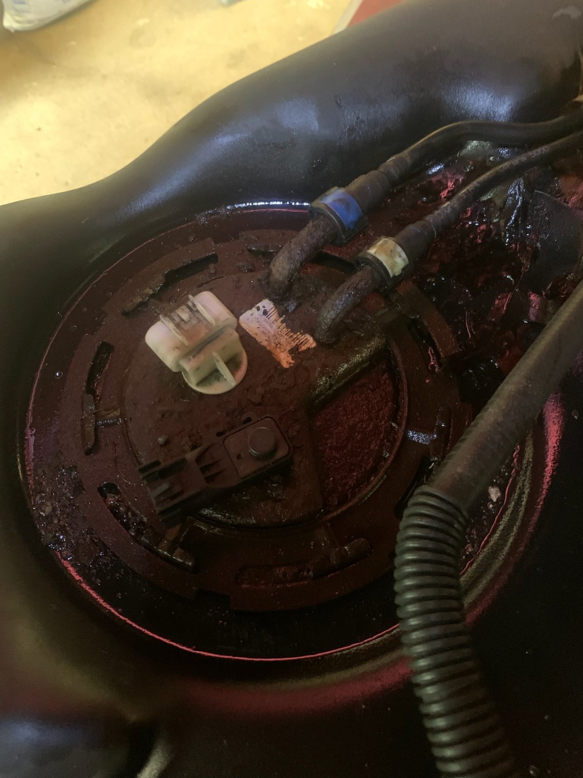

Here is a pic of mine. Not as bad as above but still leaking fuel.
There ya go!!!! That's a flex fuel pump. Were you able to get the lines off? Mine were frozen and would not.

Ha ha. I didn't do it. Too busy with working 16 hour days. The guy that did it told me he did have problems removing the lines though.

How do you know its a flex fuel? It is, just wondering. Got a Delphi replacement with a new gm ring.
The flex fuel has 2 lines and the non-flex has one. I learned this trying to find the right pump for mine last winter.
