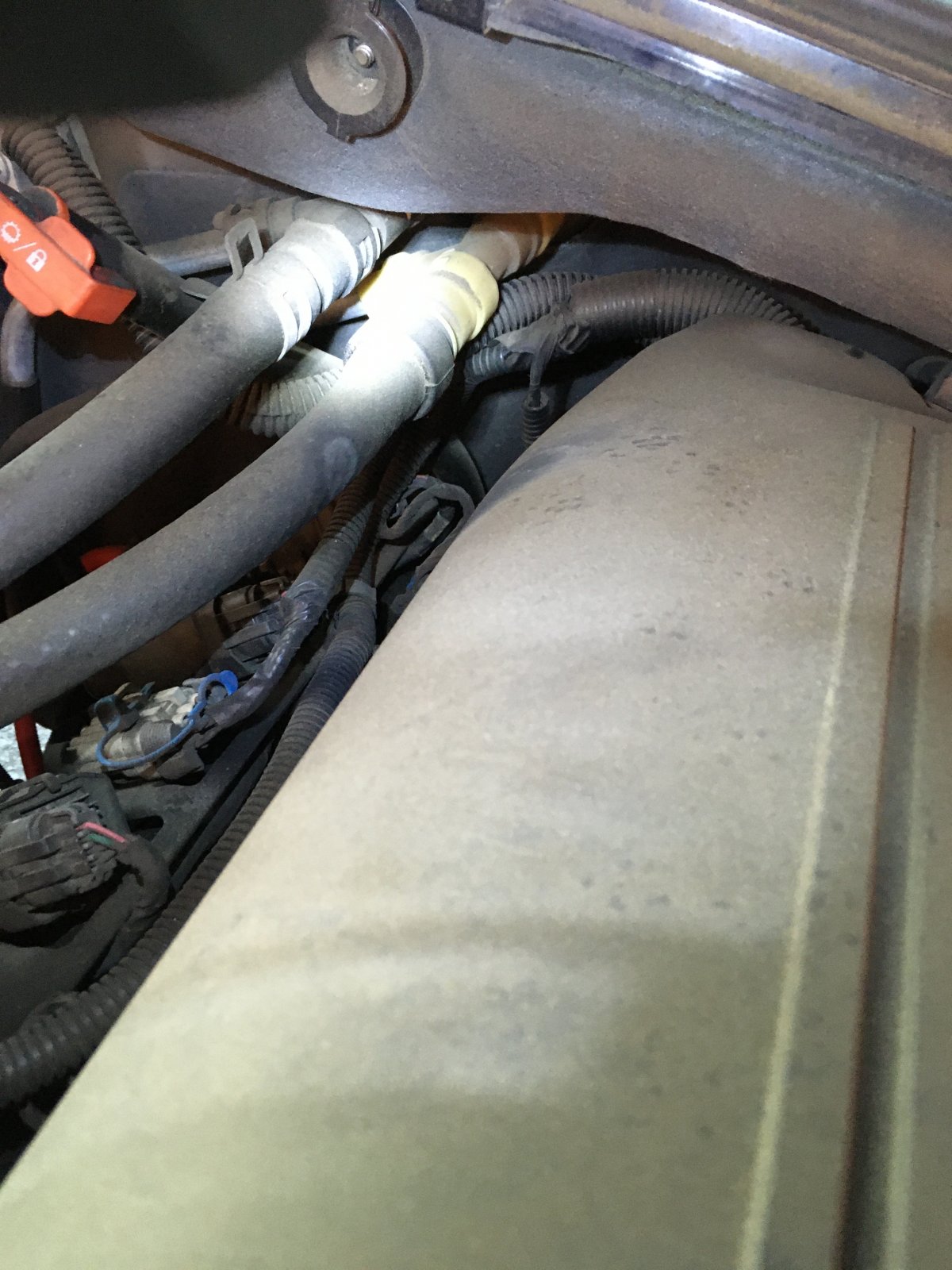

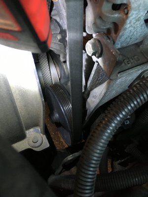

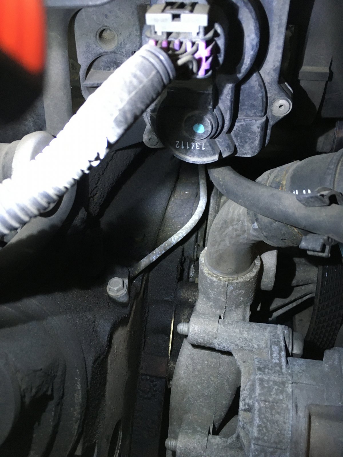

F1580CAC-B17E-4CA5-B8B5-9E80526534AE.jpeg C38731E2-A25F-4217-8C89-8488167E0E5A.jpeg E38886B5-91DE-4FE9-B9E1-7C8876C1FF66.jpeg F6291F11-ED2D-4E5C-822A-DE8B26ECB6AF.jpeg F3EA1155-A80C-4B11-9FF3-E273ADF63410.jpeg i took a few pics. water pump area looks dry, as does the heater hose connections and major hoses.

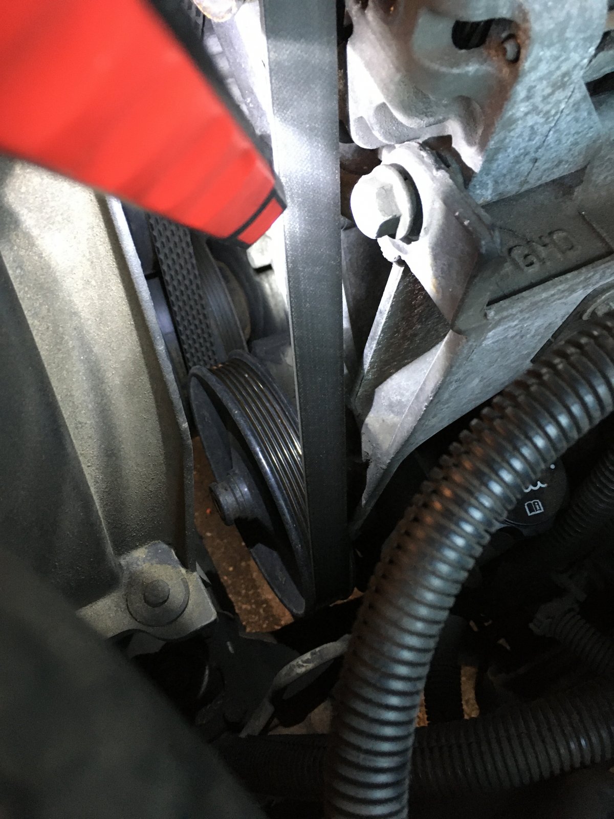

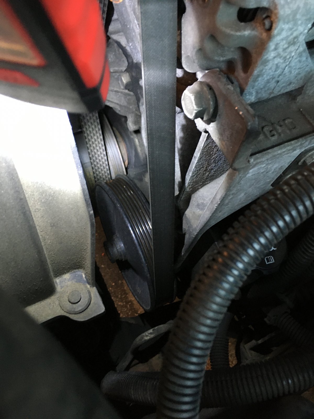

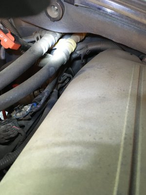

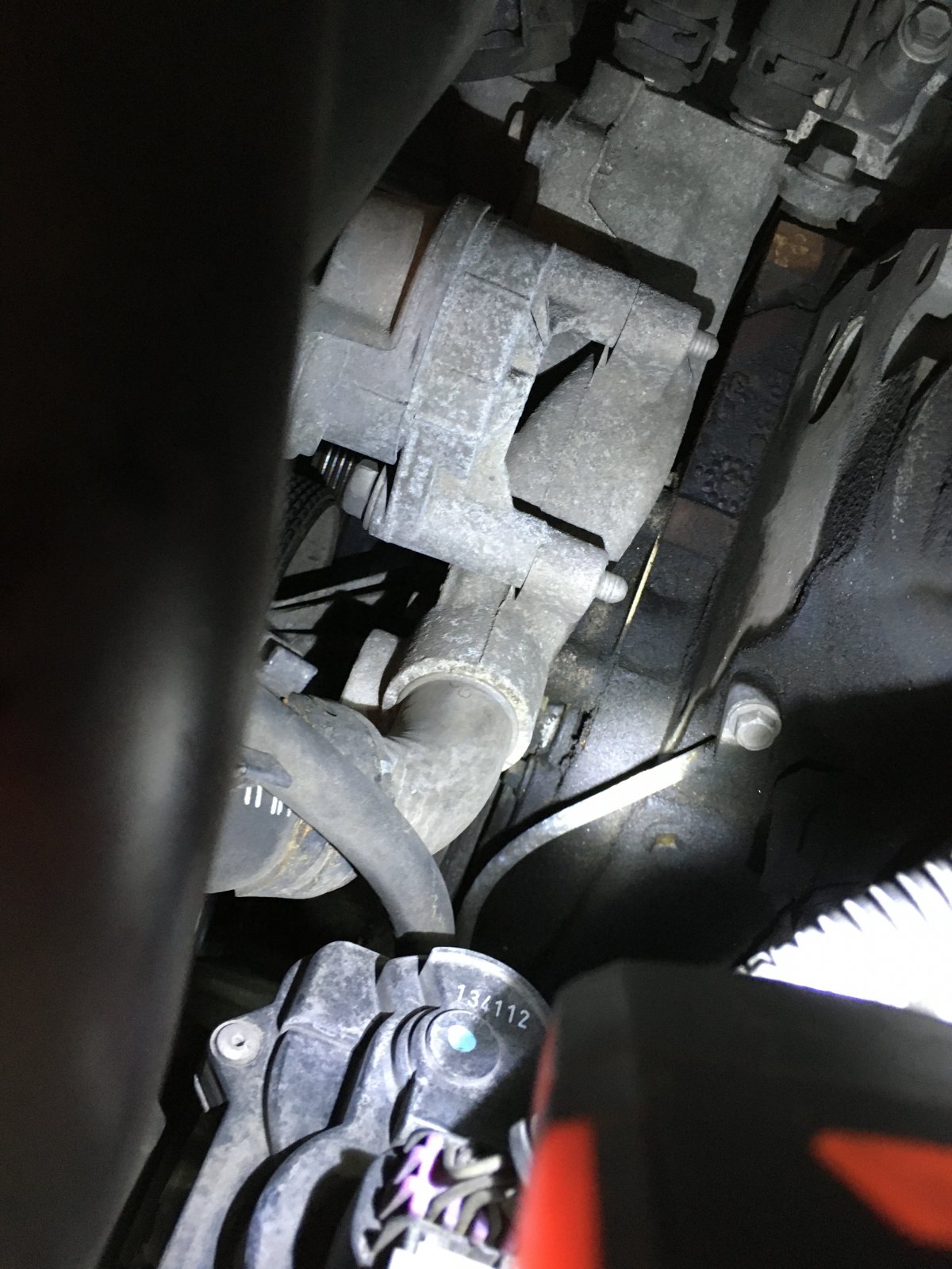

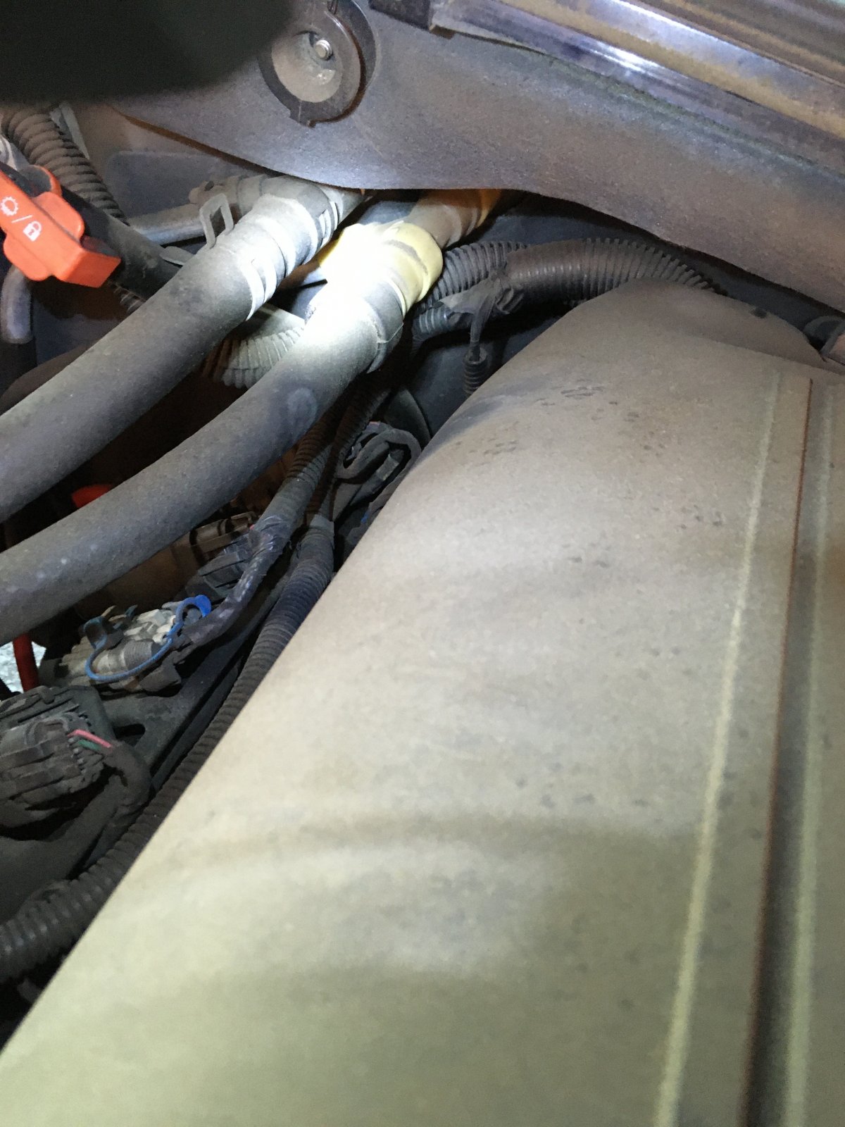

it does appear to be all damp on top of the engine though.
i know all you guys want me to pressurize the system and it doesn’t escape me that it would be proper course of action. i’ve done every bit of service, maint & repairs on all 3 vehicles we’ve had in the past 4-years.
i’ve never actually had to use a pressurizer even with all the diagnosing of coolant-loss related issues. i’m just not familiar with the system and serviceable parts on this GM truck. the top end looks like a cluster f*ck of crowded mess.
back when i had access to the Chiltons Online i could track down anything given the thoroughness of the data including diagnosis. OTH this little Haynes repair guide for 99-06 just glosses over the big stuff in chapter 3 ‘cooling & hvac’ - it’s pathetic
30,763
48,456
View attachment 238307 View attachment 238308 View attachment 238309 View attachment 238310 View attachment 238311 i took a few pics. water pump area looks dry, as does the heater hose connections and major hoses.
you need to look under the truck and under the water pump, fluid will travel down not up

Hot coolant will evaporate pretty quick if it is a very small leak. Remember, the hottest the engine is will be when you shut it off and then it does what is called a "hot soak". If the coolant is low in the upper end of he engine it will just seep steam out. Low places like the water pump can leak one minute and stop the next. You need a pretty good leak to make a puddle to see. If is just a very small drip you may never see it because it hits on components below it and never hits the ground. Like Wes said, look under the vehicle as well and look for the corrosive stain at the weep hole on bottom of pump and any low areas that contain coolant when it is moving around inside the cooling system. It could be something like a seam leak at the radiator. I sure would like to see a pic of this wet top of engine.
If in fact it is coolant that is the wet spot on top then you have other items holding coolant up there or an intake leak that pools at the top or even leaking down the back of the engine. remember, the lines under the vehicle if you have rear heat.
30,763
48,456
that's exactly where the o'ladys suburban is leaking, the bottom of the water pump, it's coming out of the front bearing seal (I think), looses about 1/2 gallon every 2-weeks, just been too lazy to fix it yet, lol, you can barely see a few droplets flowing under the very bottom of the pump doesn't leak on the ground

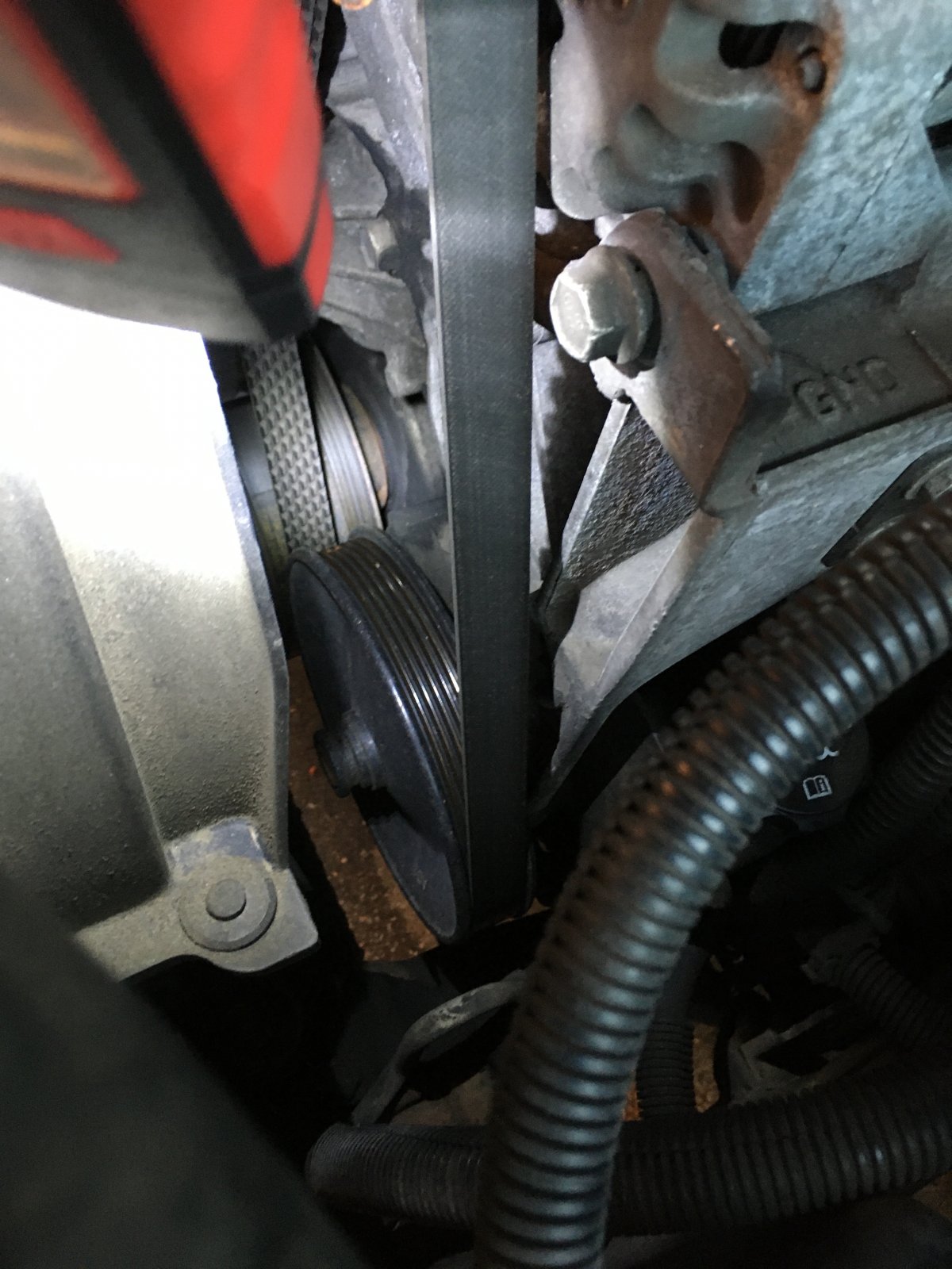

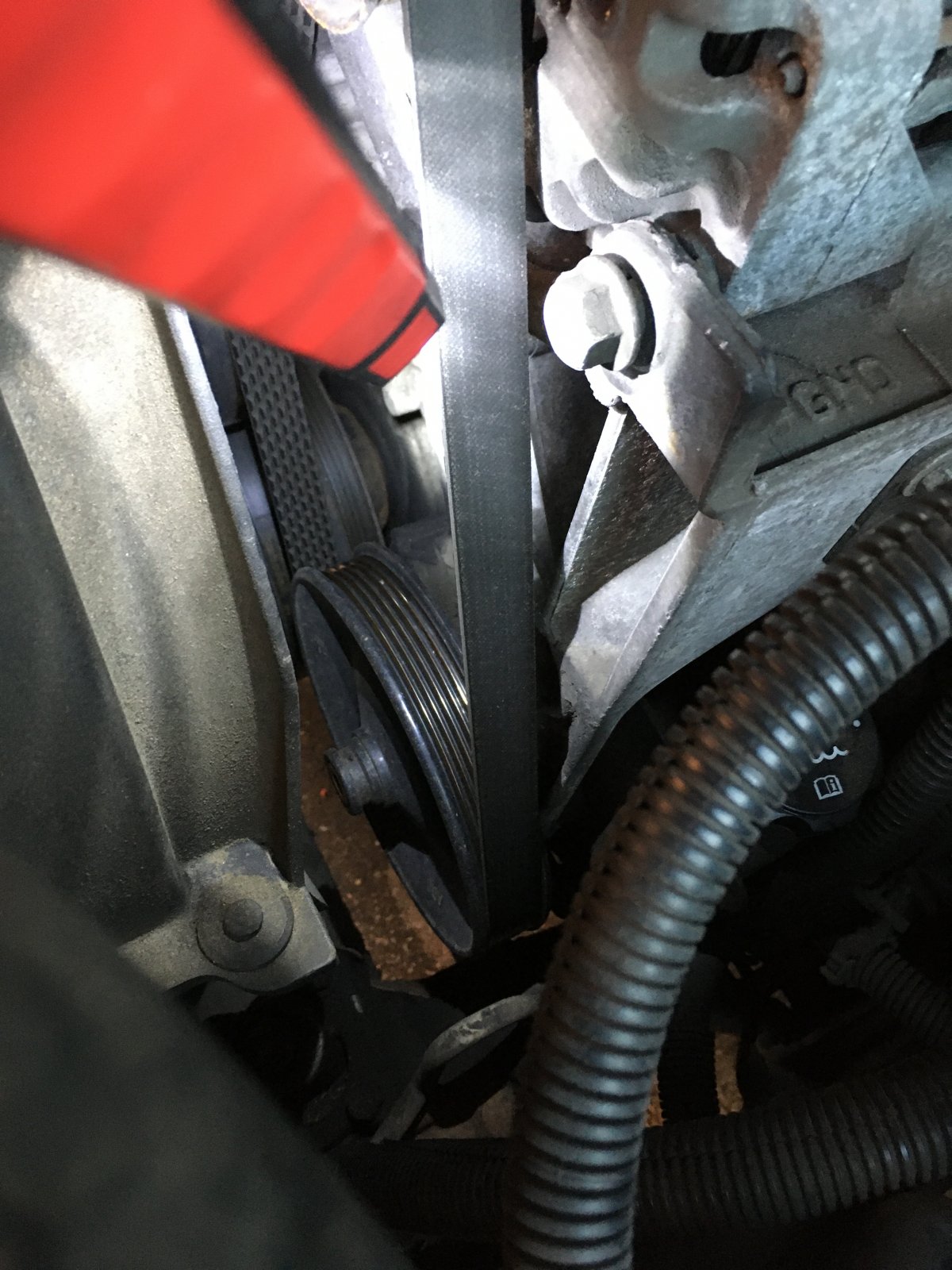

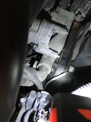

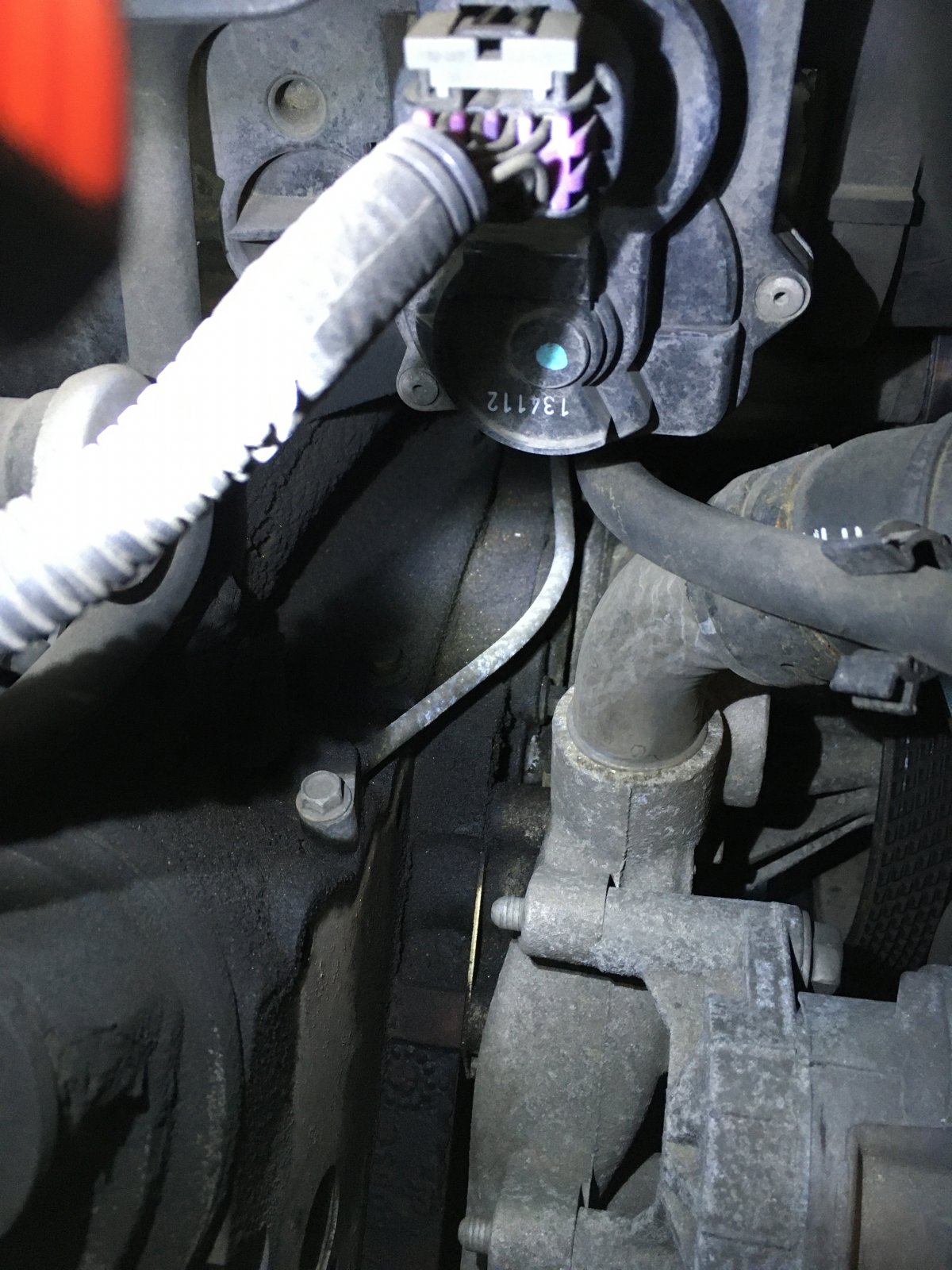

here in dallas, the air temp changes 40-50 degrees. it was 70 deg on Fri and snowing Sat morning. whenever this happens, something leaks on at least 1 of our vehicles. the major temp swings are ******* seals with 200k miles and/or a good 15-years on them.
her 2008 the belt was squeaking on super cold mornings. i correlated that with a weeping water pump. it leaked when the temp changed so much so i went & replaced that even though the bearing was still tight. hated to do it only bc of the PIA coolant refill & air pockets that gave me hell.
i will remove the plastic guard and get a better look at the WP tomw if it warms up some. i’ve been under there 2-3 times looking for the leak. it’s all wet on the oil pan but i think it was dry up at the front.
FYI the oil pan was bone dry up until 2 weeks ago but both oil & coolant loss had occurred. i’ve never had to add oil bw changes and the coolant i’ve topped off with about 1/2 cup distilled water 2x in 1.5 years and neither was recent. it hasn’t lost any oil at all since i added 2 weeks ago (i checked yesterday) but i’m @ 5% on engine oil life and replacing it this week. i will be sure to check the level before i drain it to see if anything leaked after this cold front today.
will update tmw of anything found on further inspection. somebody asked about pics. pics are posted above in my last post

The highest point on the front of the engine that would have coolant is the throttle body. Check the small hoses going to each side of it. Next highest would be the coolant crossover ("steam vent") tubes. Pop off the intake duct so you can see and check these items.
the info i was waiting for. thank you sir!
