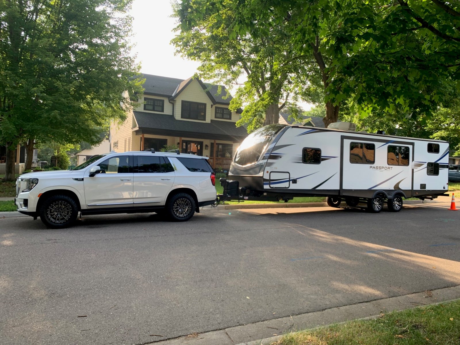

1.) We have a Passport GT 2951BH that is about 100lbs under your estimated dry weight. The trailer is 34' tip to tail so it is longer. Admittedly we do not travel with it much but I have hauled it a few times and it handles great on the highway but I'm not going over 65mph typically. It is definitely on the high end of the spectrum of what these trucks should be hauling. Your longer wheel base will help with sway. I am pulling mine with a 2022 Yukon Denali with Max Tow and Air ride, similar to your setup.
2.) Don't short change on the hitch. We have an Equilizer as well, it works great.
3.) Make sure the truck is off and settled before setting up the hitch with the trailer. Once it is settled into standard parked height (not the lowest easy entry height, just standard height) open one of your passenger doors so it doesn't start leveling the truck as you hitch up the trailer. You want air ride disabled during the hitch setup. You can also pull the fuse, I opted to do the former. Once you have everything setup properly on the hitch the truck will do it's thing and level off accordingly. There are tutorials online that you can follow that deal with setting up a vehicle with air ride.
4.) I like to set the gain by coasting the entire rig under 5mph and ease into the brake gain until completely closed. Once the trailer tires start to drag back off the gain by .5 so they don't drag when fully locked up. Better if done on a gravel road.
