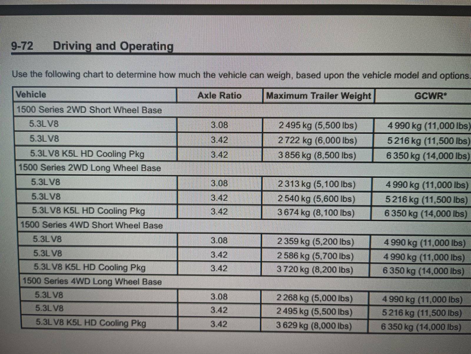

8500 lbs for a short wheelbase 2wd SUV?!
That's kinda optimistic, no?
