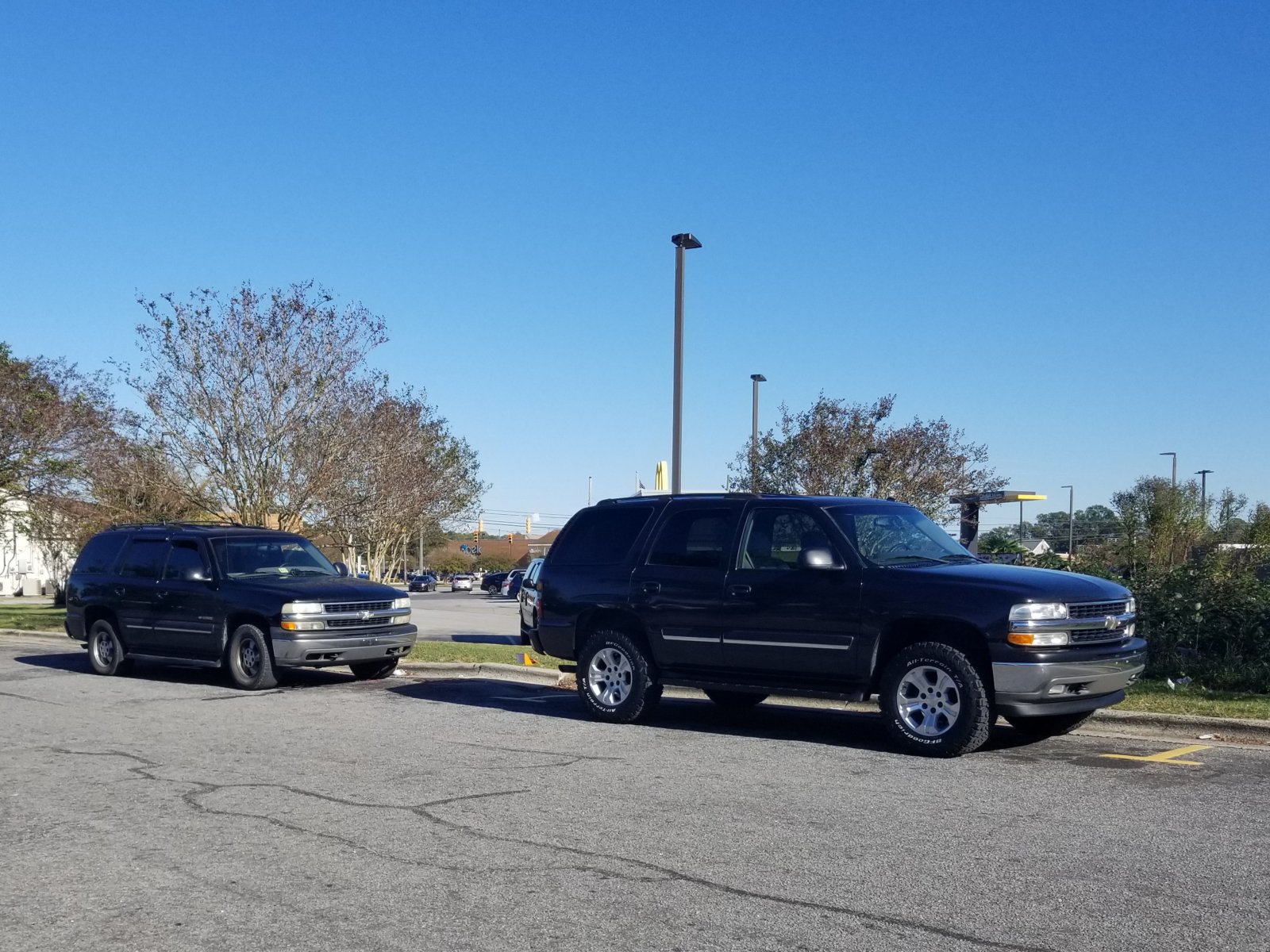

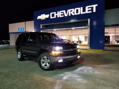

I have an 05 with z71 rear springs and 1-3" keys on 275/70r18 BFG KO2s
