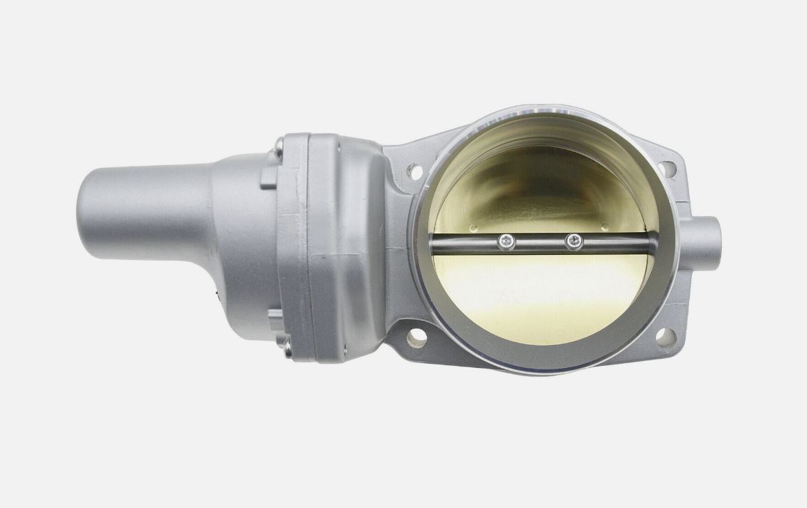

What throttle body did you replace the factory one with?

Like you really needed anything from an ls7:) ;)
I like the ls7 throttle body it's a all aluminum design and obviously better quality than what they throw on the SUV's so it was a no brainer
$150 well spent. Did not require any tune or calibration, plug-n-play. I do have a cai installed so it is possible a stock intake housing may not fit.
it's been several years if someone wanted to retain the stock intake housing you would need to do some research the ls7 tb sticks out on one side a bit
Hmmmay have to that route especially for 150 smackers. I can figure the intake out that should be easy.
Thanks
prices seem to have gone down on them a little bit, but I bought mine new, in the hitachi box, Hitachi makes them for GM.
pretty sure I bought the 90mm the 6.2l intake I believe is 88mm (outside, circumference), the rear mating surface is the same size.
there are like 107mm one's out there so just be sure to get the right size, generally the larger size are more like $250.
Gotcha man, Thanks I appreciate the info

I tried a Hitachi throttle body but it went bad after a few months. So I went back to OEM and no problems. Also, I had air leaks where the pcv hose hooks to the rear of the valve cover and the fuel regulator rubber boots/hose. Like someone said, check the fuel trims with a scanner that shows live data.
