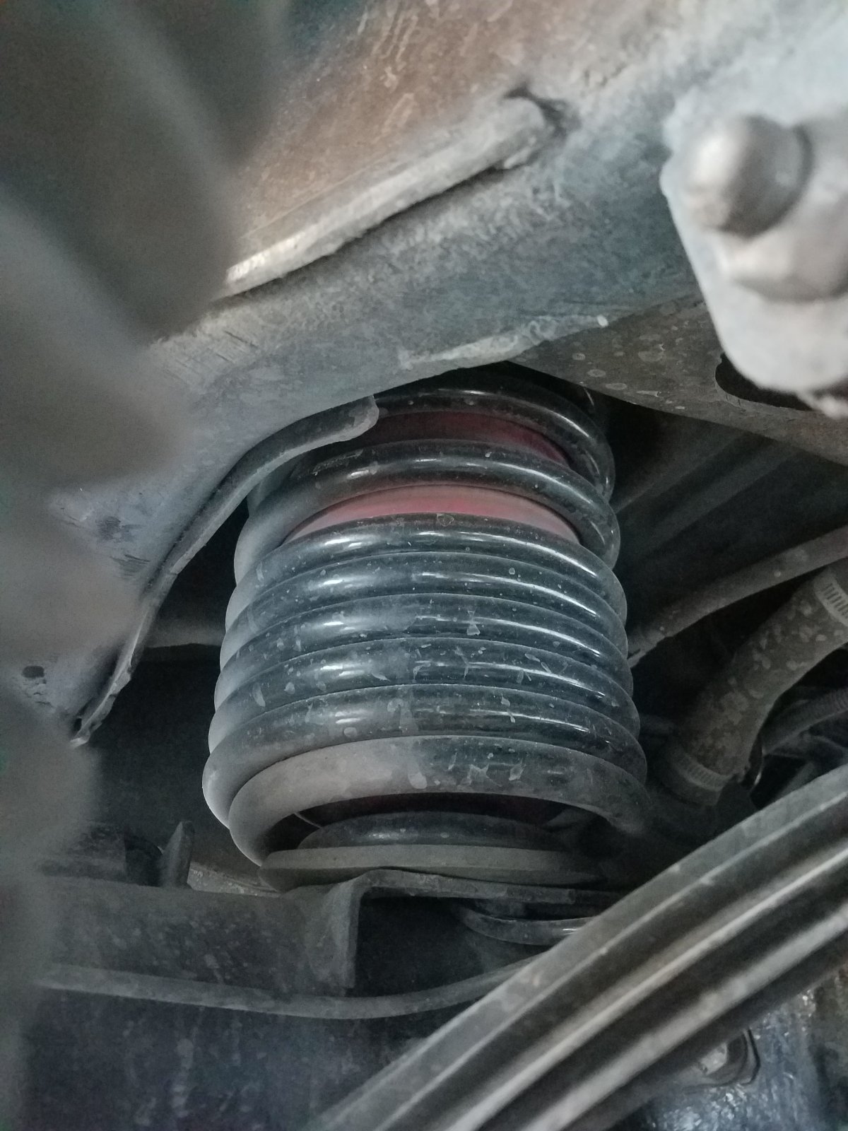

I can't imagine a spring is supposed to be near full compression like this at ride height. Although I suppose with only 4.5" of up travel remaining there isn't a need for much more spring compression. Either way seems wrong, anybody care to post pics of their rear springs at ride height?
@iamdub @Rocket Man
That does not even look right. My coils do not touch like that

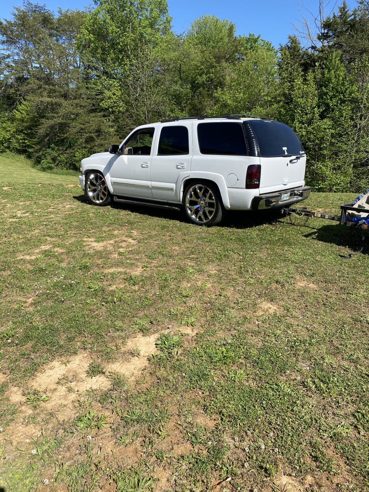

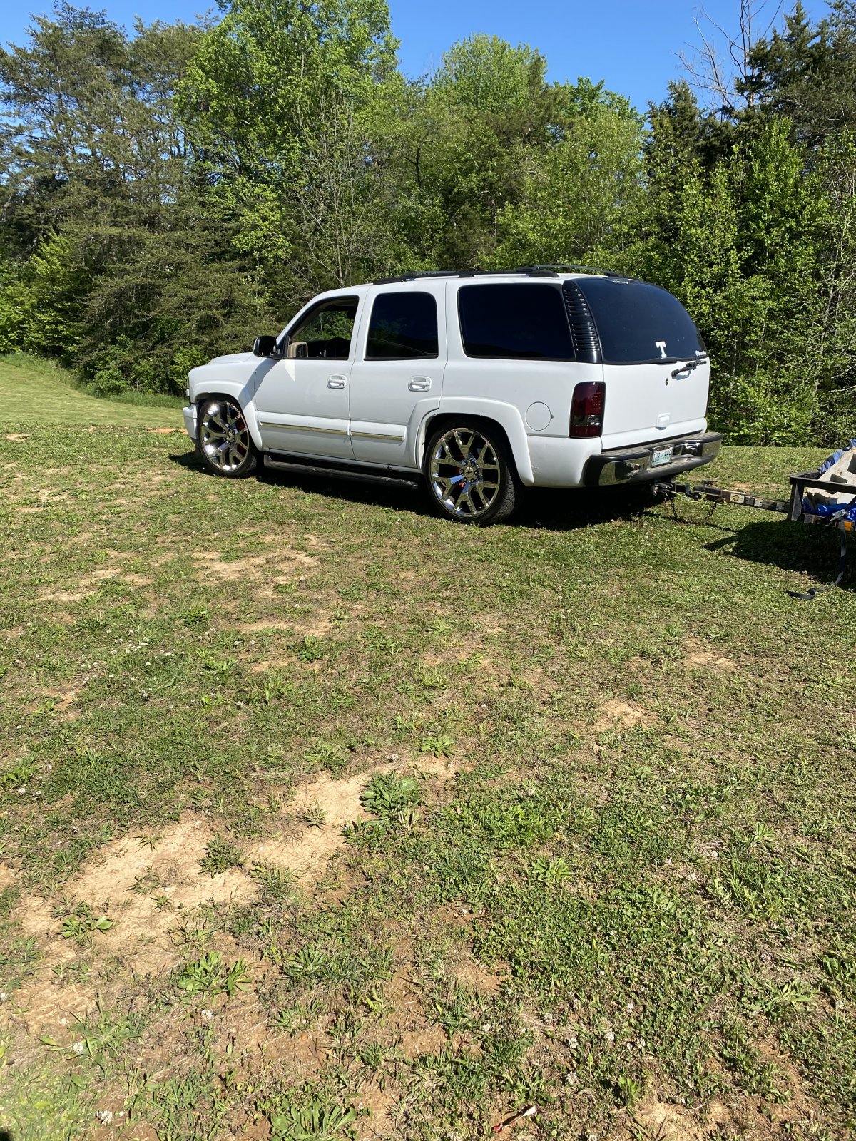

We’ll I have had crown, mcgaughys, and belltech all in my 04. I am now running 4230 belltech coil for a trailblazer with 2 coils cut out. Free travel mod as well. But I also have 60748 helper bags. Those made a big difference for just 100 bucks. I don’t keep any air in them unless I tow. I hve also had numerous sets of shocks. Belltech sp and they sucked in my opinion. Everyone has different preferences. I now have the bilstein 4600. View attachment 279055 View attachment 279056

They are long. Unlike the belltech but u see how low my Tahoe is an they ride great. They have a lot of travel when u fully compress them. I also have extenders.
