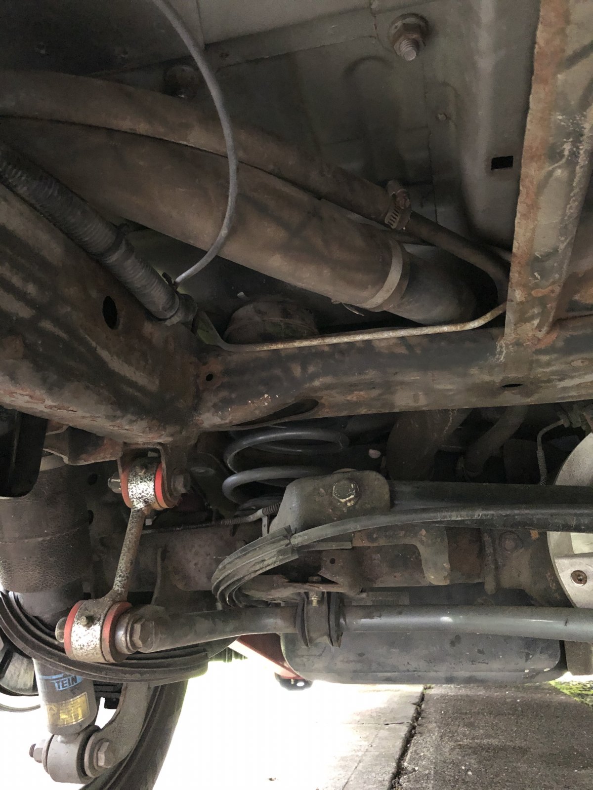

I can't imagine a spring is supposed to be near full compression like this at ride height. Although I suppose with only 4.5" of up travel remaining there isn't a need for much more spring compression. Either way seems wrong, anybody care to post pics of their rear springs at ride height?
@iamdub @Rocket Man

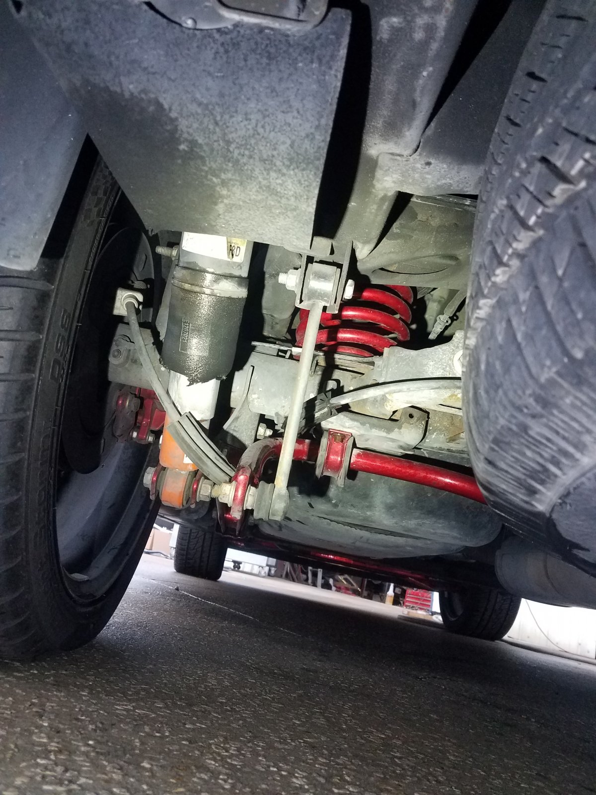

@iamdub @Rocket Man
That’s fu**ed up. Something is wrong there. No wonder your back is feeling the bumps. Here’s my Belltech 2” lowering springs just now with the truck on the ground. I’m running Bilstein Autoride shocks I bought from Arnott back when they were available. It’s a pretty decent ride considering.

That’s fu**ed up. Something is wrong there. No wonder your back is feeling the bumps. Here’s my Belltech 2” lowering springs just now with the truck on the ground. I’m running Bilstein Autoride shocks I bought from Arnott back when they were available. It’s a pretty decent ride considering. View attachment 268832
Yeah, something is screwy with these Eibach, that's what I assumed it should look like lol. If the shocks don't fix it then those Belltechs look like a good option.
Thank you for the pic!

You’re welcome. It’s not easy for an old dude like me to get under there but I figured it was worth it. ;)

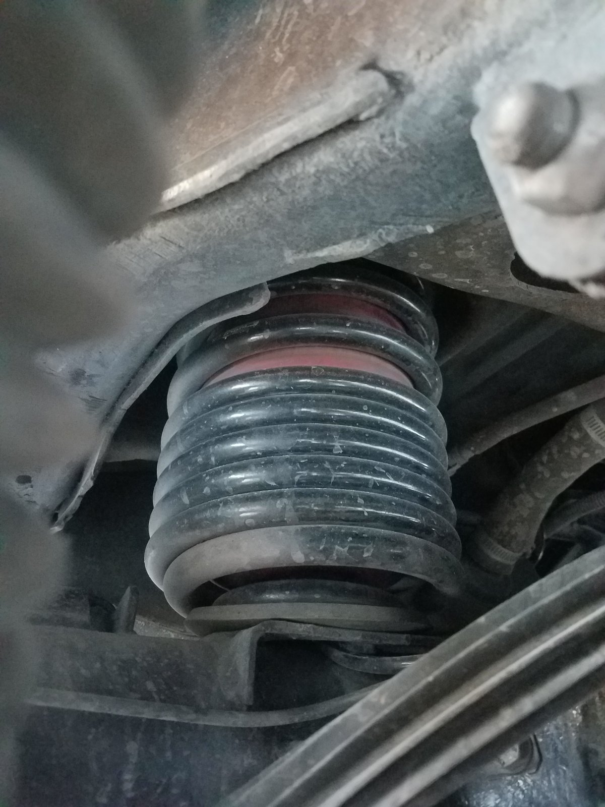

I forgot to mention both sets of Belltechs are variable rate springs so a few coils are almost fully compressed, with more space between other coils. That premium design gives a stronger spring rate as the spring compresses, affording a better ride.
