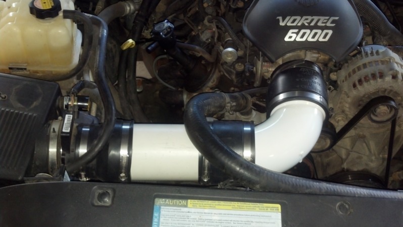

Just wanted to throw this out there. My truck has a 6.0, BB tune, headers and ORY, muffler in place of stock, modded stock intake, 3.73s with heavy 24s. Ive been running a stock intake with the bottom silencer cut out and sealed, with the bottom of the air box cut out. Muffler was a worn out 14" magnaflow. I just finally did the 4" pvc intake and i swapped the 14" for a new 18" magnaflow. I made the same trip last week. 170 miles to school and 170 back. They way up I got 17.9 and the way there i got 17.8. This was cruise set at 72, 95% interstate and 5% city. Gas station to gas station. I just got this stuff done yesterday and made the trip back home. Same gas stations. Got 19.7 mpg. 170 miles and 8.6 gallons. So i picked up 1.8 mpg with the intake and new muffler. It sounds crazy, but I can notice the power difference. Maybe because I was tuned for an intake, but only had the stock one. not sure. Just wanted to throw it out there. I know SamCarrol picked up 2-3 with his intake, so it was well worth the 18 bucks I spent.
I should say its not doable if you still have a clutch fan since the elbow would be in the fan.
I have been making this trip for the last 4 years and never got better than 18.2, so ive put some time into checking it.
Didnt have an elbow that would fit a 4" pvc, so I just used another 4-4 adapter and it worked great. Gonna paint it black tomorrow.
4-4 adapter on the TB to 4" elbow, 4-4 from elbow to 4" pvc. 4-3 adapter to the MAF.
If you notice, its offset to the left a bit. Had to do this to clear the pulley to the bottom right. If I would have gone with 3" everything, it wouldnt have been a problem. Not sure if that would make a difference or not.

hell ya..took all of 10 minutes to make..took me longer to go to the store to get the stuff..throttle response is much better as well

Another option would be exhaust tubing cut to fit. 4" will be a thin wall 18g. To help eliminate heat soak, wrap it in exhaust wrap( it looks cool too).

Looks good. Will look much better when you paint it though. I need to do the same thing on my Silvy once I get E-Fan's installed.

Ya i never took it off to paint it lol..i picked up some mpg in the city as well..hard to believe..I must have had a leak before in my cut stock tube and it was messing with my shit, but my scan tune never picked it up..
i will say, the 18" magnaflow is soooo much louder than the 14" magnaflow I had on there..if im super easy on it, its quiet, but when i lay into it, its much louder...weird

i was scared to see this but i must say very clean man looks great and professional
