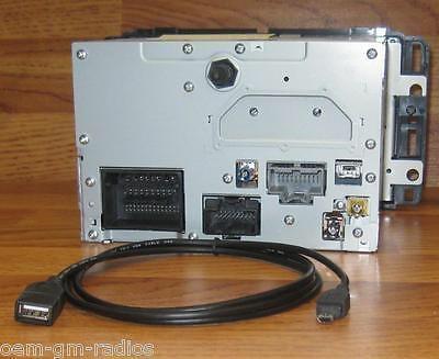

FYI, the mini USB cord (at the back of the unit) for these hard drive units has a different shaped profile than the standard cord. Make sure you purchase the one specifically made/sold for this head unit.

I need some sources for this cable now. Just a part number would be great...

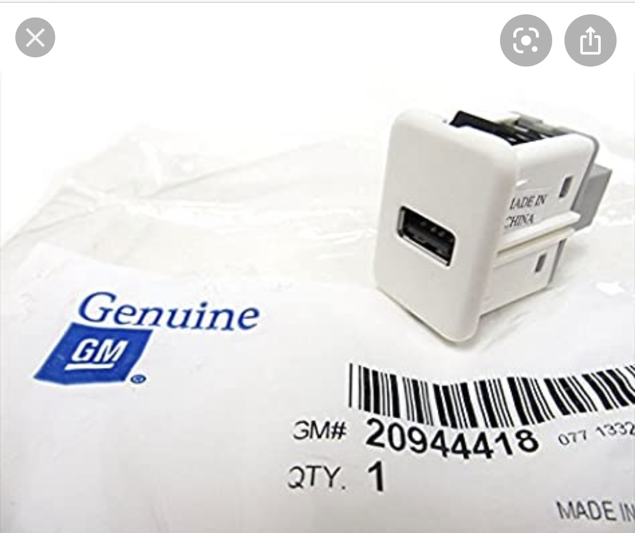

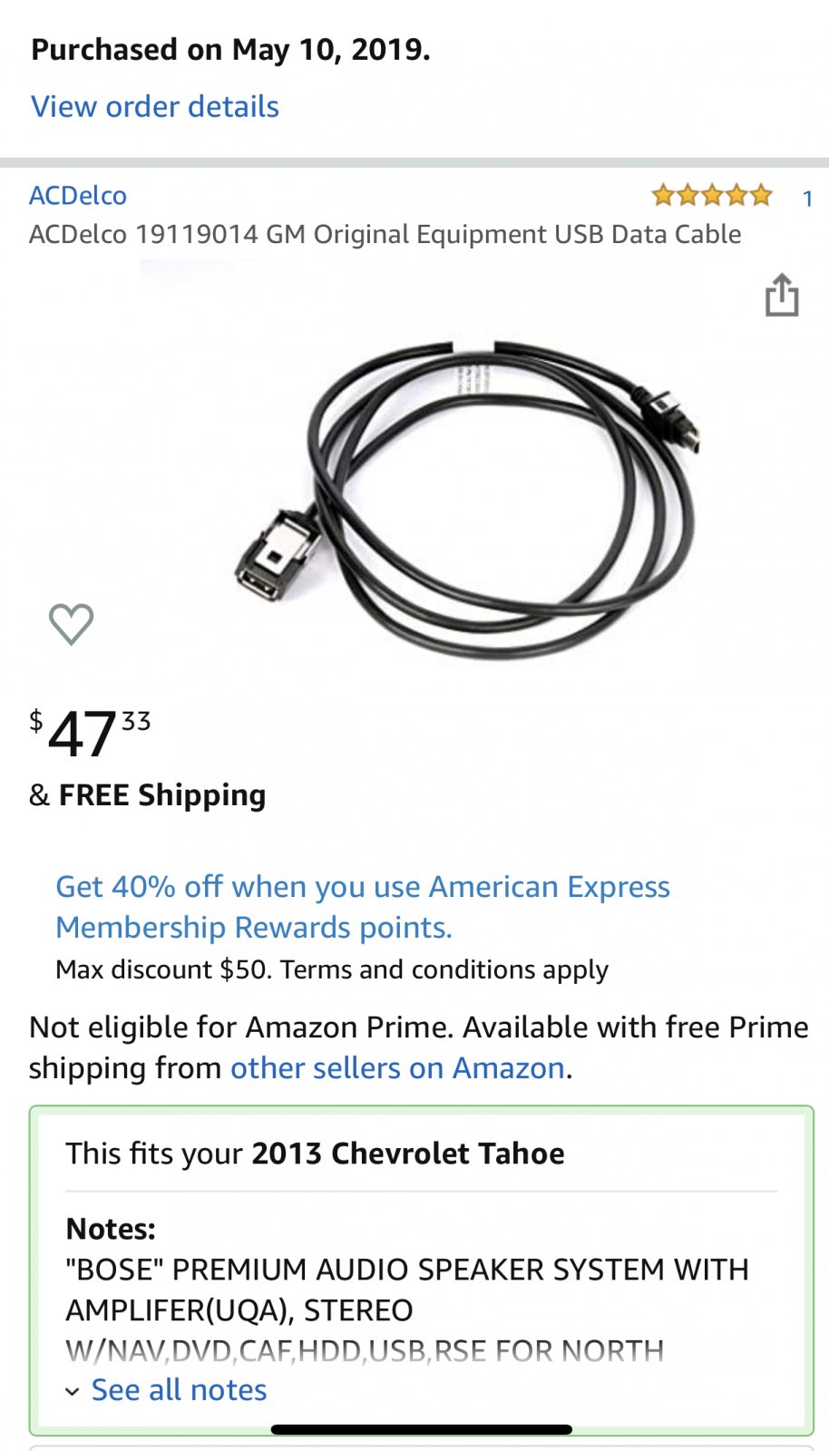

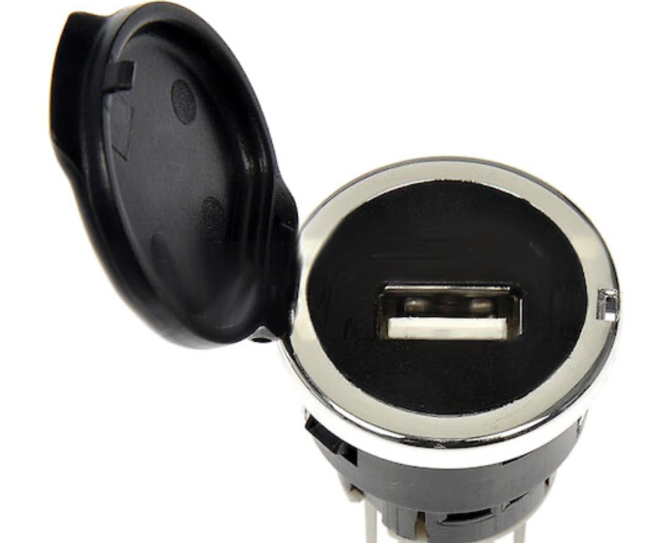

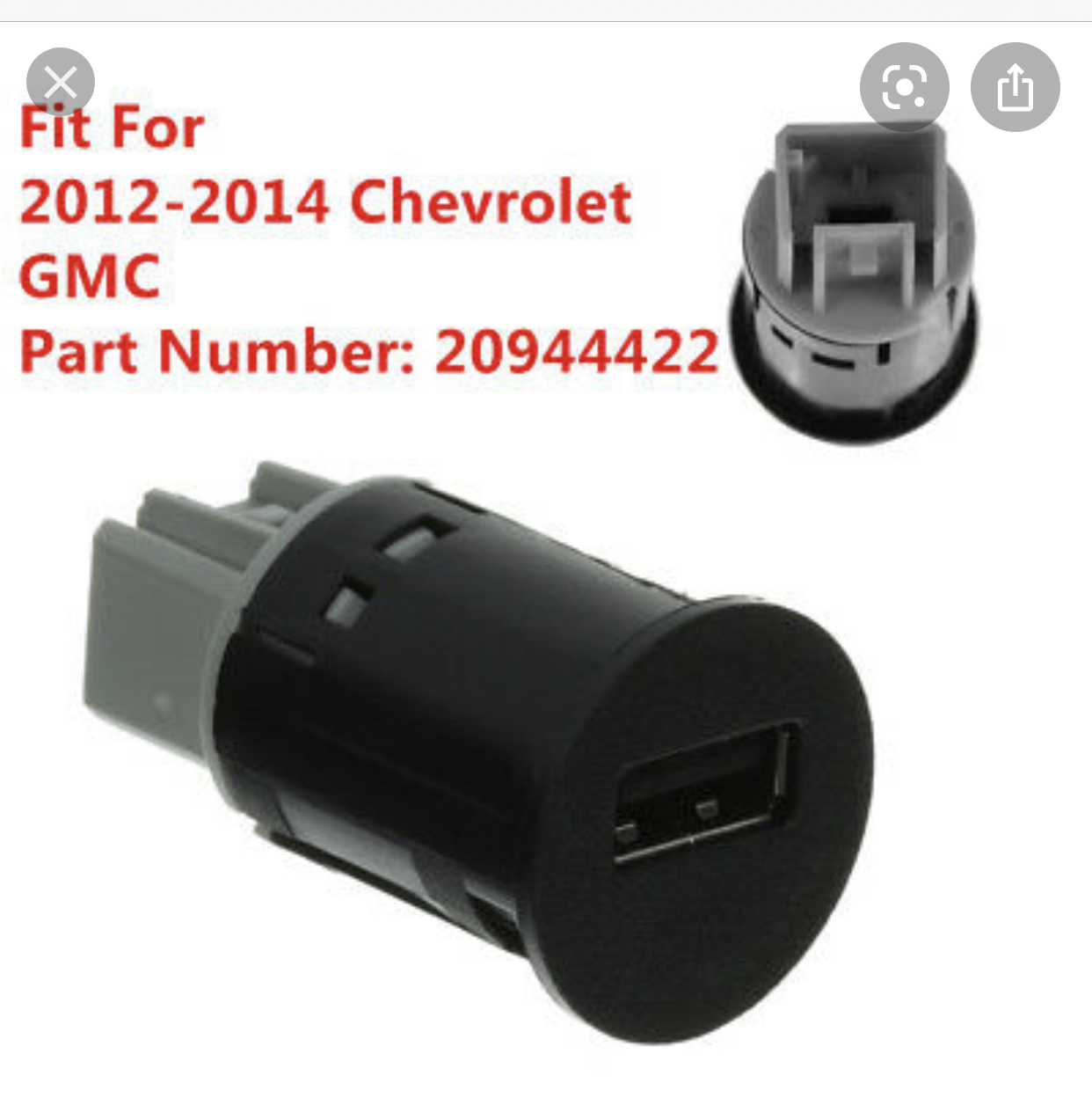

This is the one I bought, to plug into radio with some stupid wire clip on the end to fit radio. On my 13 it goes under console to console box. It meets up to another cable/usb connection under cup holder and continues to white usb ‘outlet‘ in console box.
I have this which is factory set up..
but you can use anything like this
