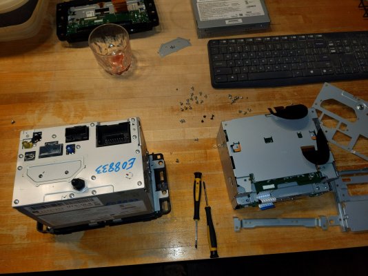

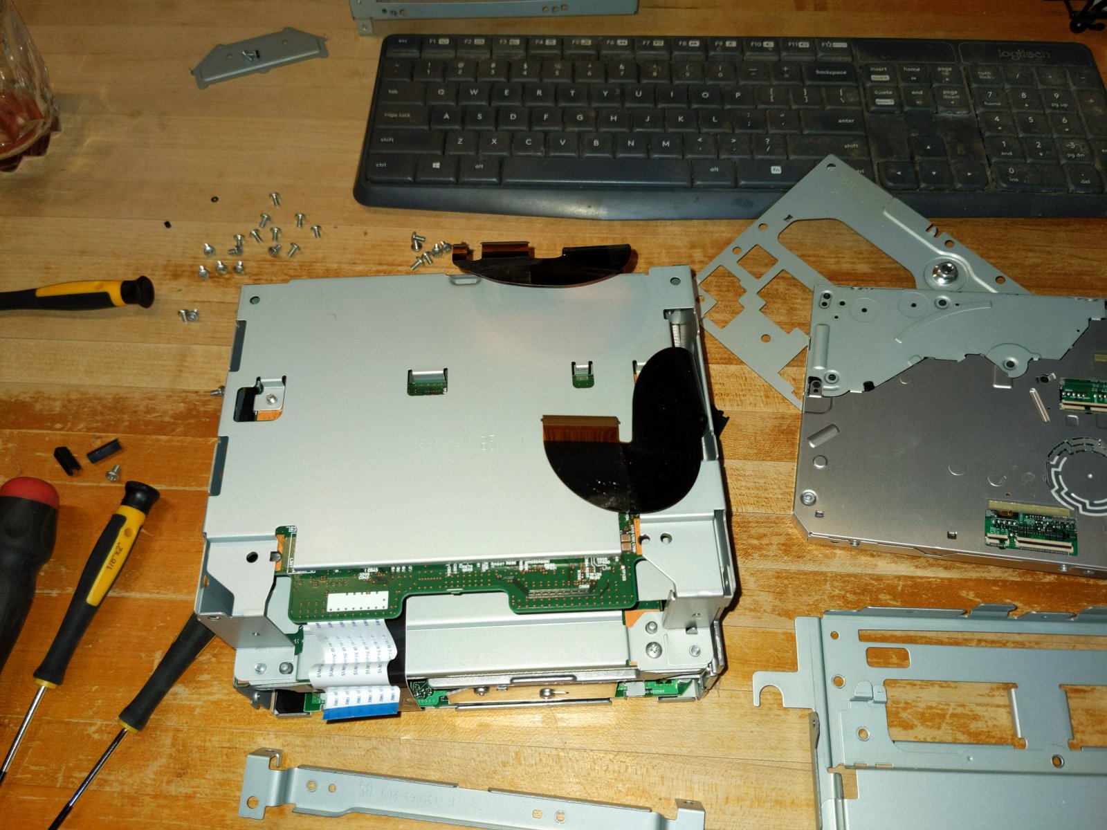

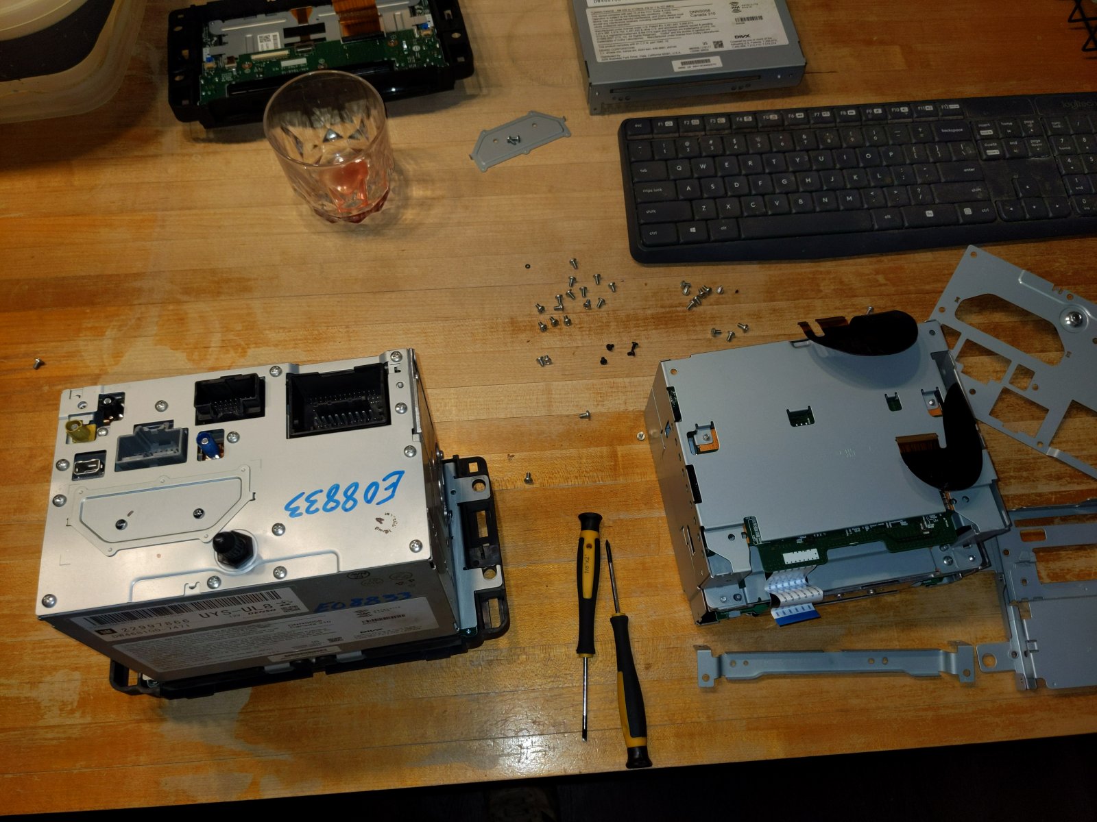

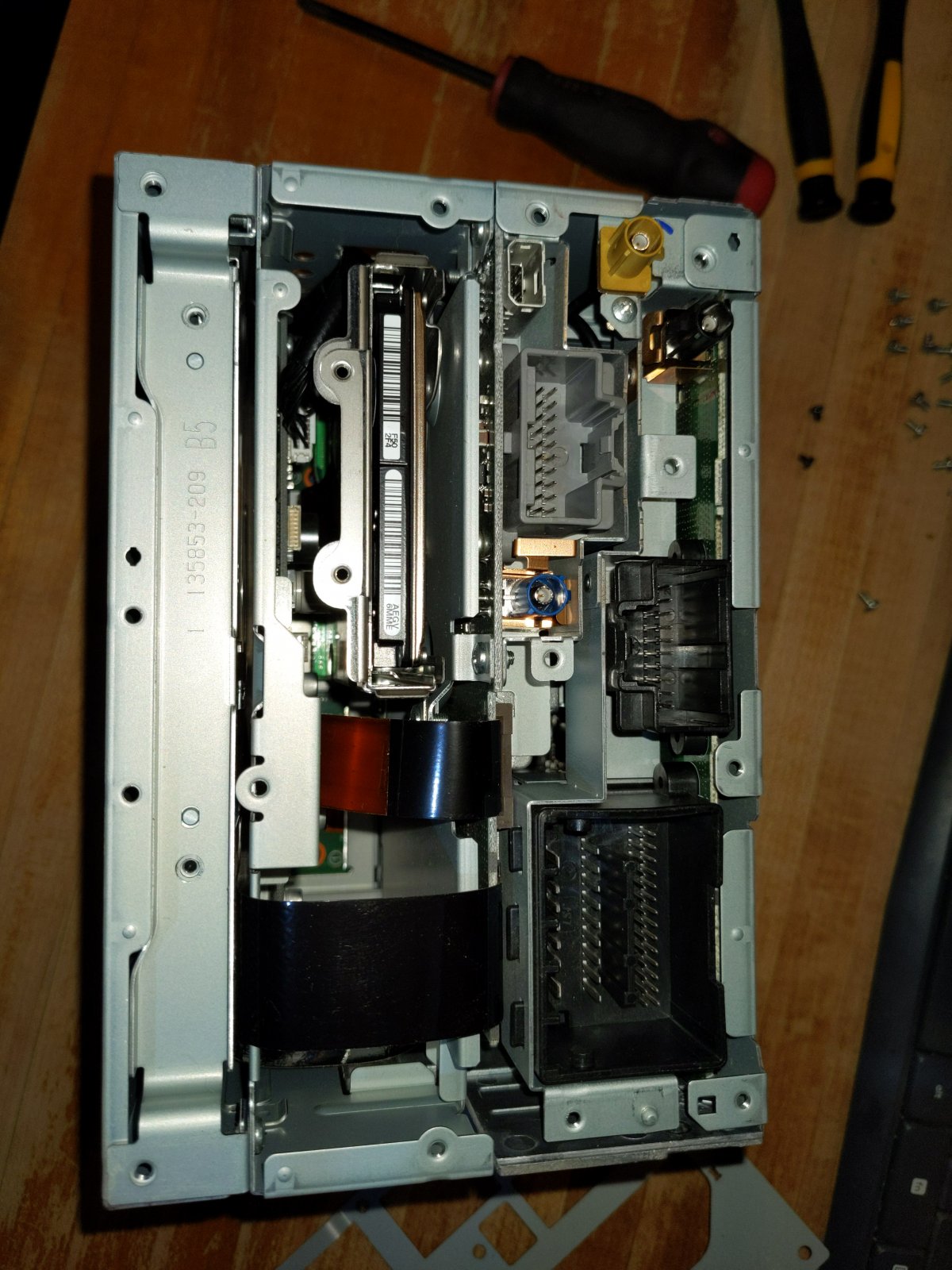

Here's a couple of shots what these things look like inside, they're very modular. It looks like the hard drive could physically be swapped or maybe even upgraded; it would be interesting to take it out and see what it is and how it's formatted. I wonder whether the rest of the 'radio' would recognize more storage capacity

As long ad the new HD is formatted identical to the existing card you’d be good until the processor couldn’t handle any more.
There’s another company that makes a one shot vin match that plugs into the ECU that will get you there..
