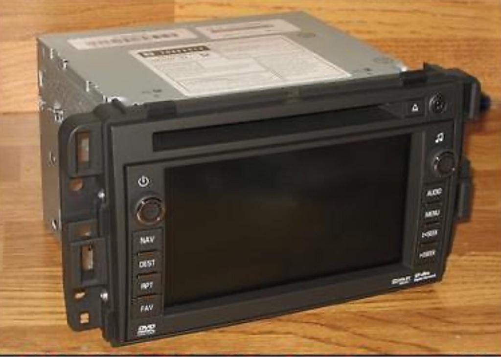

I did the factory upgrade from 07-10 Navi to 11-14 on our 09 ESV Platinum. It lacks the 6 disc changer and motorized tilting view screen. The technology it picks up by going from DVD to hard drive navigation is worth it w/ a better view screen, faster OS, easily upgradable SD card based Navi data.
The Denali version is a little different than the Escalade system by looks but way better than the early Non hard drive units. The XM Nav Traffic receiver can be added that show live accidents and traffic back ups. A one button push will show you what’s happening within a 10-15 mile radius of you.
It also verbally controls most of pandora/music/BT/USB/iPod devices. It’s reliable, upgradable tech that stays stealth in your truck. Most importantly will be covered by insurance as a “previously factory upgraded” part. If, in the unlikely event it’s pinched, proof of installation & operation is all that’s needed to make a claim.

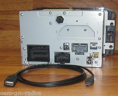

Something is not adding up. That link to a newer 2012-2014 HU shows the older 2007-2011 HU with the smaller plugs in the back, 15940102. I have that HU right now. Bought it off facebook marketplace last sunday. It came out of a 2007 Chevy Tahoe Z71.
The link for the harness looks JUST like the one I bought from OEM-Radios.com last week too. Same price, photo etc...
The newer hard drive radios have the big plug on the back. The two I have found is 22997866 DW468100-7471 and 23168280 DW468100-7500. Trying to get both of them. One for the wifey tahoe and the other for my DMax.

I left all the inaccurate info I posted last night intact. Watching tv, fireworks and posting links on a phone can definitely lead to errors lol...
I picked the most pricey HDD radio off eBay to show how sellers are gouging the price of these head units.
Thank you for pointing out the differences between the analog DVD based factory head units and the later SD card based Navi units. By the time GM got it right they changed the HU to easily swapped out modular units (CUE).
