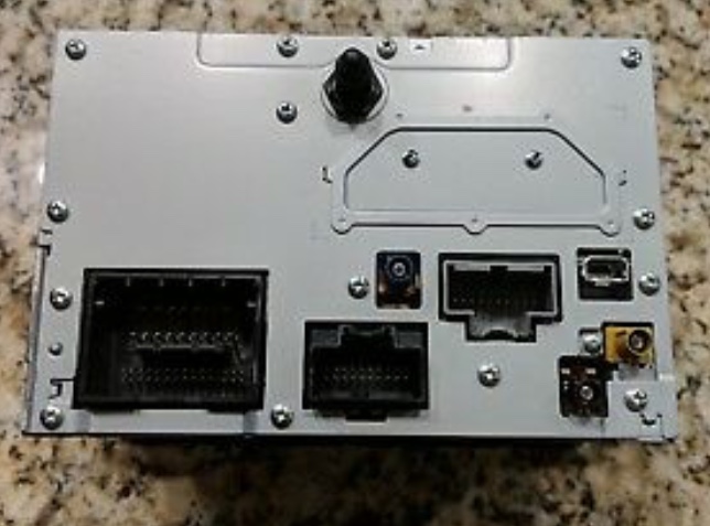

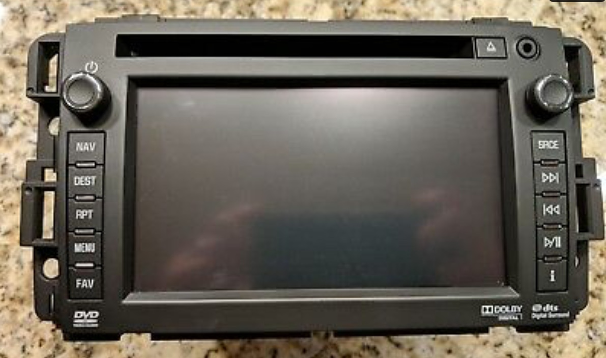

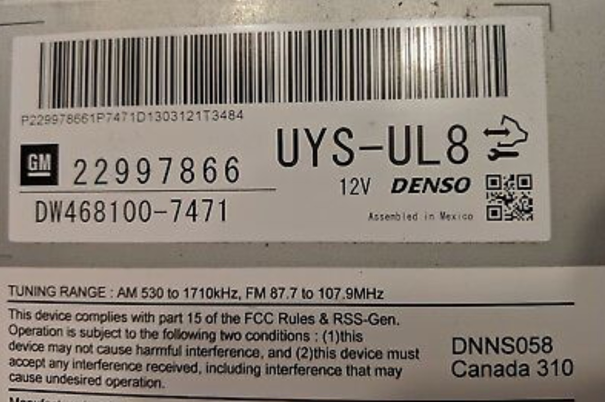

Did some research on this. If im gonna do this swap for a factory nav radio I need to find a 2012-2014 radio. Help me find one.
Luie.
You just missed one for 100 in the want ads here....
Probably gonna spend 4-500 on ebay then ship it to be programmed and harness you’re looking at 700. I just did it last year or maybe 2 yrs ago, Not worth it imo but its yours so good luck
I found a navrad from a pickup From a guy for my 13 For 300 i got him to 200 then program etc Cost me about 4-450 total

I believe a Tech2 can reprogram the radios to your VIN.
If it costs that much to have it reprogrammed it'd be wiser to just spend the money on a Tech2 and do it yourself and have the Tech2 for future diagnostic and programming use.
