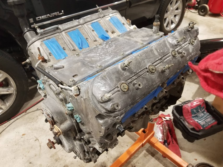

After it dried.

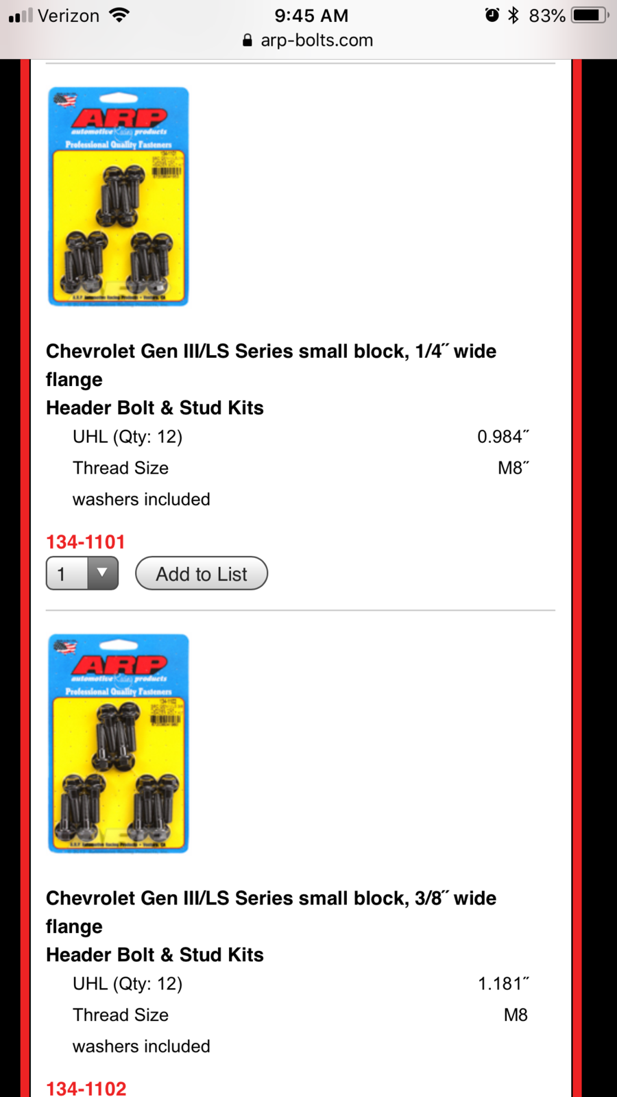

Also, I forgot to mention when I pulled the driver side exhaust manifolds I found that the front bolt was also broken in addition to the rear two bolts. The front and rear bolt snapped flush with the block. Also, one of the bolts on the passenger side was also snapped flush with the block. So, in total I have 3 that are flush with the block, and one with a nub. :eek:
Between a damaged heat shield, snapped studs, and needing new gaskets and bolts I plan to just buy new Dorman stock replacement exhaust manifolds which includes everything. Does anyone know if the bolts that come with them are any better then the stock GM bolts, or have a recommendation for exhaust manifold bolts?

ARP.... this was a quick search but they are out there. If you just use the dorman i personally think you wont have to worry about them breaking again while you own the truck but what do i know. I guess if you want to really ‘upgrade’ if you want to call it that, arp would be my choice.
