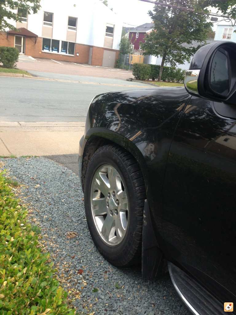

I just realized I am running 33s on a 2/3 drop lol. No wonder it's such a squeeze! Also hate parking lots because of it. Time for new ones soon anyway..
