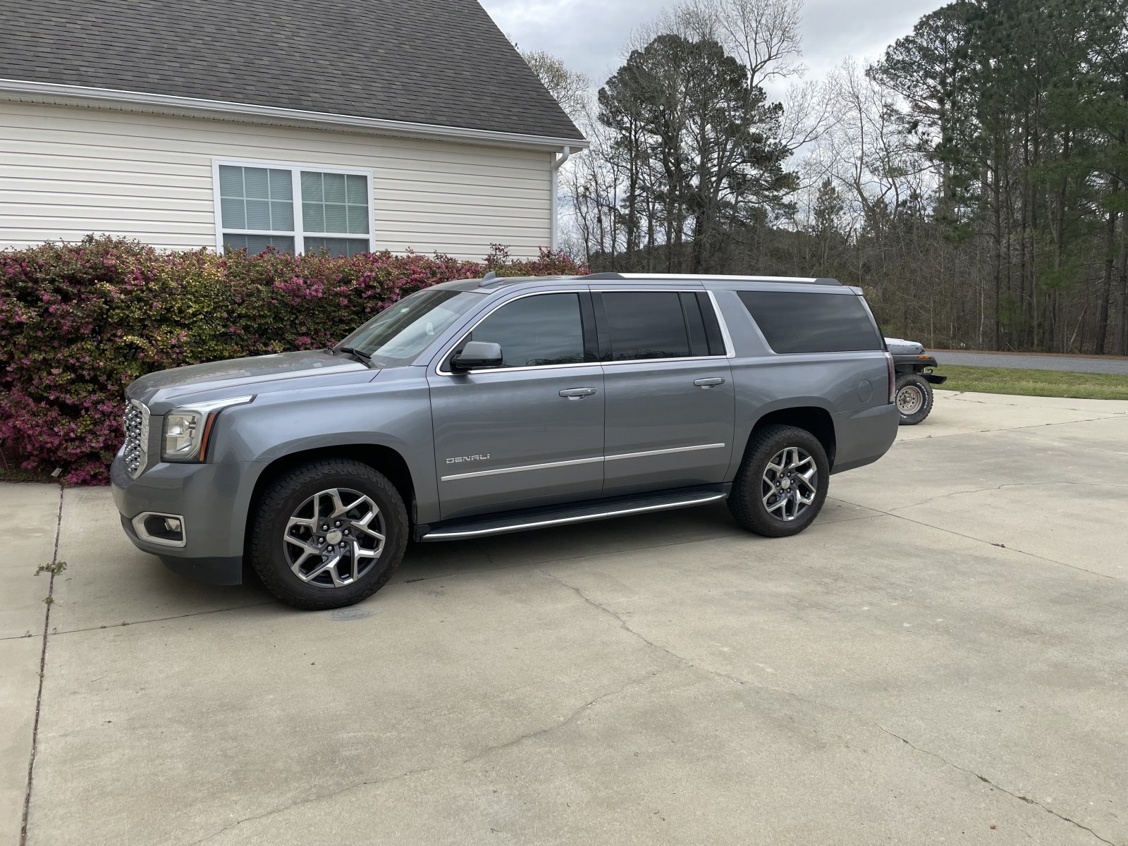

Ohh, it's done! I used a 4" hole saw in the center of the tread beside the valve stem. It worked great. Absolutely no damage to the wheel, but plenty of damage to the (worn-out) tires.
The wife and I are happy with the new wheels/tires.
