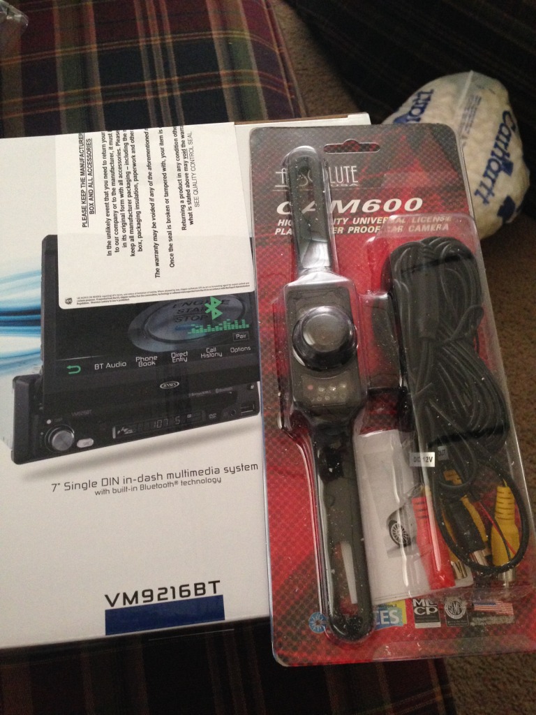

Everything ready to go

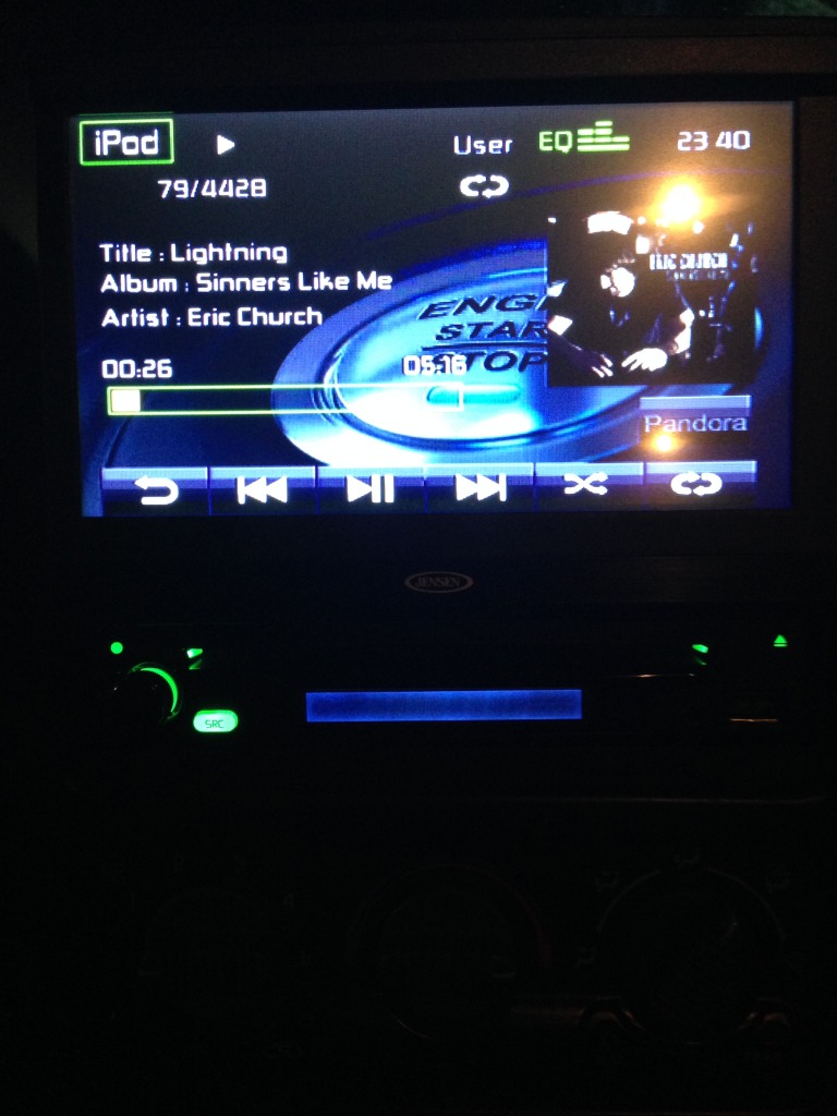

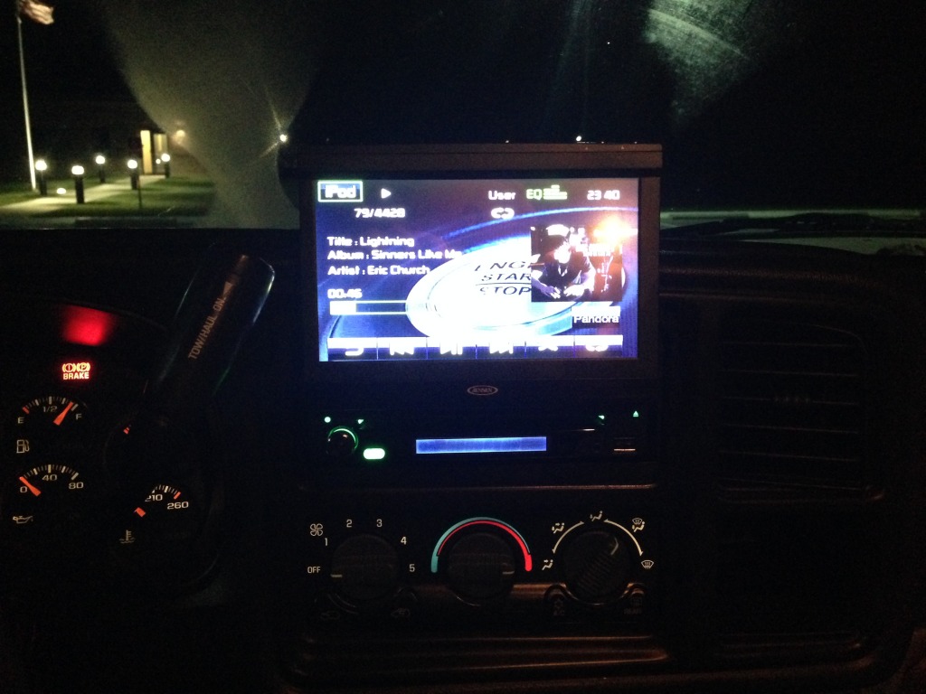

iPod hooked up and working great

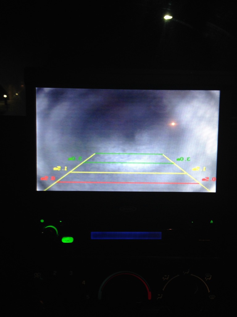

Backup cam looking at a bunch of grass and trees
The cam - Absolute CAM-600

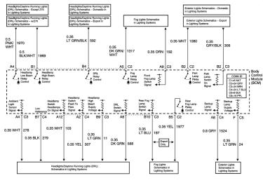

Quick question, did you have to connect the reverse wire from the radio? If so, which wire did you tap into?
choodock
Oct 1, 2012
110
Waco, Texas
I just wired mine up yesterday on my 2004. I used the light green wire out of the black connector on the far right of the BCM.
I just soldered a wire to the reverse light and ran it to the head unit.
