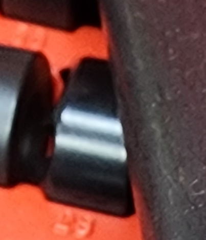

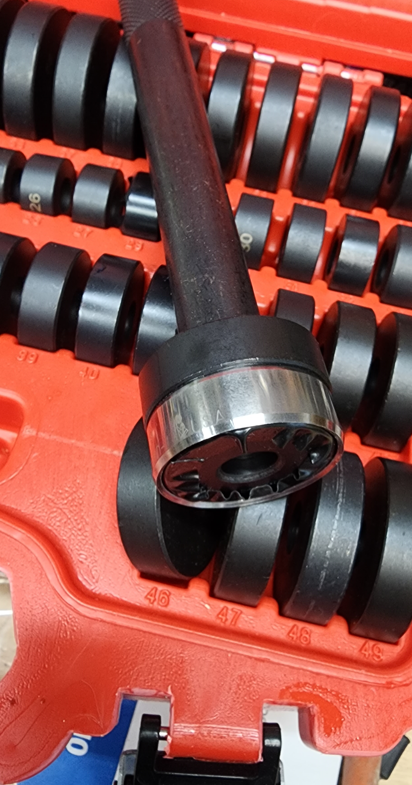

Here we go,
I had to go out to my bushing set, i just happened to have a spare bushing + a few of the drivers that still had the electrical tape installed. :cool:
I hope this makes sense.
Tape used to make the bushing driver fit the bushing tighter, preventing it from deforming when driving in.
ETA: of course the tape does not stay with the bushing in any way.

Not concerned about any of the above.
Only what you said about putting electrical tape on the bushings. Here's how im interpreting what you said:
You thought there was too much clearance between the Id of the bushing and OD of it's journal in whichever part the bushing was installed. So you elected to put electrical tape on the inner diameter of the bushing to reduce the clearance. And you installed these bushings with tape on them into the transmission.
Is that correct or no?
I suspect im simply misinterpreting what you're saying but want to be sure.
That makes it sound like I left the tape on the bushings? :roflbow:
I hope the image above makes sense.
also see this bushing in the background, it still has the tape on it.
Used a razor blade to perfectly trim this shit too, making sure this crap went in as square as possible.

and the driving surface of the other bushing has 0 tape since that would mess with the driver and could mess with the mating of the two surfaces between the different bushing driver discs.
the overlap you see where it hangs off the end is due to me installing that tape perfectly with the taper on the bushing driver, so the two driver halfs are all nekid when they get it on. :boobs:

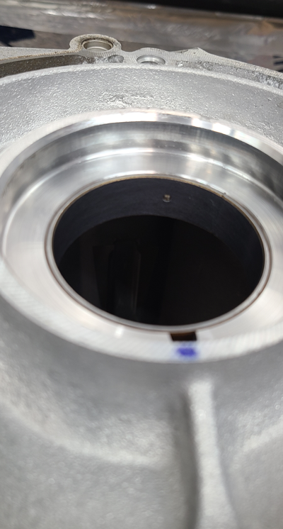

Here is an example of a bushing that I used tape on during installation.
The rear case bushing, I also spent tons of time researching that silly oil feed hole.
Note the original blue marking of the pass through in the case.
Confusing as fk right there. :secret:
Oil feed hole in bushing suggests oil needs to pass through that right?
What I found = not at all.
Just generic stock that had the feed hole for another transmission, factory says it should not have a feed hole that matches up in the case since the oil feed comes from the output shaft.
I spent hours and hours confirming that shit.
conflicting info all over.
And I ended up installing the bushing in the exact same spot as the orignal bushing.

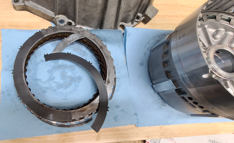

I'll add one more little tidbit into my adventure with the 6l80 rebuild.
I ran into an issue that is somewhat well documented with rebuilders.
Apparently a batch of 6L90 1-2-3-4 drums went out with the 6L80 stickers.
That confused the hell out of me when trying to do endplay checks.
I couldn't get the stupid pump to seat!!
Then I remembered the note when watching the mass amount of youtube videos where one of the builders noted that as an "FYI" and to always compare the old part to the new one.
Sure enough, set the new drum next to the old one and I could see the height difference.
the 6l90 has an extra clutch plate or two, and the case is a little longer in that aspect.
In a way it sort of worked itself out,
I had issues with the selective snap rings, and the 2-6 clutch was out of spec.
And I couldn't source one that called out 2-6?!
and the instructions state that if the clutch clearances are wrong, then you assembled it incorrectly and to do it again. :bs:
I disassembled and reassembled several times, and it checked out! :chair:
So, I ended up using a snap ring from the 1-2-3-4 drum that fit perfectly (and with much better tension), that brought it right into the needed clearance spec.
doing a little mixing and matching I also got that 1-2-3-4 clutches nice and consistent with the rest of the build.
I also noted one youtube video where they ran into a broken wave plate in the 2-6, I had that in my transmission.
No symptoms that I noticed, but it looked like a ticking time bomb if those two broken pieces happened to bind up and fry the clutch.
Picture I posted in my build thread ( https://www.tahoeyukonforum.com/threads/just-fishings-09-tahoe-build-thread.125403/post-1666200 )
