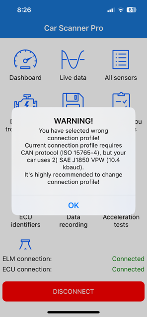

I loaded and paid for Car Scanner Pro (I think this is the IOS version for Torque Pro?)
I tried to get the app to read Ethanol Percent but it said my vehicle protocol is not new enough.

The Car Scanner Pro is apparently saying that it can't get to the Ethanol Percent using SAE J1850. That could be bunk - I don't know. When I attempt connecting using the ISO 15765-4 I see the Ethanol Percent PID but the software won't pull it up on a dashboard.

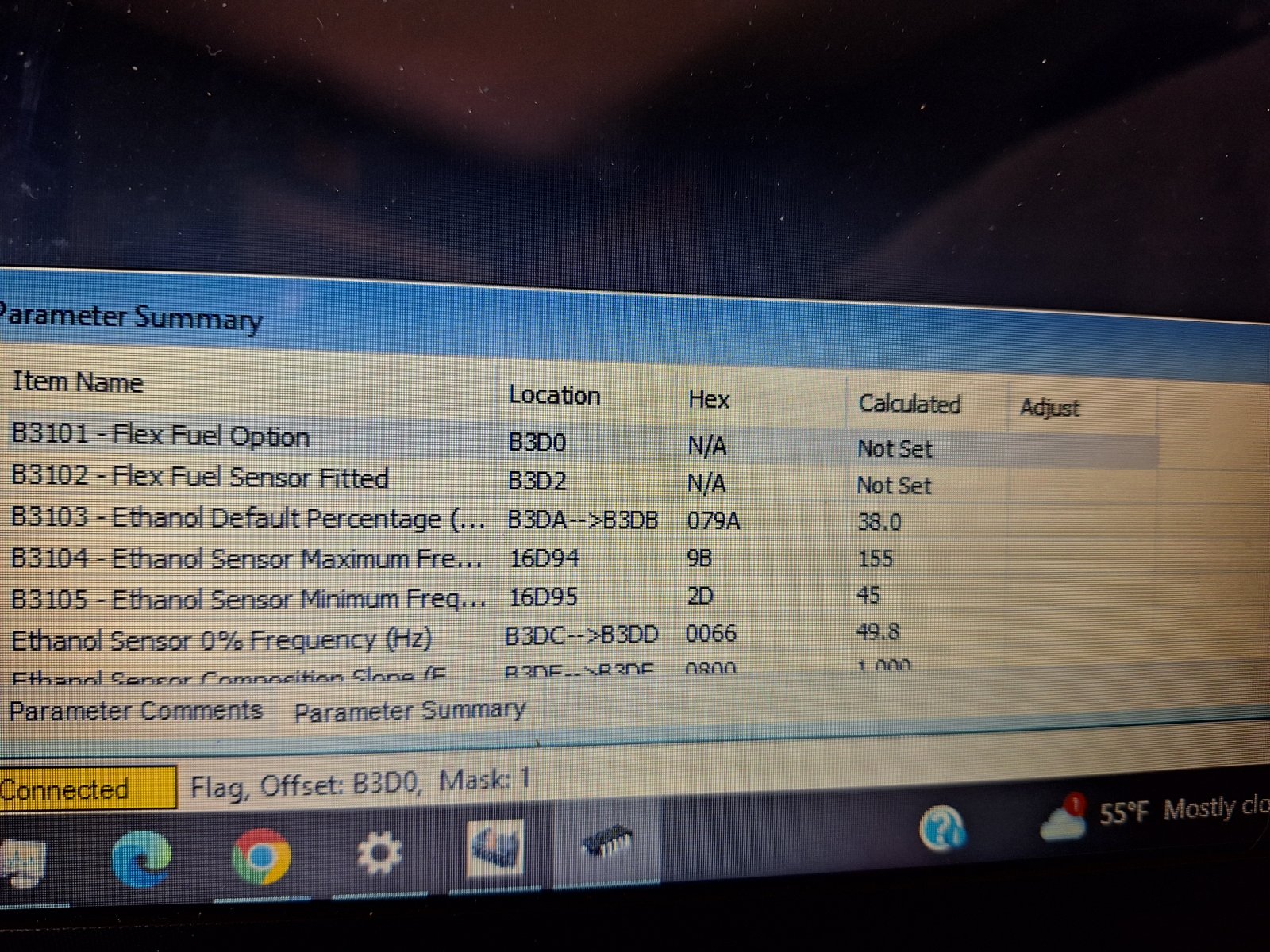

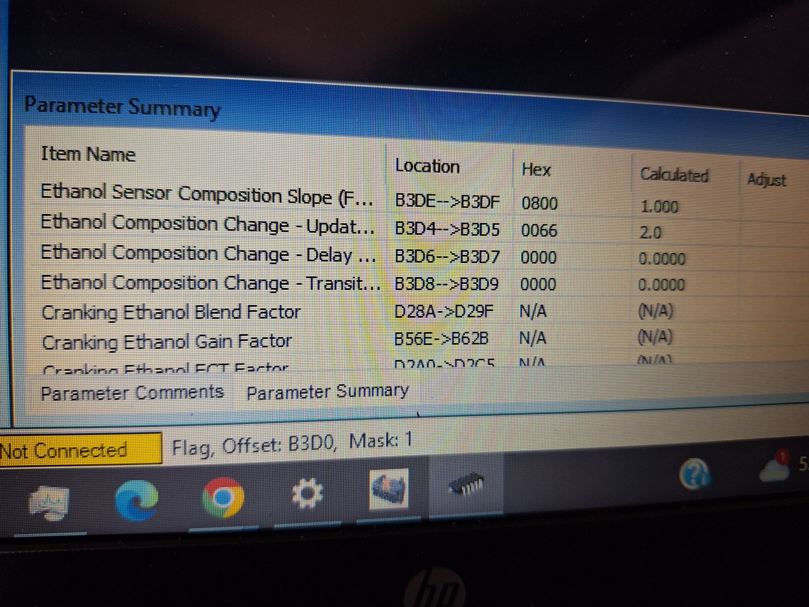

@2006Tahoe2WD , do you know what operating system your tahoe ecm is running?
I have looked at os 9623, 7811, and 5114 all 2006 OS calibrations show a base of 38.007 percent of ethanol in the flex fuel section. All vehicles seem to have the tuning there in the ecm, but whether or not it was active from the factory is dependent on the specific vehicle. There is no alcohol composition checker outside of the flex fuel settings that I can find. So I am going to say that unless the flex option is activated you can't see it.
I will post a couple pics of the parameter location and hex info.
