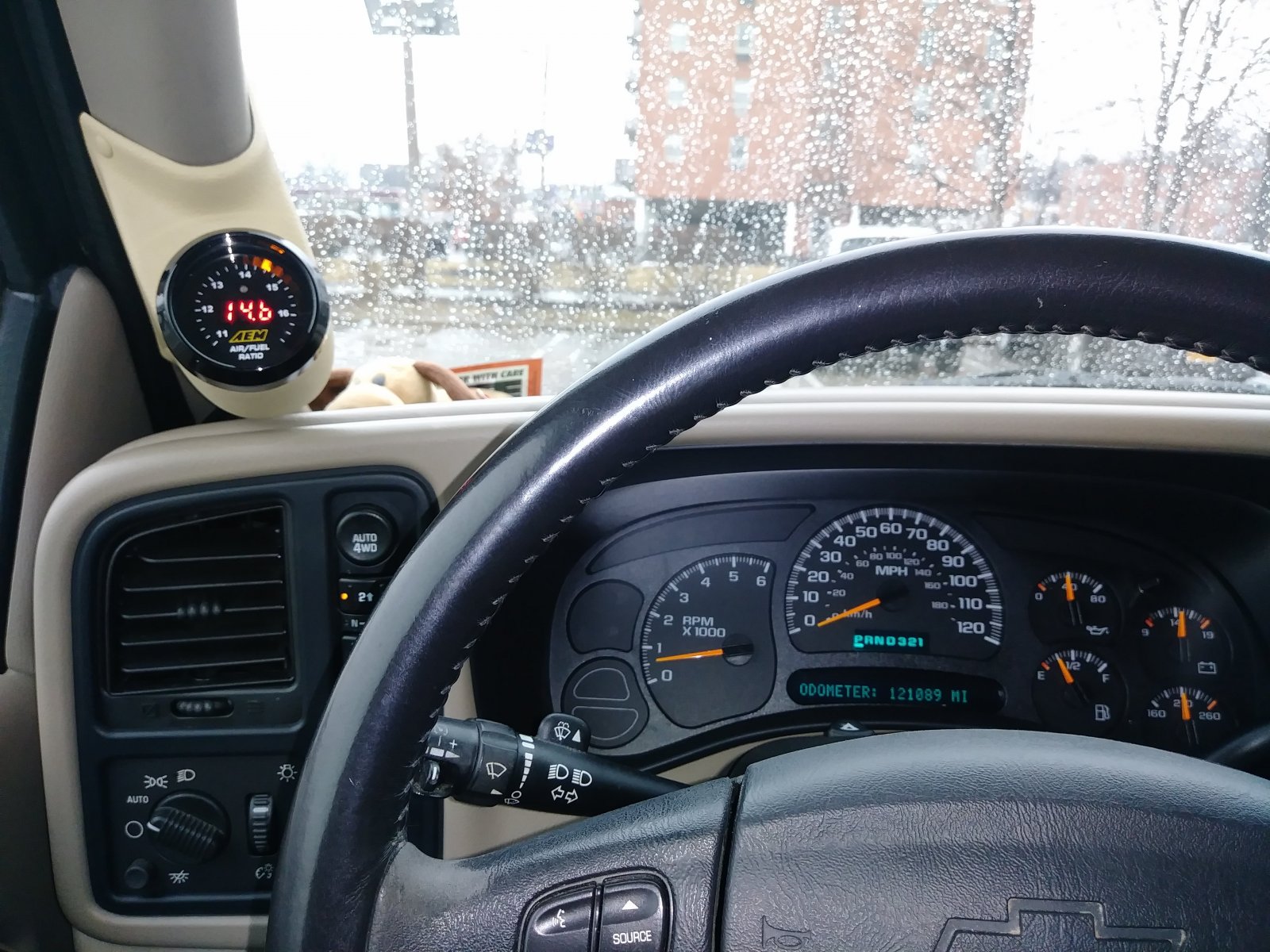

I expect the O2 voltage to swing back and forth across zero (~14.7 or whatever it is going for). The controller must be also swinging the injector timing - I would expect to see the wideband also swing but it might look like a ripple and not 0.1-0.7-0.1 back and forth.
the faster he voltage swings 0-9 the better. injectors are done via the cam and crank sensors, o2's just monitor the fueling.
a wb should show 14.7 at idle and in a stock truck if you floor it it will stay at 14.7 for 60 seconds then drop as it richens up the fuel tables. got one in my tahoe for sh its and giggles and i tuned it some.
