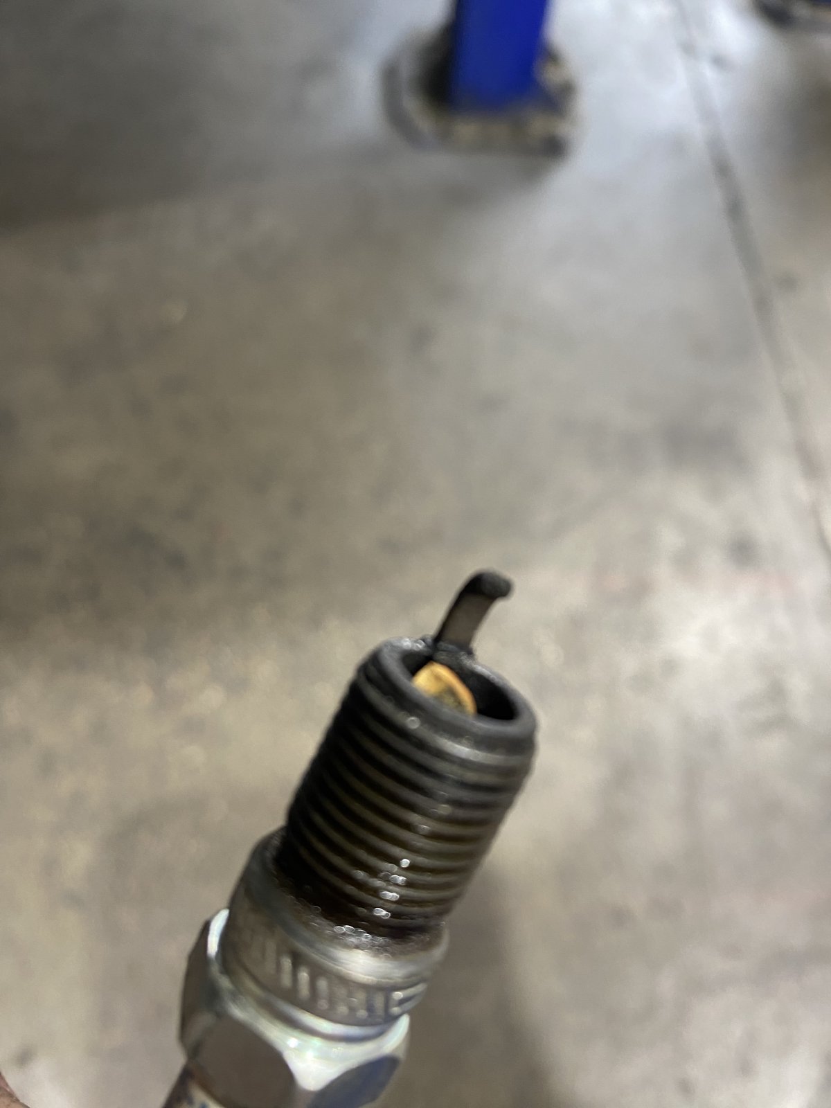

One thing I noticed last night as I thought about it, my spark plugs are a hotter plug than what I necessarily would have wanted when it was running E85 and that lead to a spark plug diode over expanding the gap and blowing the plug. Which it then allowed the truck to develop the initial stumble which I will be checking the cylinder isn’t fuel washed but I also will be checking the tune as I never had one misfire code so I’m wondering did the tuner stupidly turn off misfires in the tune. Which as I find out more I’ll report

Second if you got a plug hot enough to damage it, you probably should do a compression check of that cylinder. Just to verify you didn't hurt the piston. And while you are at it, check them all.

After rereading the post about spark plugs, typically you want the same temperature or slightly hotter plug not cooler for e85 than gasoline, as the higher ethanol content takes more to light off. And when you say blew a plug, do you mean the center electrode and porcelain? And did it go into the cylinder?

Yes I meant the electrode and the porcelain.

You need to borescope the cylinder that plug came from. With an 11:1 engine there isn't room for that to not hurt the piston.
