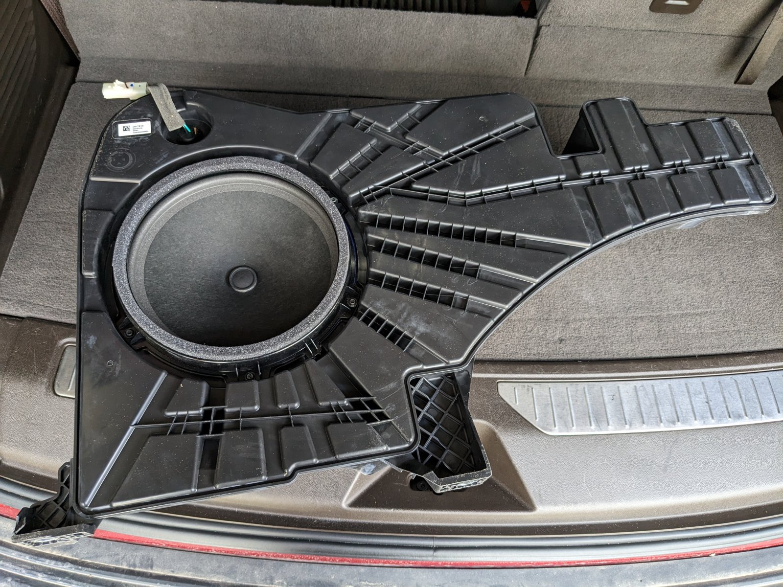

With regard to it fitting on the XL, that's one that I can't tell you. This box is designed to fit over the wheel well and with there being more real estate between the wheel and the rear of the truck, I really don't know. Here's the link to to the AKG site that's specific to the Escalade (https://www.akg.com/ForCadillac.html). I'd say you have two choices:

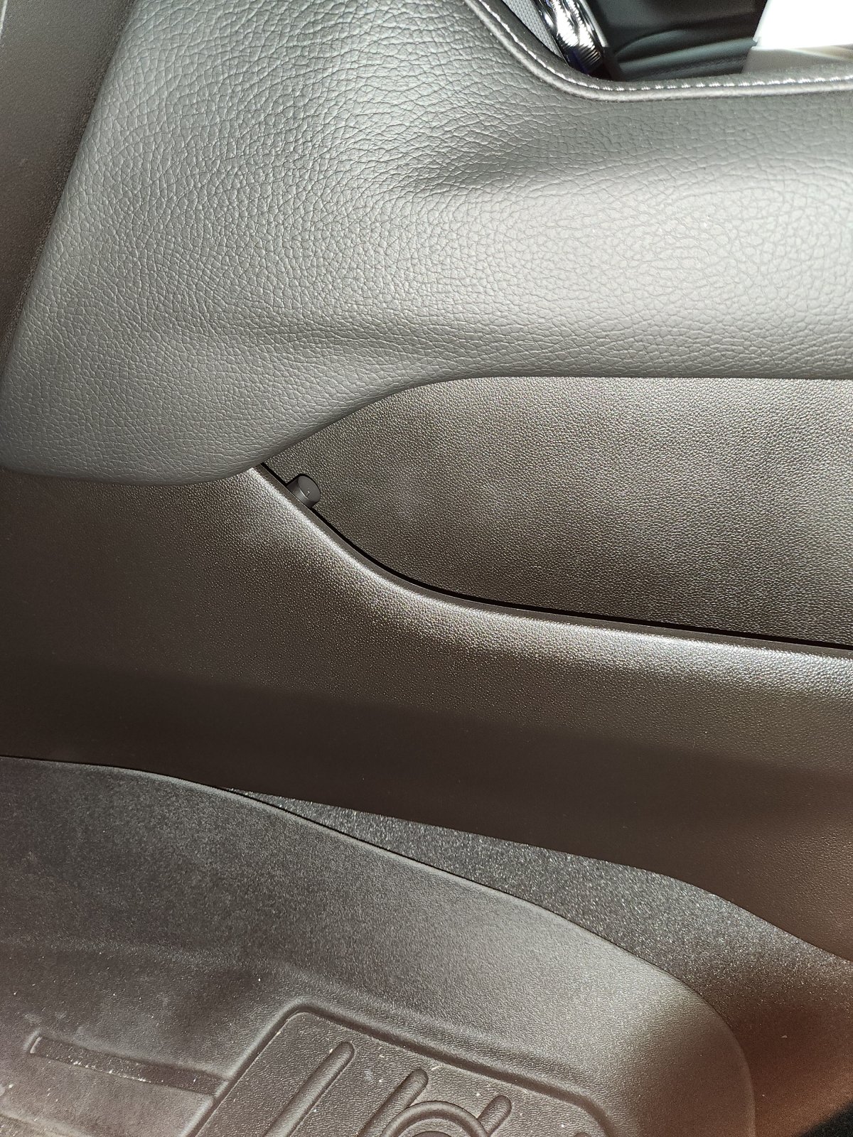

2) pull off the inside rear quarter panel and have a look. You might even be able to get away with pulling the cover off of the fuse/jack box and sticking your phone in there to take a picture or two.
If it helps, snap a few pics in there and DM me. My guess is that it's going to be the same as the standard vehicle, but with more space. I can't imagine GM completely reworking how the amp is fastened to the truck (although, I wouldn't put it past them). Good luck and let me know if you have any more questions.

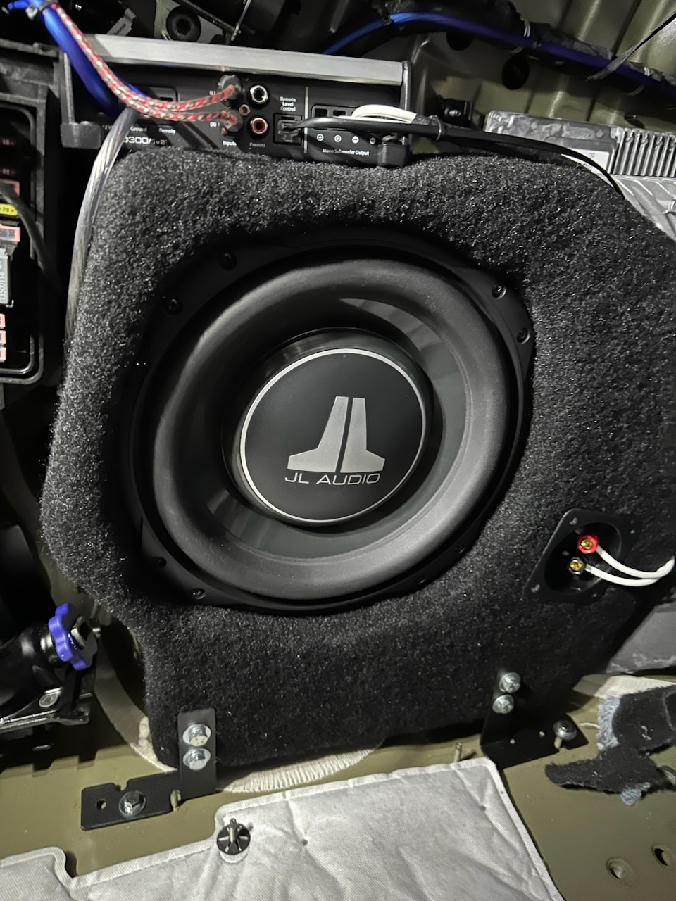

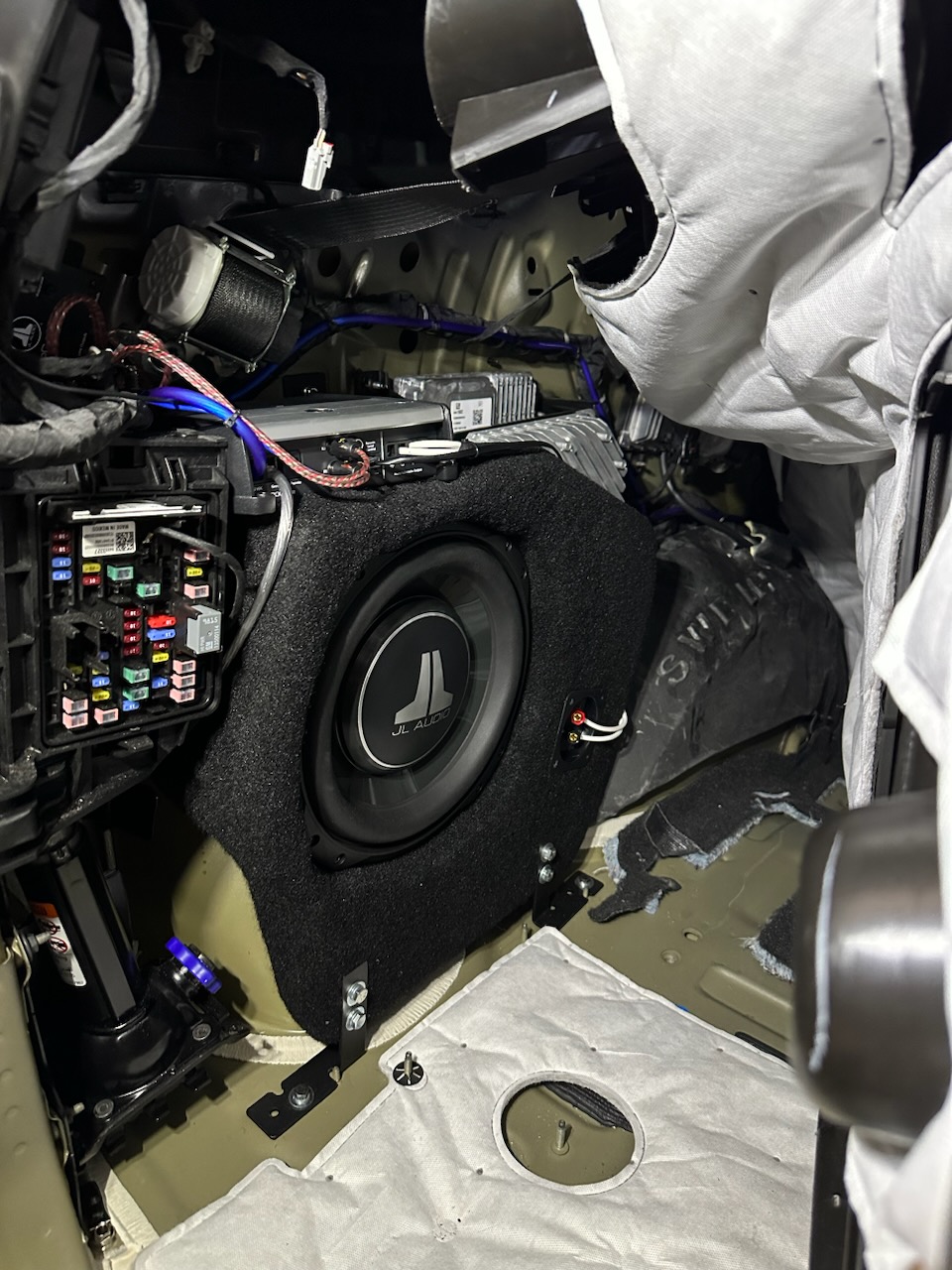

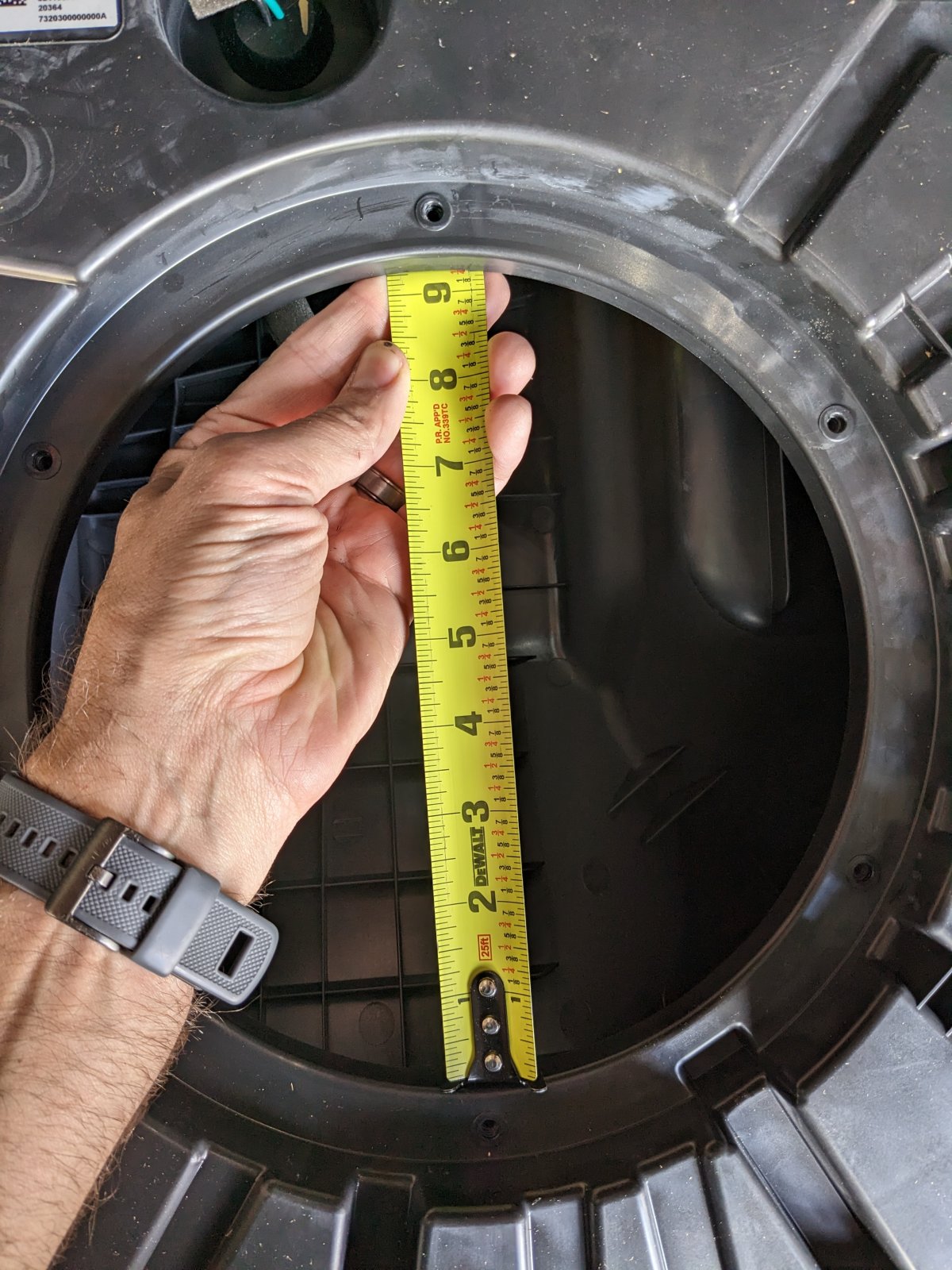

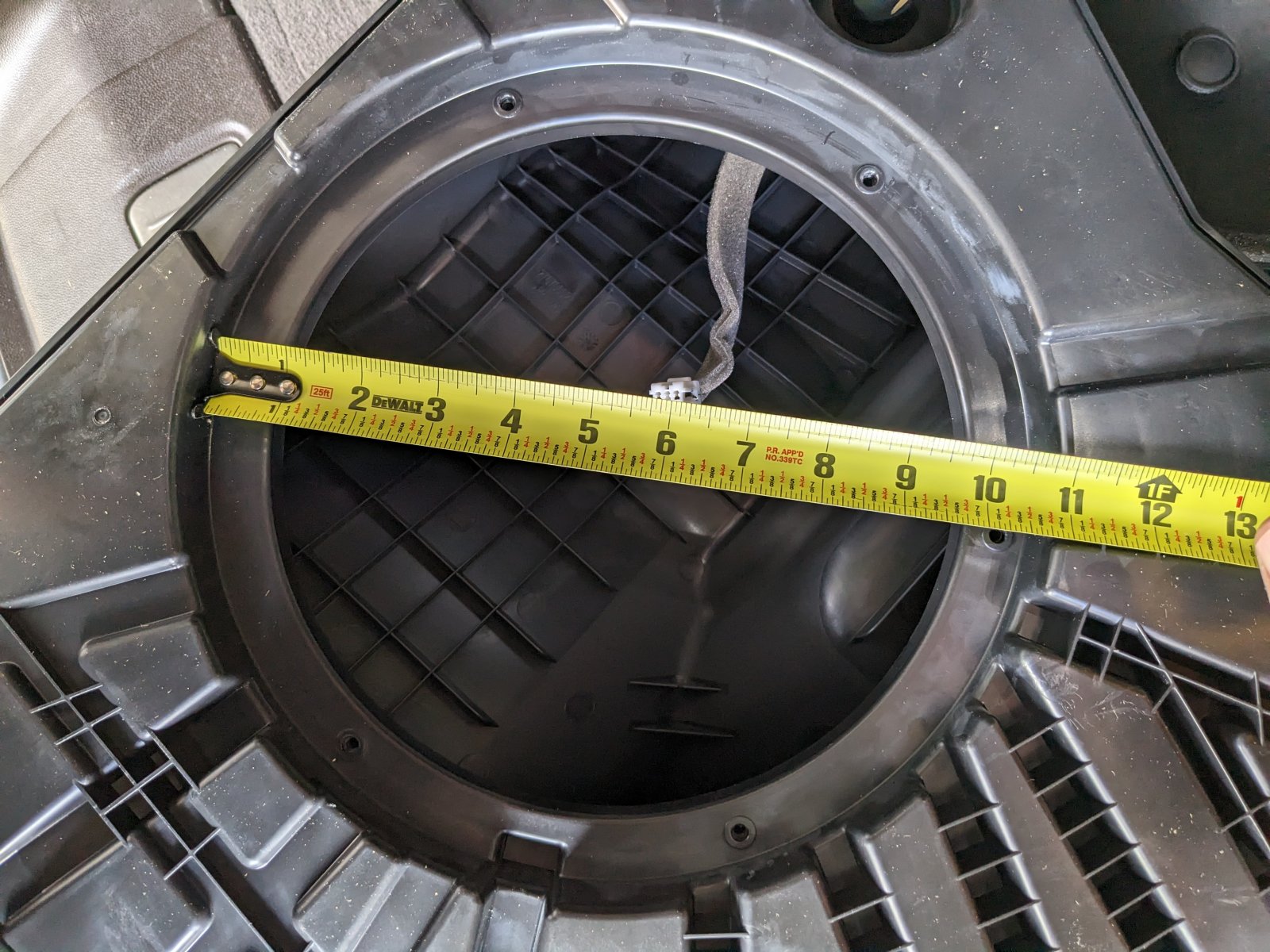

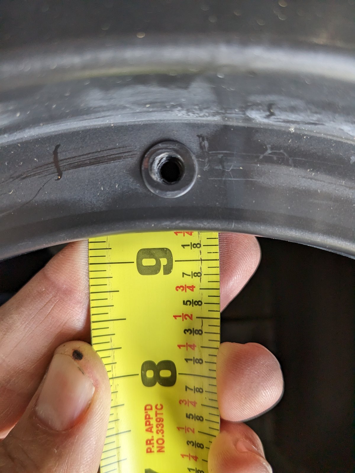

FYI the JL 10TW3-D4 does not fit into the esky stock box unless you are stubborn and used to making bad decisions like I am.
The cutout diameter is 9 1/8" and the maximum size of the bezel is 11". The JL exceeds both of those dimensions but I do own a router and Dremel.
The mounting surface isn't perfectly flat either so it would be best to choose a sub that has even mounting points - unlike the JL which only effectively has four. I supplemented sealing and securing with RTV.
That's pretty big box, probably larger than the JL calls for but I'm of the opinion that most subs speck smaller volume boxes than ideal for marketing purposes...
Also, my vehicle amplifier was mounted with 3 M10's and one plastic push on clip which created a massive resonate vibration so be sure everything in that area is bolted down and secured properly.

How does the enclosure hold up with the JL? I just ordered the enclosure and was deciding on what sub. Was likely going for the Hertz MPS 250s2, but wasn't sure how well the enclosure would hold up to higher end subs. The JL has similar xmax as the Hertz so if it holds up well to that, I should be good to go to pull the trigger.
Well it hasn't rattled itself apart. I did have some vibrations at the mounting points which had to be adjusted out with some firm foam.
The frequency response is kinda funky with a huge spike around 80hz and drops off rapidly after 50hz. I was able to use a DSP to turn that out.
I'm not familiar with a subwoofer of this specification or a vehicle this long so this may just be a case of it is what it is.. It sounds good and creates some strong DB's, just enough to feel the seat vibrate and loose sight of what's in the rearview mirror. But it's right on the limit of making some real bass which keeps me wanting more out of it.

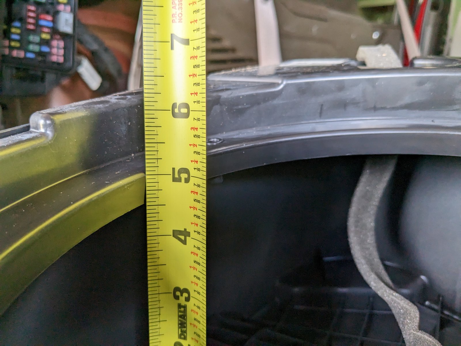

Update: the hertz mps 250 doesn’t fit in the Escalade box. Although the spec sheet seems like it would, the basket is too wide and hits the bend the box has to accommodate the stock amps. Returning the sub and ordering the JL stealth box -_-. Should have stuck to buy once cry once mentality.

Thanks for everyone's contributions here. Made it easy to add the Esky box to my 2021 Tahoe. After reading reviews of the AKG system in the Esky, and their struggle to find a sub that will fit, I figured the stock sub with a little power might be be worth a try. It turns out it is pretty disappointing, so now the search begins for a sub that will fit. Here are a few photos with measurements, to help anyone looking for sub options.
