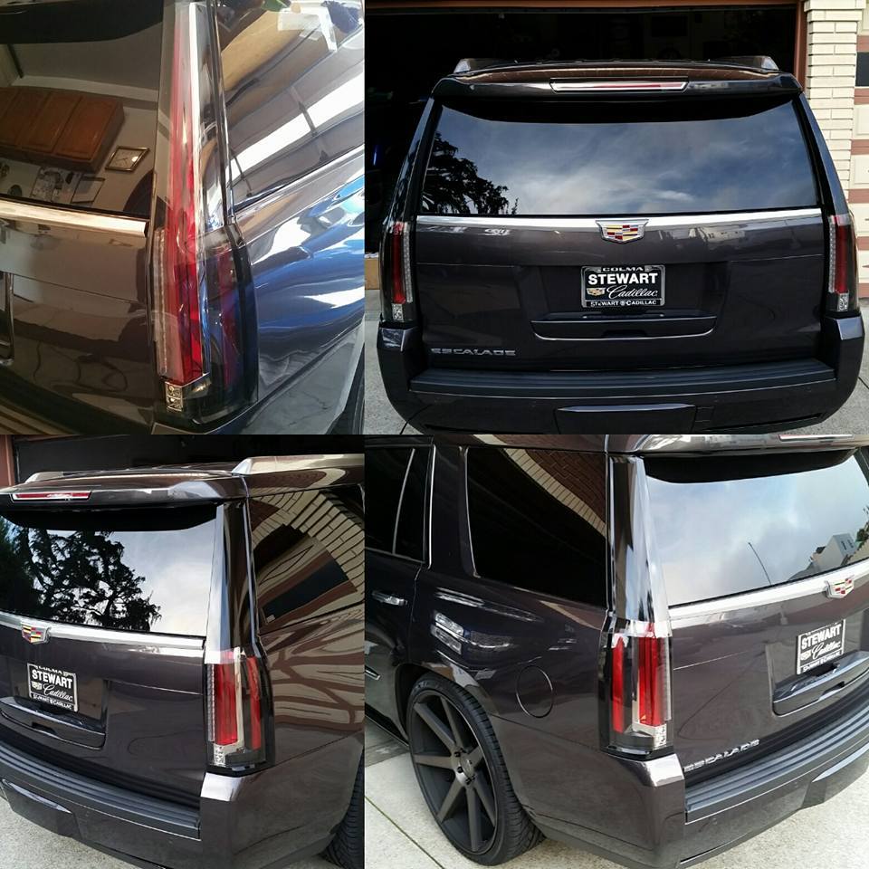

got the lights wrapped. Doesn't look to bad. Ill prob paint to match down the road.
50,978
19,525
Any night time shots with brakes applied after the wrap?

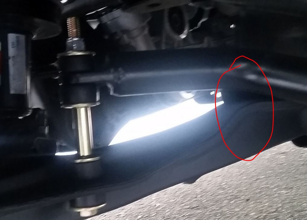

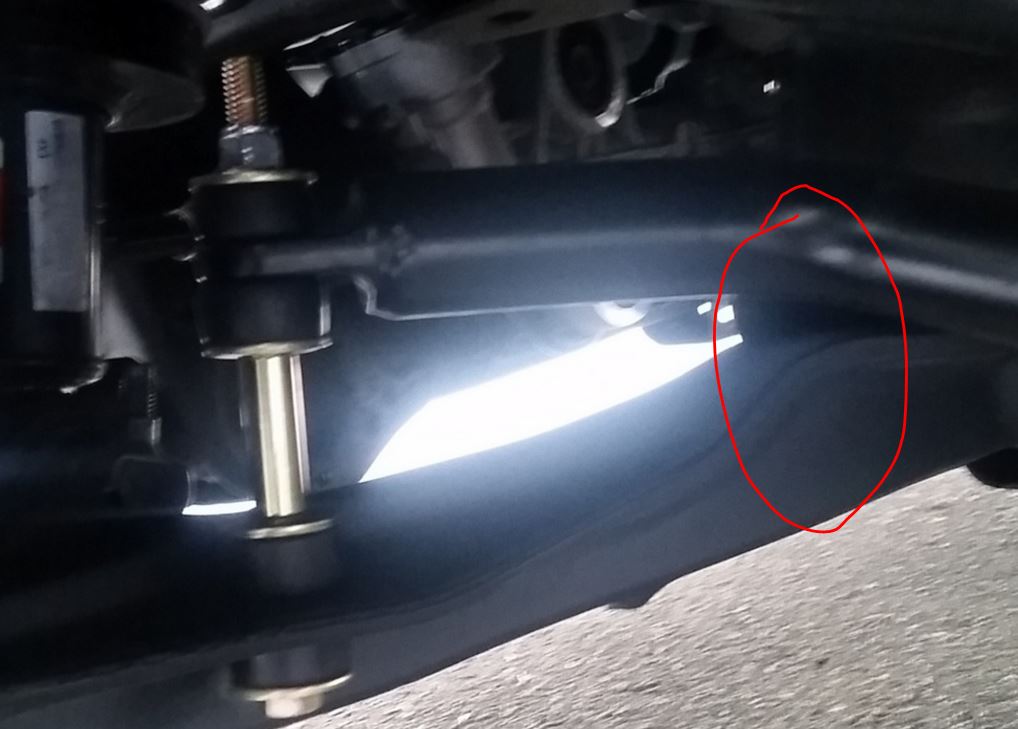

Any issues with the shorter links getting too close to the lower control arm? i think i need these as well as the stock links are too long, bar points up.

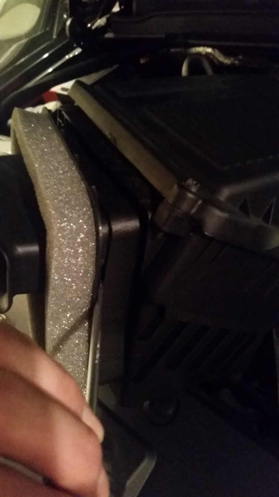

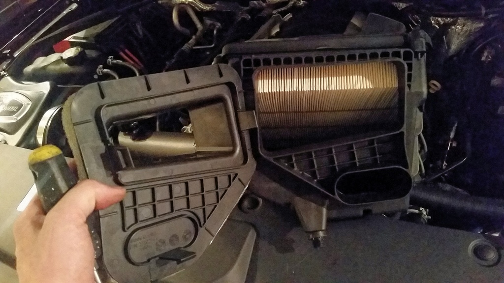

Been doing this set up for the guys that want a little more bump without spending $$$. Replace oem filter with green filter or k&n and then do this mod. Very easy and MUCH more air coming in.
Remove stock intake box and you have this small entry for air flow
get a screwdriver and pop off the front lid
Then your left with this and you can see how much is blocked off on cover and box.
4 inch cut off wheel cut the cover but do not cut the locking tabs on it
Left with this. Ill clean it up with a dremmel
cut the box plastic and then clip the cover back on
