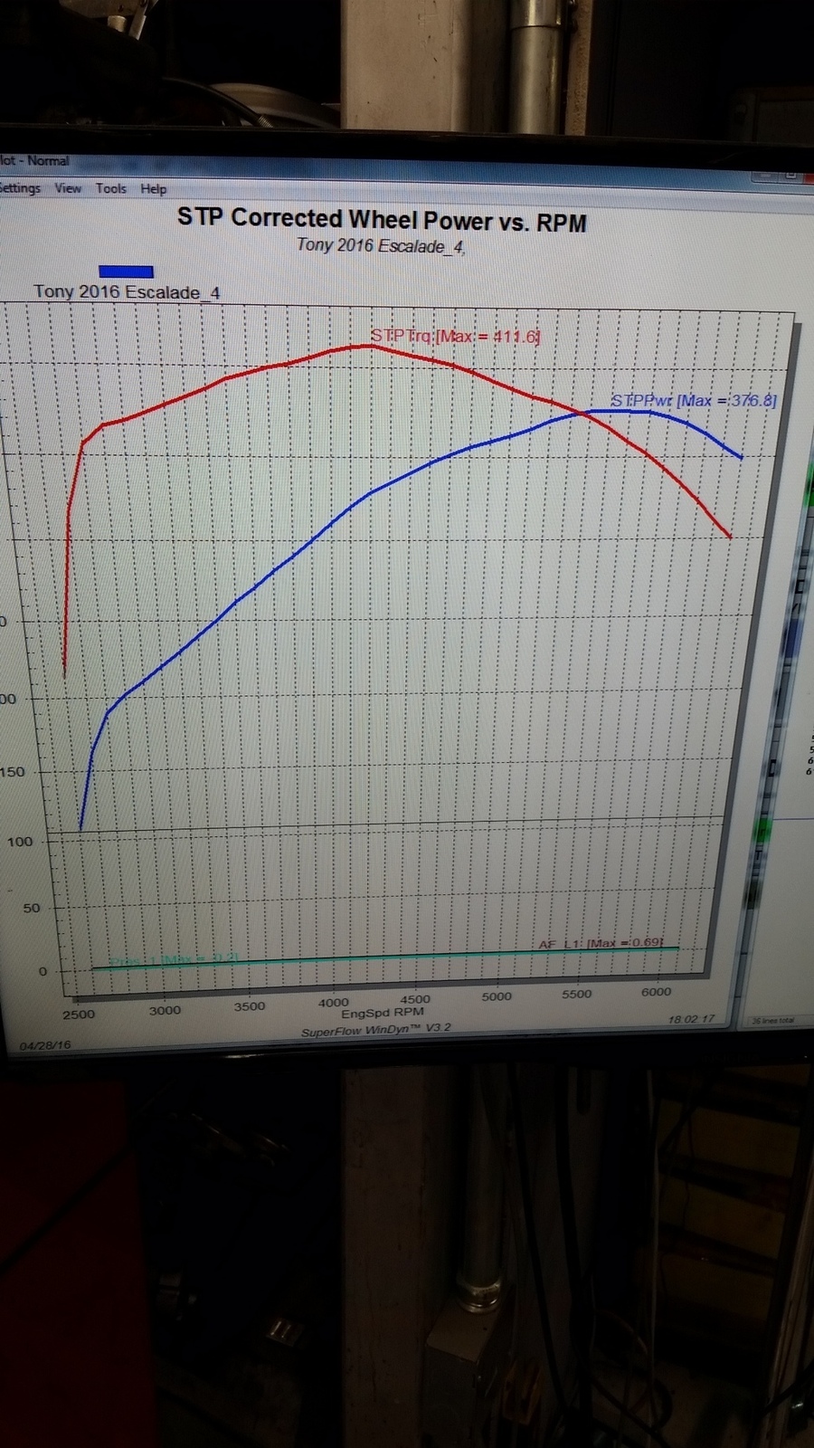

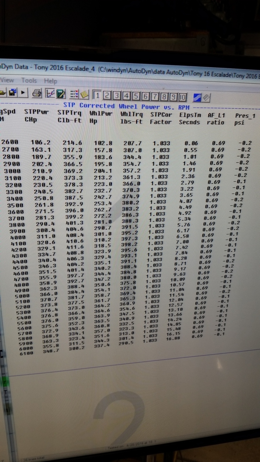

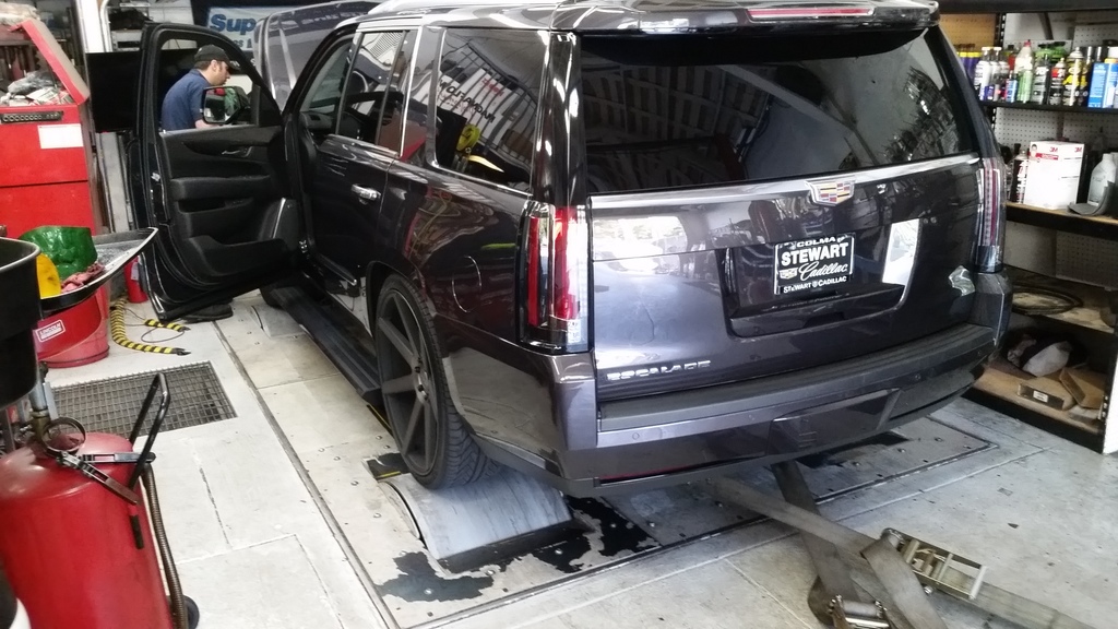

I ended up taking my escalade in to get pre WHIPPLE Supercharger numbers.
2016 ESCALADE
STOCK TUNE
5TH GEAR PULL
AFE INTAKE
MAGNAFLOW 3.5 CAT BACK
376 rwhp/411 rwtq
Did 3 other pulls and they were all 1 to 2 hp away from above results so consistant baseline
I'm very happy with the results. Stock 15 escalade dynoed 331/359 2 weeks ago which customer also bought a whipple kit from me so he wanted before/after numbers
I took time off work on the 8th so I'll be installing the blower. I'M AMPED. If truck makes 500/500 I'll be happy

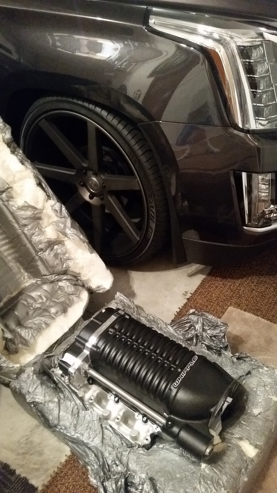

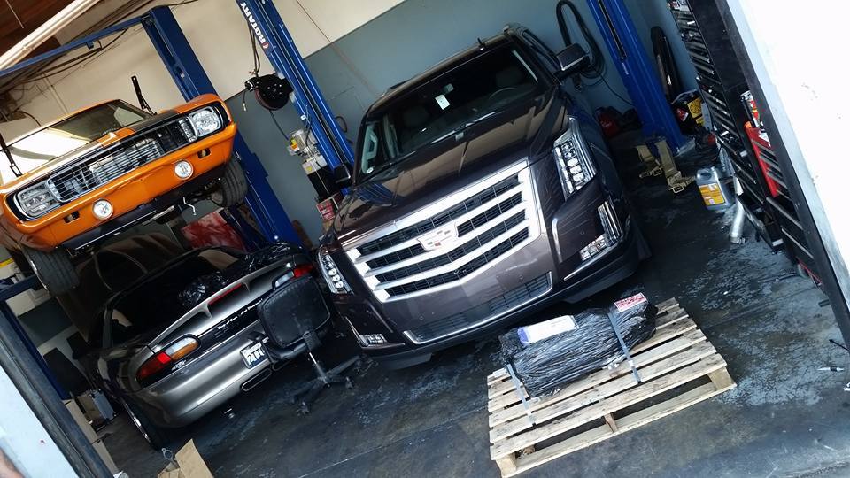

opened box 2 and one of the main reasons i ended up getting this kit was the 4.5 gallon hx tank they give you with the kit
04lade
Mar 25, 2011
35
looking good! You store all these at your house, whats the garage look like man? After the whipple you have any other plans for it or just drive and enjoy?

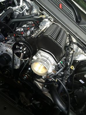

started the 2.9 swap tonight. Ill have pics up tomm hopefully ill get it rolling by late afternoon since i get off at 12 pm tomm
