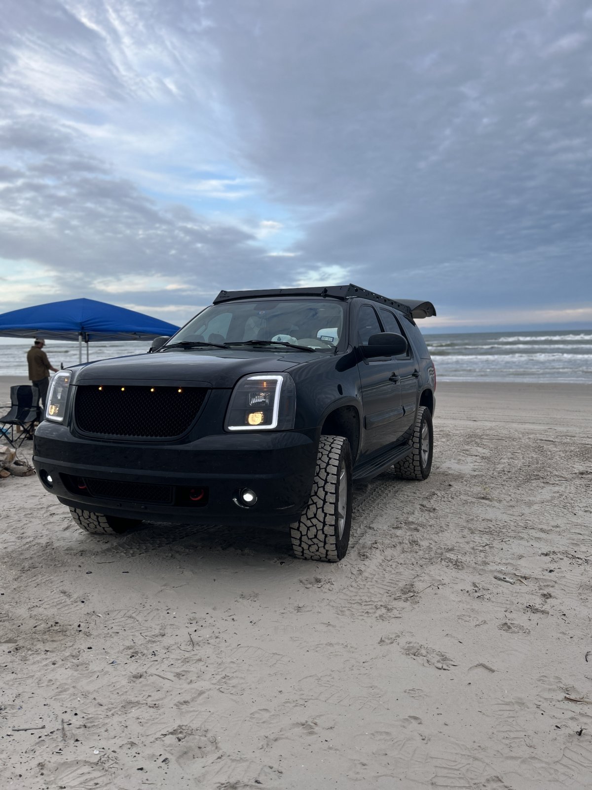

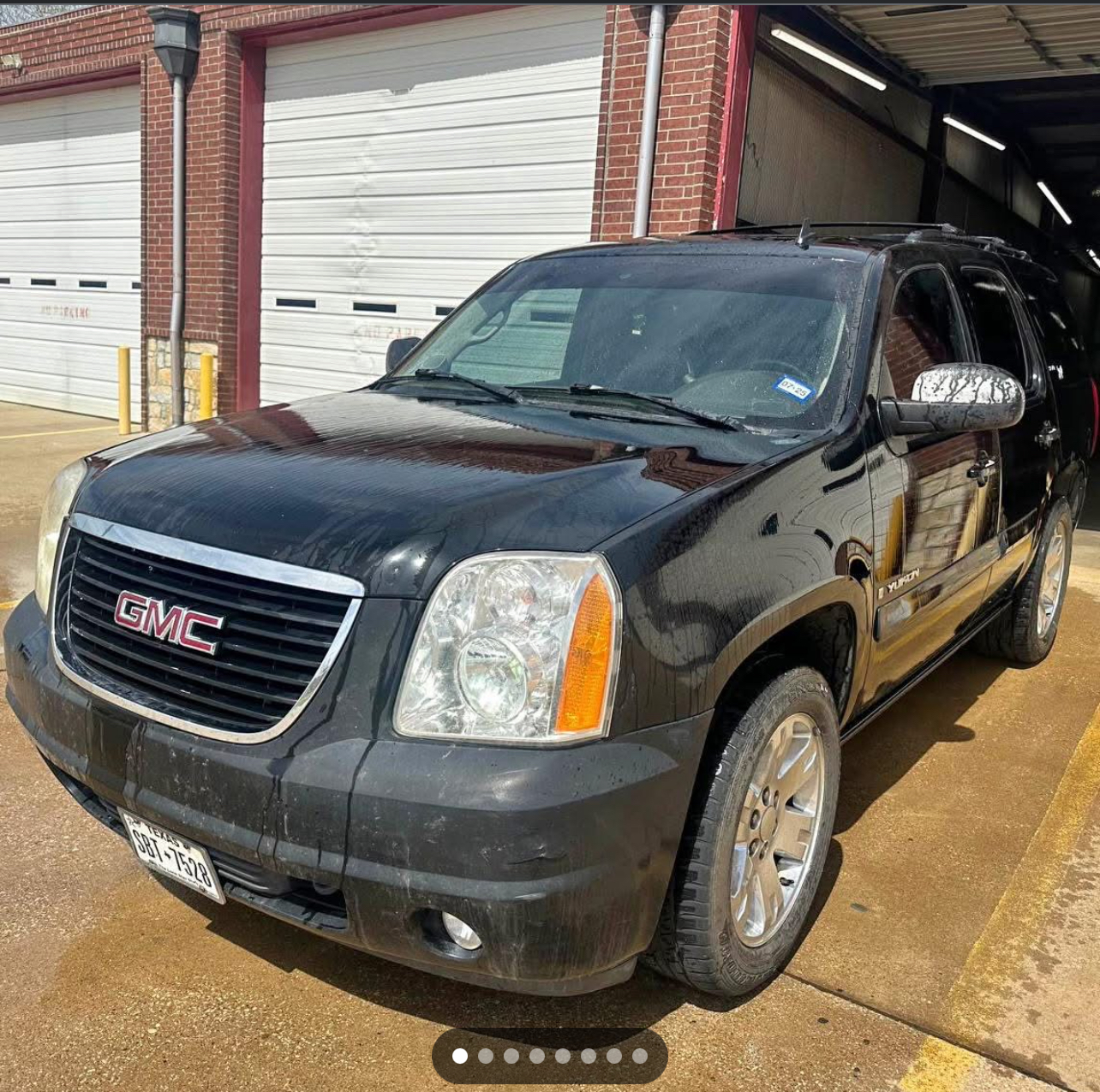

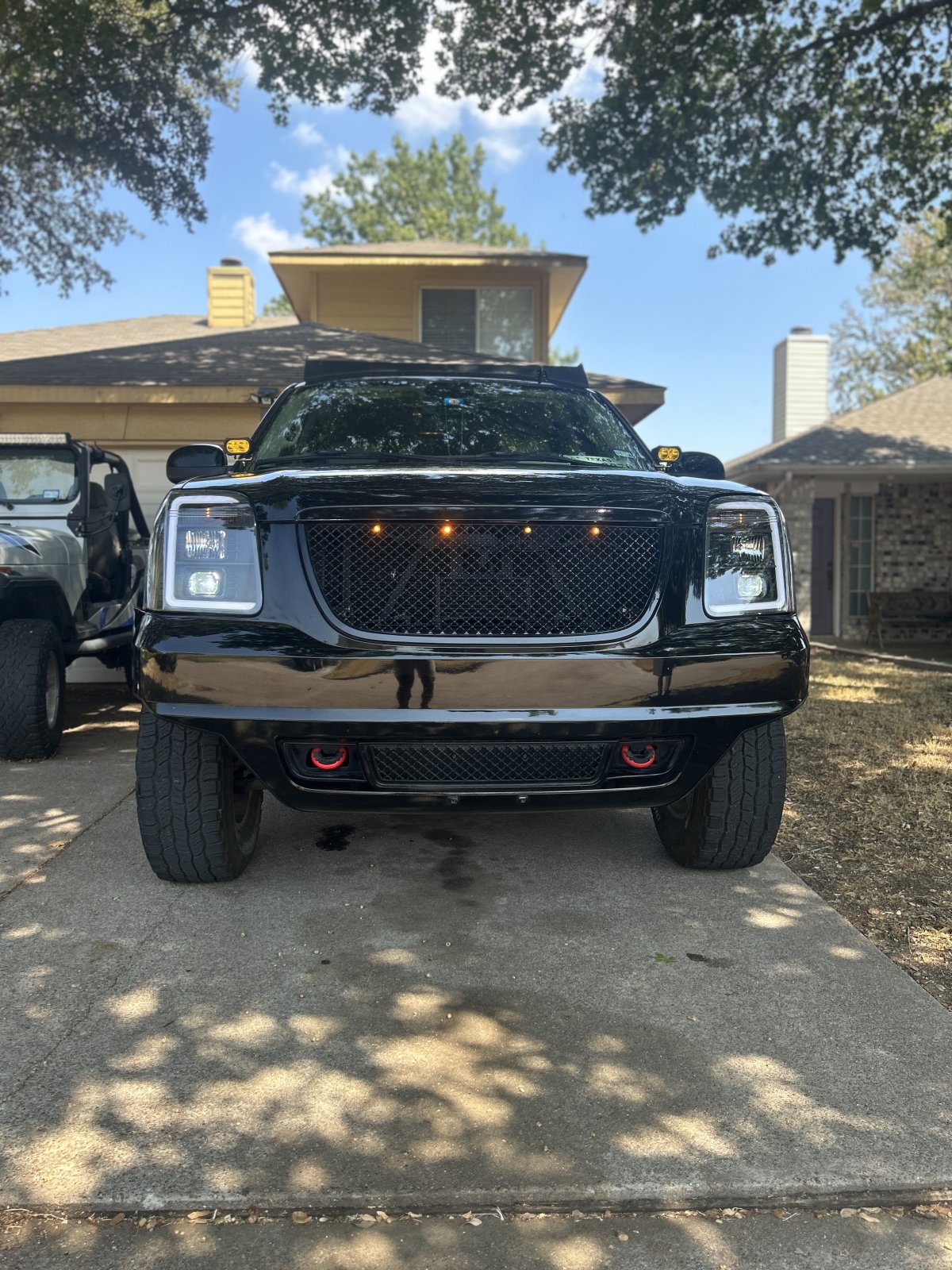

For reference, here is the last good looking picture I have of the Yuk. 212BD79B-056E-4913-82C0-A69591C2A4D7.jpeg

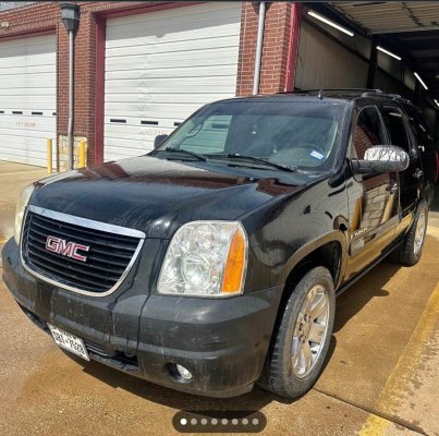

Swapped my parents my 13 Corolla and for their 2007 Yukon SLT RWD. They kept it very clean and it had maybe 150k miles on it. (It was pretty much a gift at the time lol)
My wife and I love the outdoors and usually plan vacations around hiking and camping. So naturally, I started looking at how I could make my Yukon a “super efficient camping vehicle” - this was before I discovered overland builds/rigs.

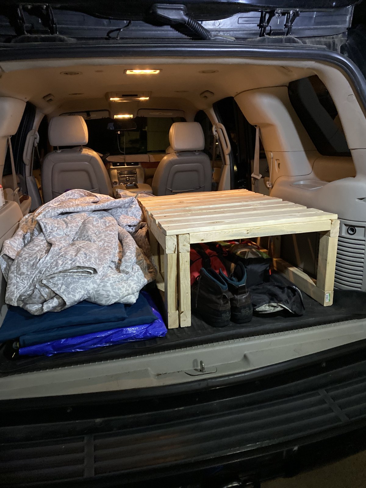

I even went as far as to build a deck that could be used as a table or slide out and folded over the 2nd row seats (when folded down) to make a platform for a bed. 65785248181__3D27D19B-12A8-40A9-A96B-982A99C8FE62.jpeg

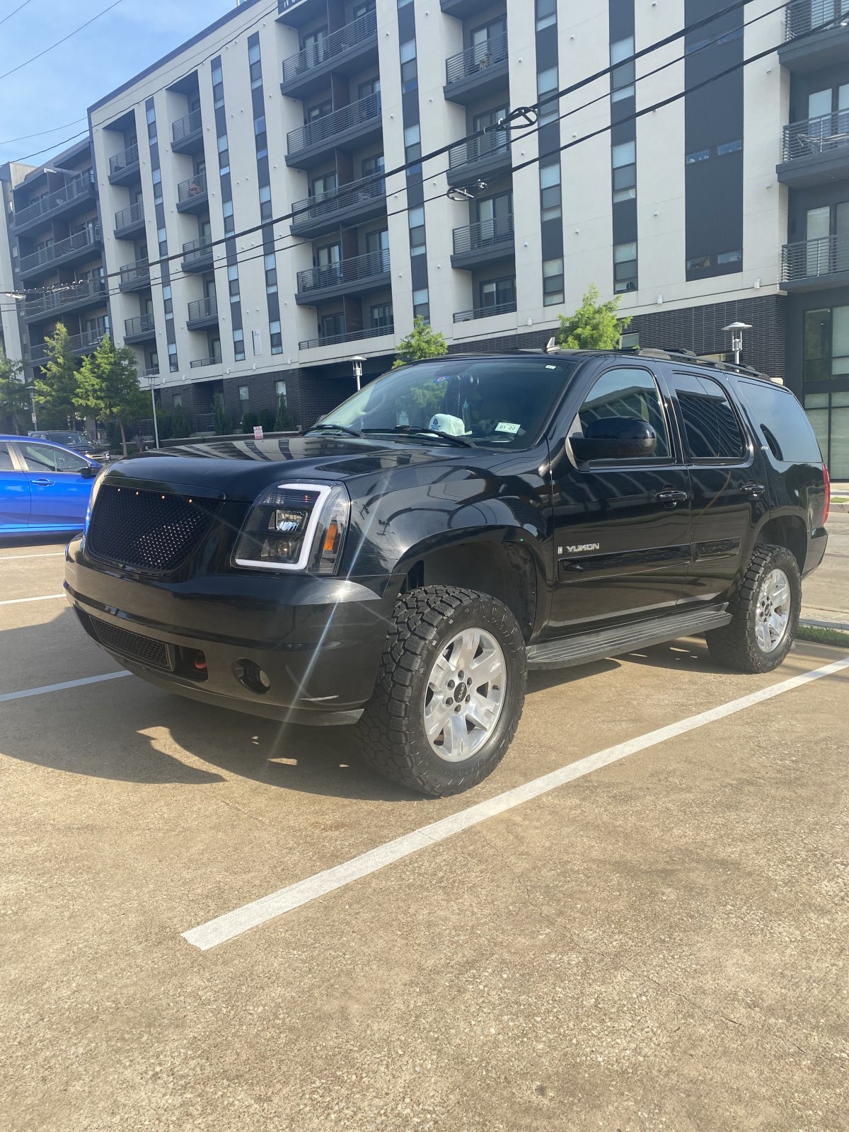

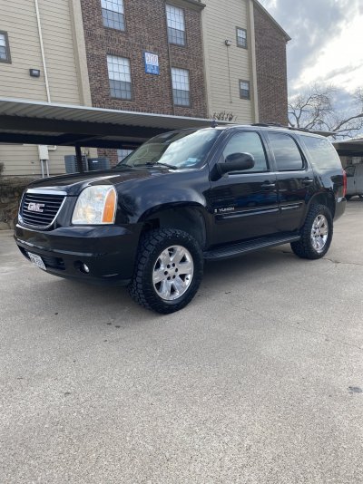

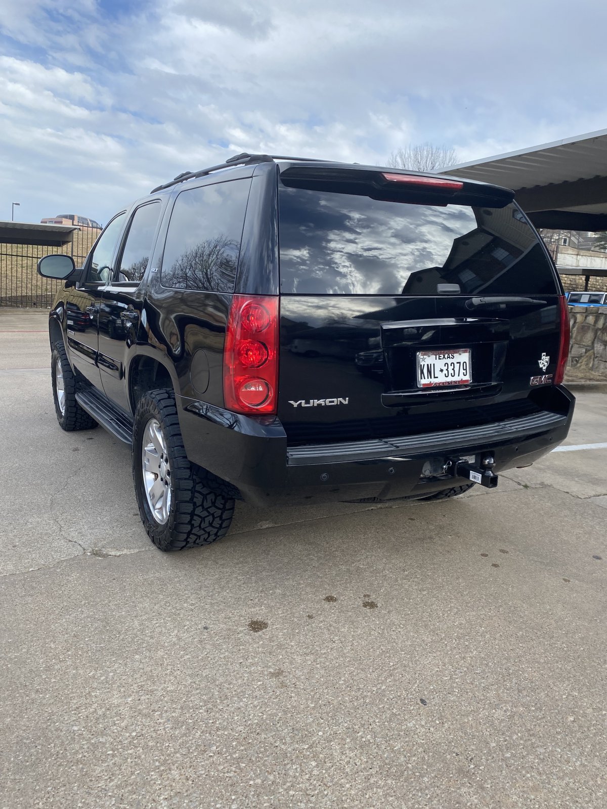

I bought Supreme Suspensions - 2.5" Front + 2" Rear Lift spacers and tried my hand at that. I definitely got more than I bargained for with that. YouTube videos were great until that one ball joint didn’t separate after tapping on it.. and then beating on it.. and then prying it.. Eventually, I got it and I was really happy with the height.. at first
So I did what anyone would do at this point. Jumped up to 33” tires. (I also got Rough Country 3” UCAs)
Looked great until you saw (or heard) me take a right turn. Or a left. I did some minor cutting and added a small wheel spacer to help the fit.

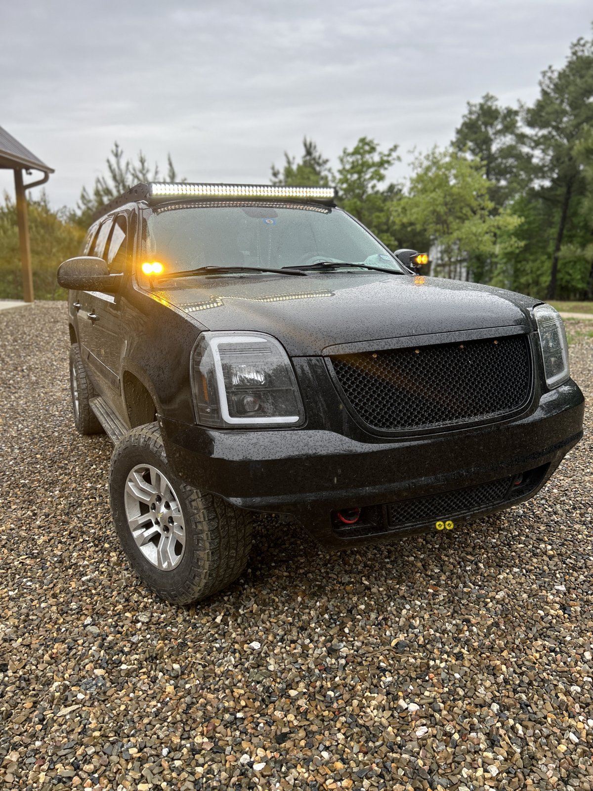

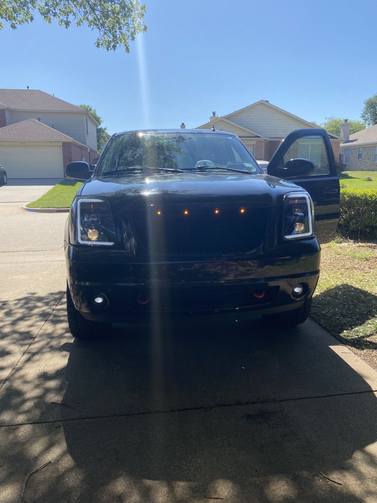

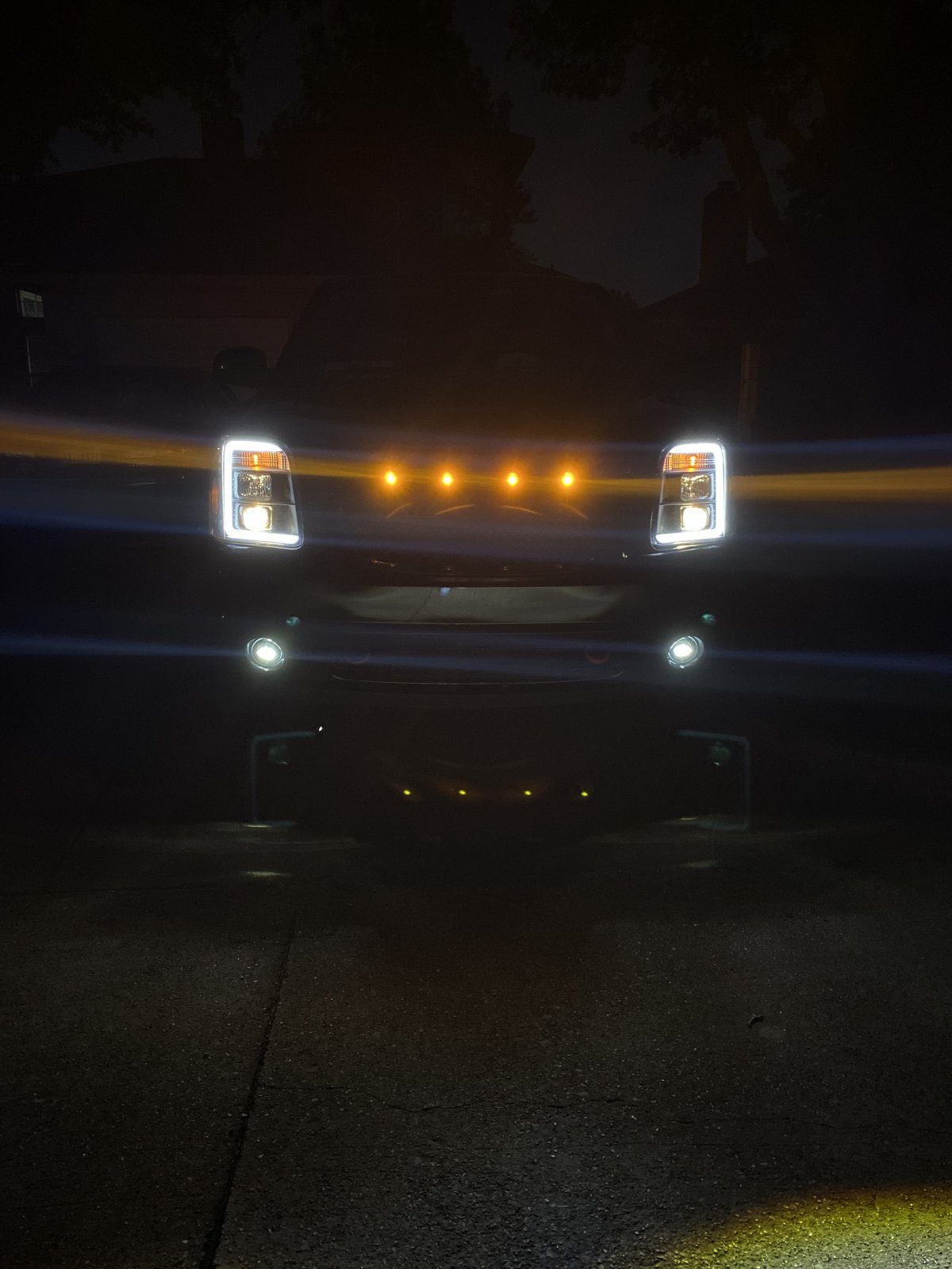

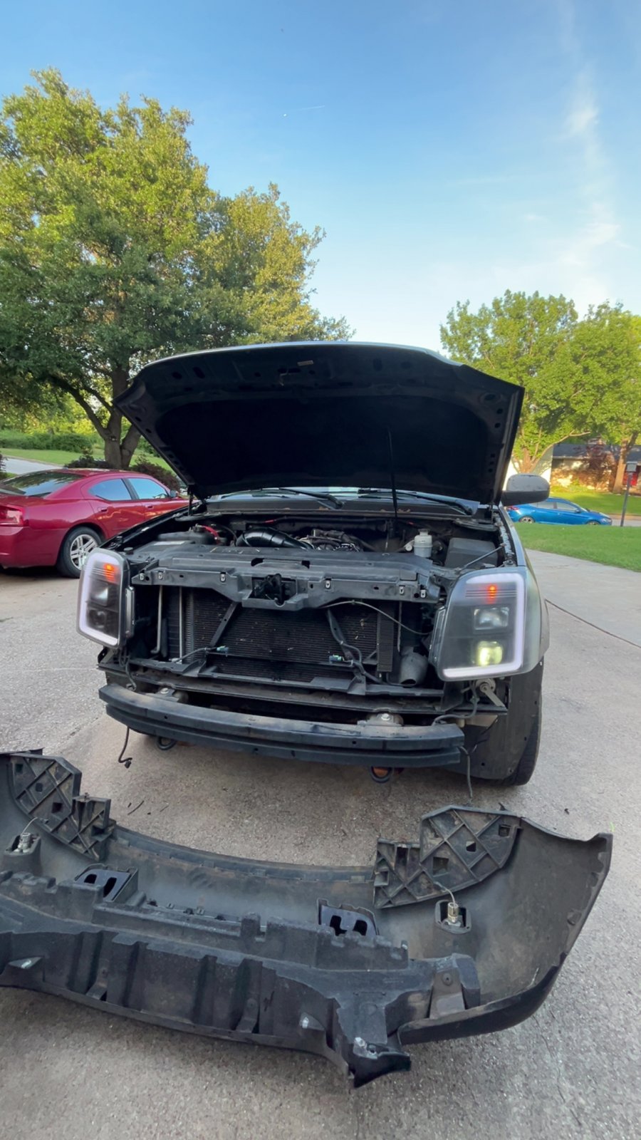

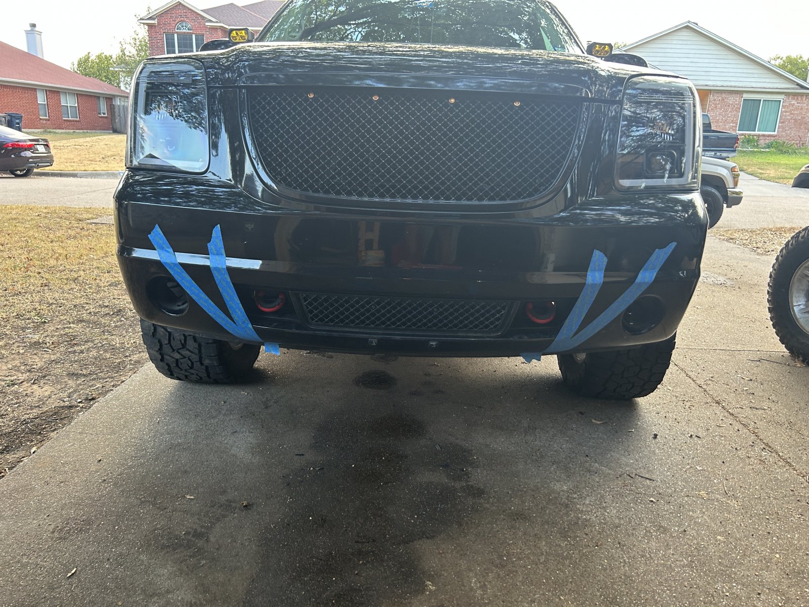

I wanted to make the front end look different since I wasn’t necessarily loving the stock grille or headlights. So I started searching for different modified Yukon front ends.
Peter Clark’s (Baseline Overland) build was/is a large inspiration because there aren’t many off road style builds out there for the Yukons. (So I thought until I found the TYF). I wanted something sleek but also aggressive (similar to a Raptor with the LED DRLS and grille lights).
Unfortunately, while I was waiting for the new headlights to come in - we were moving. I was backing into the awkwardly slanted driveway of our new rent house and had to give it a little gas to get the front driver side wheel over the curb and boom. Ruptured several radiator/heater hoses.
Unfortunately, I don’t know how to post videos in here but just imagine “ground - puddle - *camera pans out* - trail of liquid going out into the street and back into the driveway”
Nearly $1,000 later… my upgrade/fun funds were low and with higher rent, my budget build was on hold.

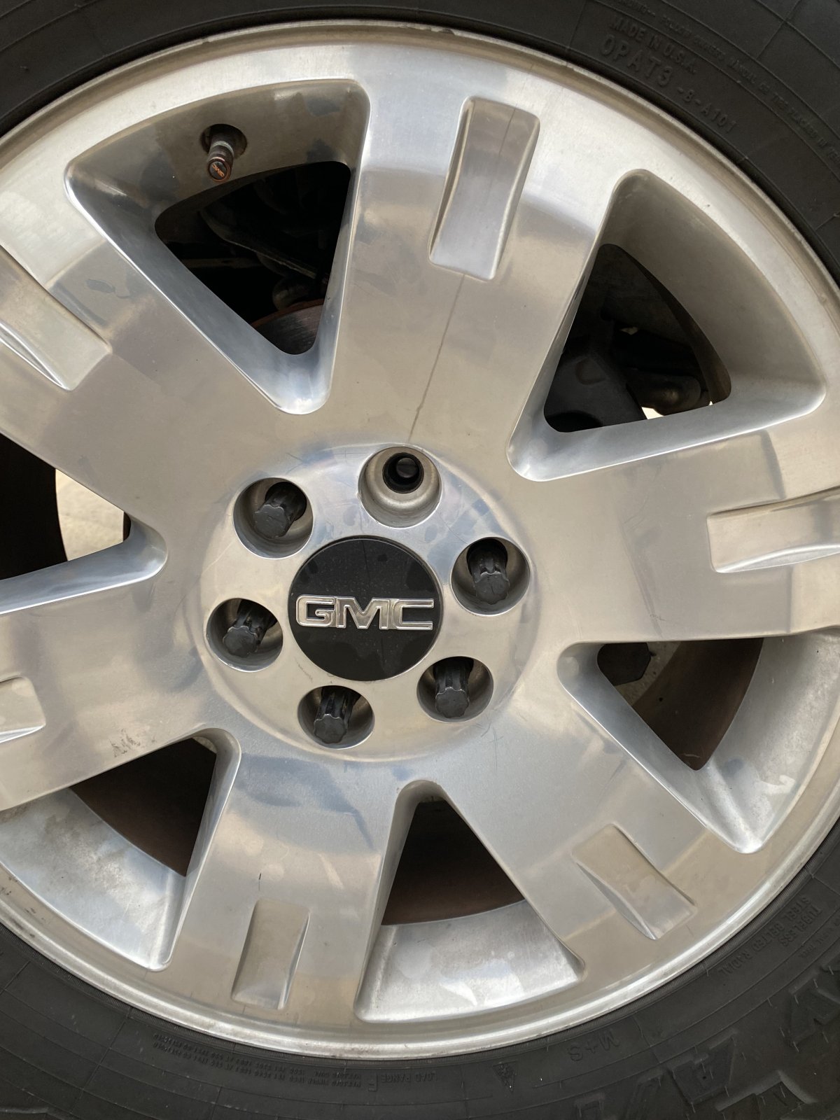

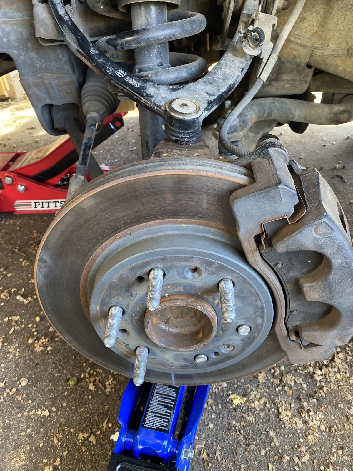

Before I could really research and figure out options…. Driving home after an alignment and tire rotation, I felt heavy pulling and rough rolling on the front driver side. 68402593534__C33FE00E-620B-48CD-989D-208DD7DDB669.jpeg68634968516__10179F87-C4D4-406F-B0A4-CBAFCB339F93.jpeg
Either the cheap ass spacers I had were causing strain on the lug bolts or Firestone didn’t tighten them to spec after.. Betting both because this would not be the last Hub to go down like this.

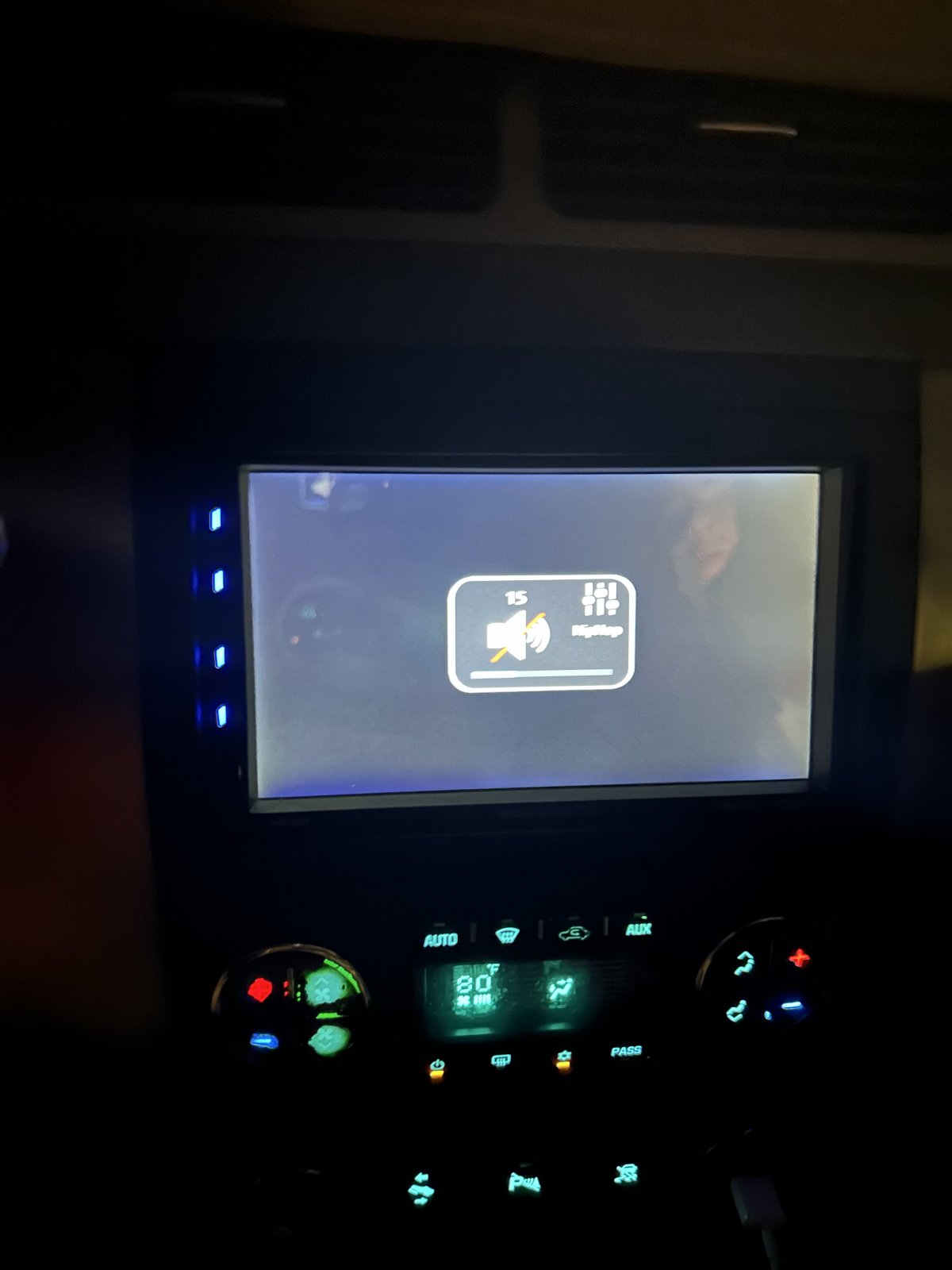

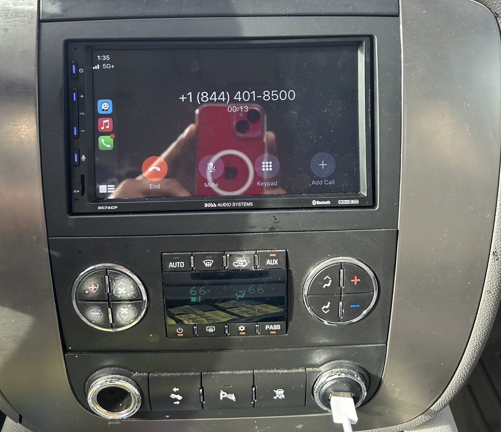

As a Christmas gift and early birthday gift, I get a couple hundred dollars to go toward an Apple Car Play system. In my excitement, I start looking at how to do it myself (to save money of course) but my friend encourages me to check out CarToys and try them because electrical/wiring can be challenging.

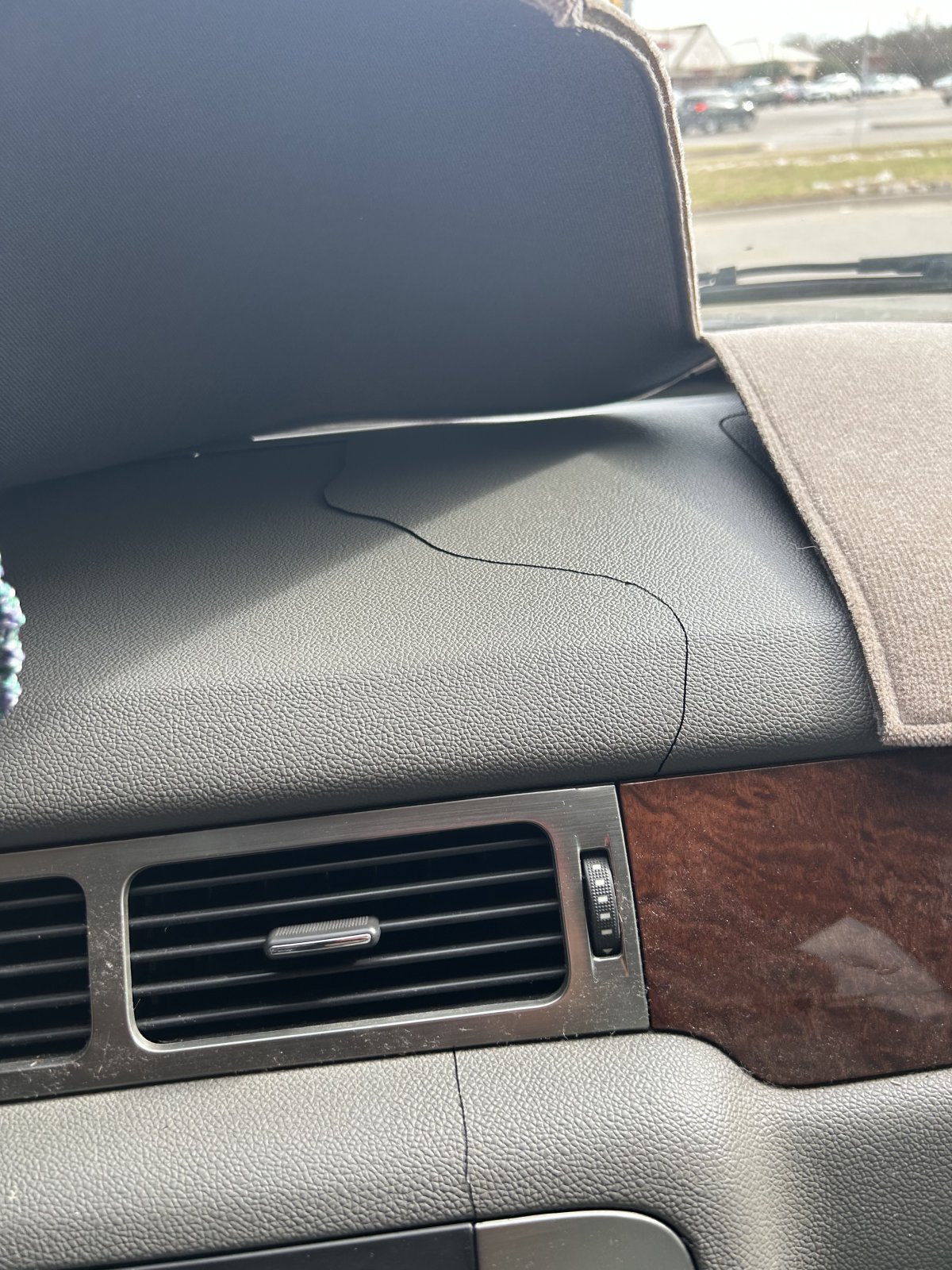

I’ll be dammed if it wasn’t one of the worst experiences I’ve ever had. First they installed the wrong system and the wrong controller so none of my steering wheel buttons worked. I took it back and the swapped it out… and then $1,100 later..
They cracked my perfectly mint dash. The clips that hold my AC/Thermostat controls on the right side was completely broken off so it no longer sits flush… Dash peice around the radio was cracked and then a massive crack going from above the left passenger vent all the way up until the windshield vents where the grates were cracked and rattling.
Another company who, when you sign the agreement for the services to be performed, you waive their liability for anything but what they are installing. They said “nothing we can do about that

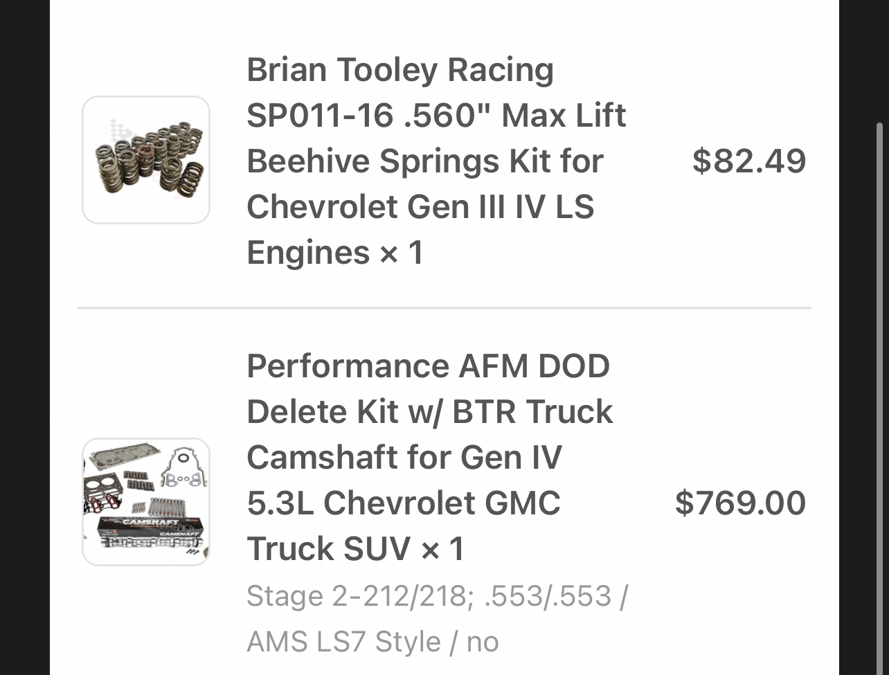

Coming off of that win, I decided to fix the lifter issue myself and order a Texas Speed DOD delete kit with a stage 2 BTR cam and upgraded valve springs.
In hindsight, I should have forgone the springs and when with an upgraded oil pump but.. you live and you learn.

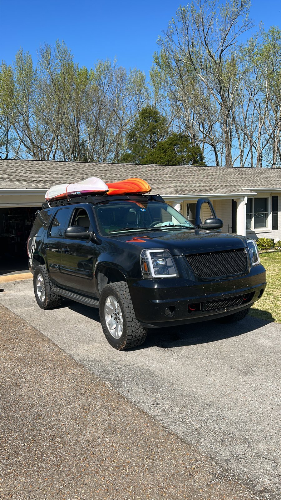

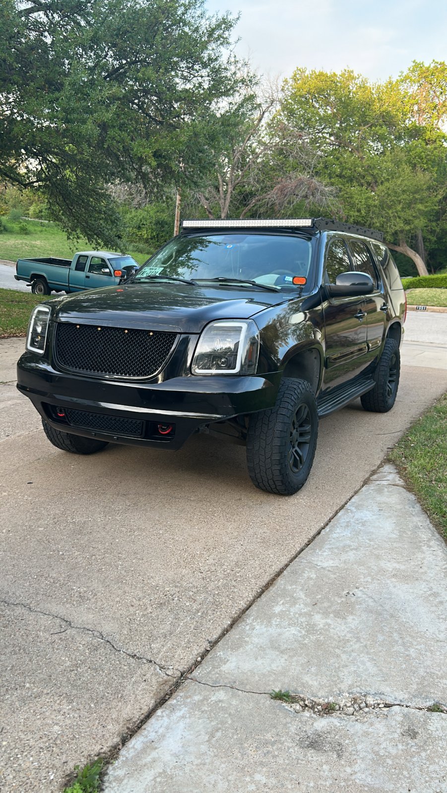

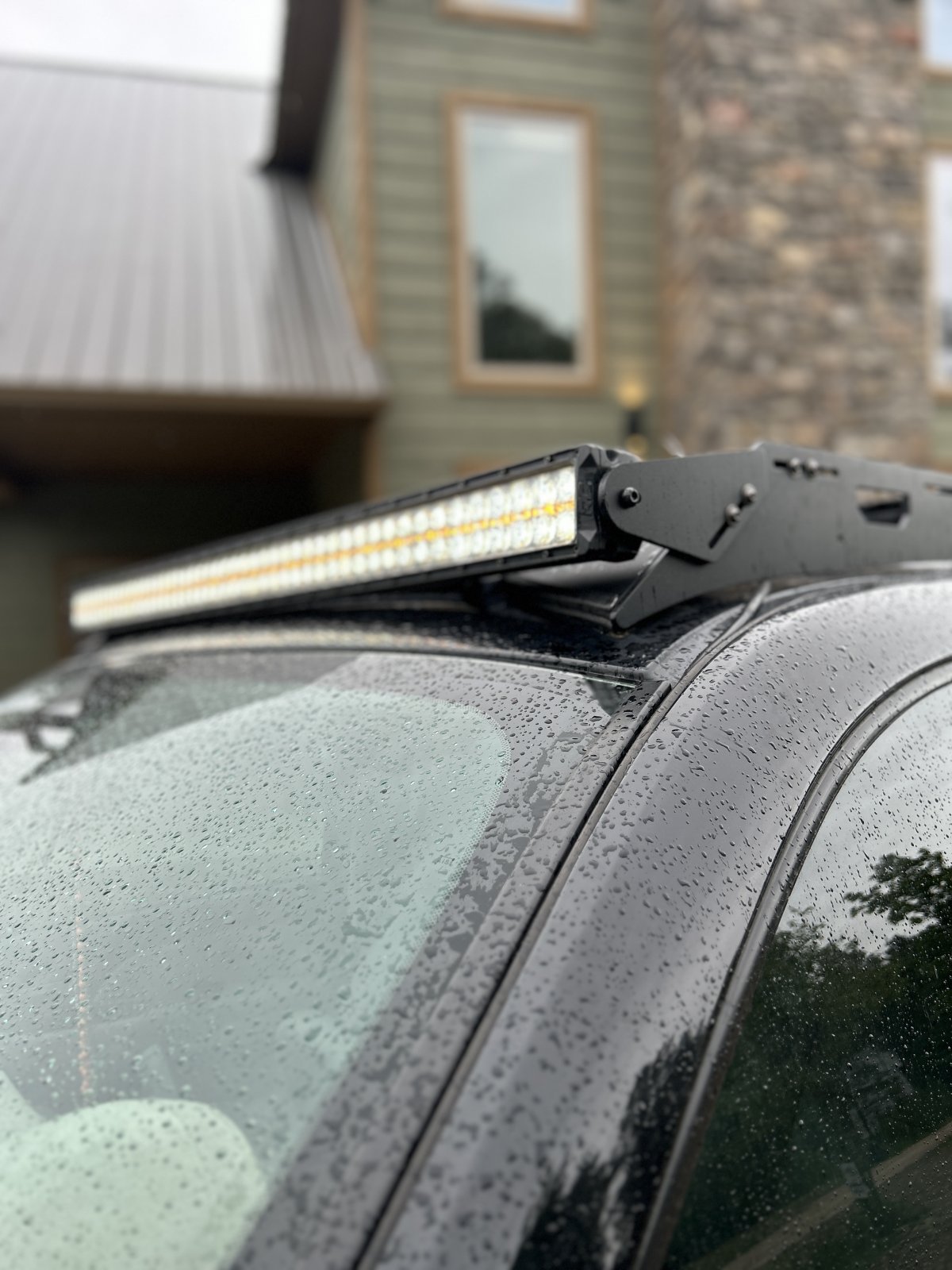

While I was waiting for those.. I managed to secure a Baseline Overland roof rack (shoutout Peter Clark #2) and some GGLighting GP20 pods as ditch lights. IMG_9513.jpeg43BF20E4-3B45-454B-99F8-FF54DAEB7B27.jpegD3994F73-8512-49A3-8CA7-C0302B3AAED3.jpeg
I put the roof rack to use immediately and went on a couple trips.
May not have a roof top tent or a bunch gear, but I threw a lot on there and man does it hold up well. Plenty of tabs and tie down locations.

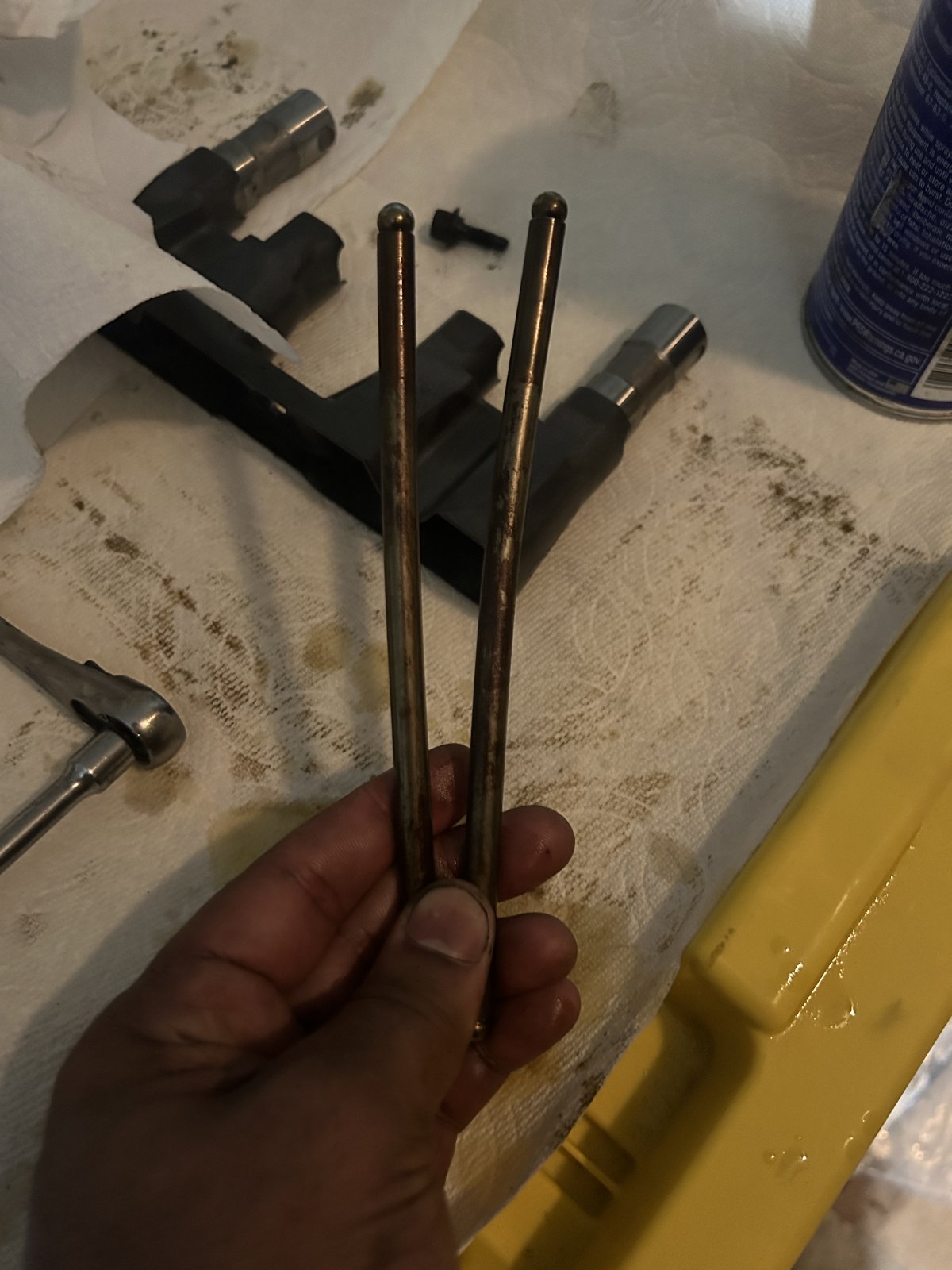

On the way back from the last of the trips post roof rack and rear spring upgrade, I finally had lifters fail. Trouble codes were up for two cylinders so I had to get the Yuk the rest of the way home and get started on the repair.
During teardown, I inspected everything to look for wear or damage but, surprisingly, I only had one (yes really) bent push rod.
How nothing else was damaged, I don’t know man.. just counting my blessings and moving on.

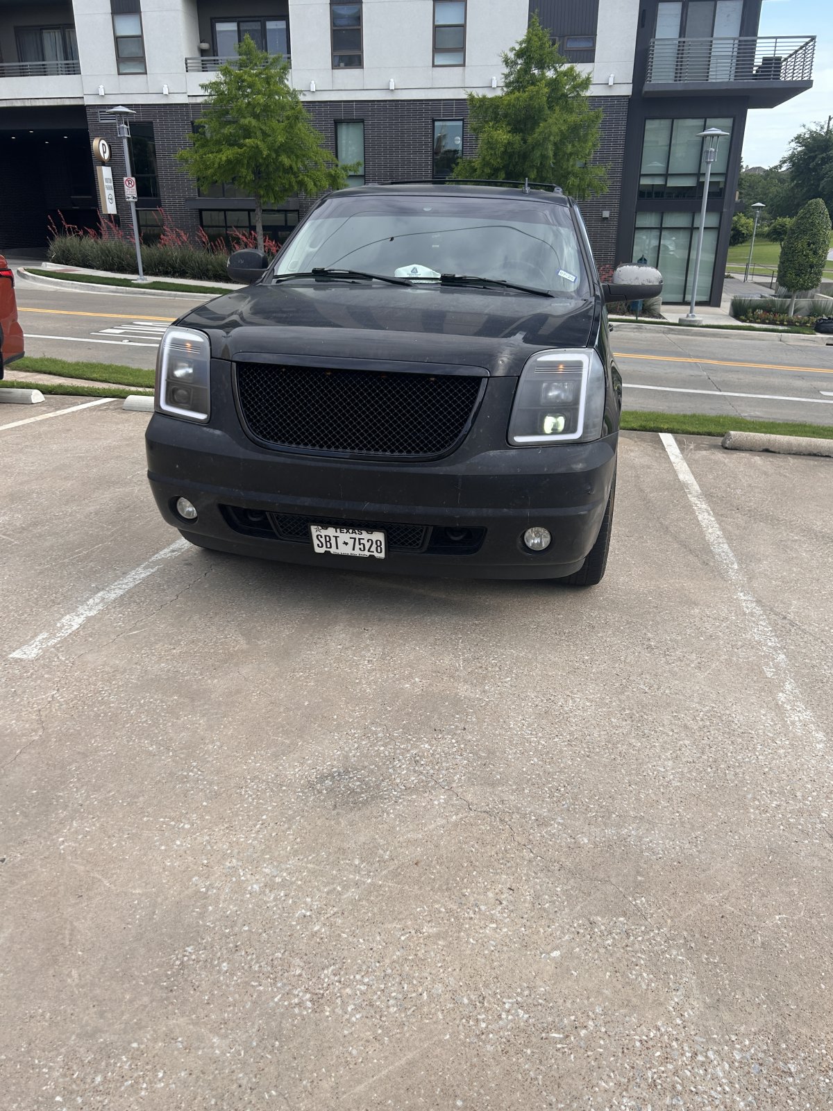

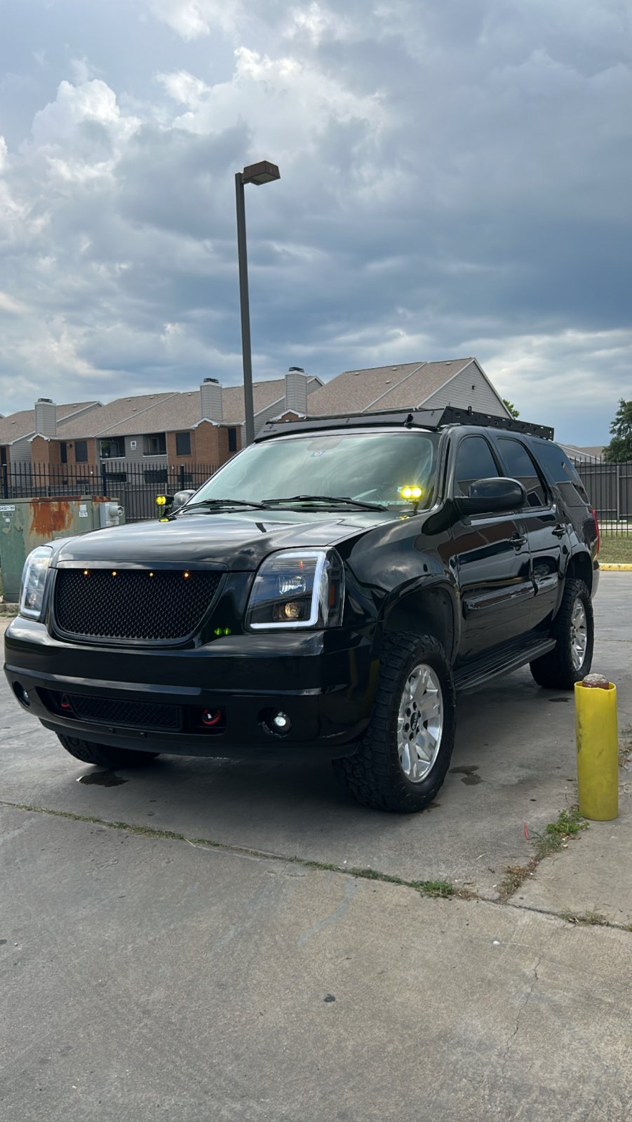

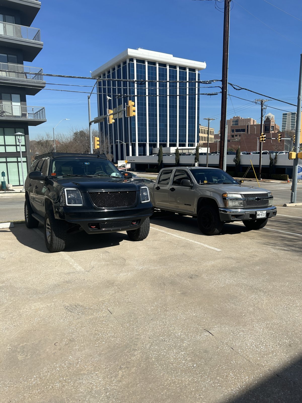

I had been experiencing some serious rubbing on the front side of the wheel well at full turn. Couldn’t justify and too impatient to save the money for a new bumper so.. I cut mine.
The cut came out pretty nice. Almost a “prerunner” look.
The new look along with my buddy (who has a 1st gen RWD Colorado) really started to get me thinking about a prerunner build since this Yuk was not 4WD. Still in denial.. I started researching a hybrid set ups. “Prelanders”

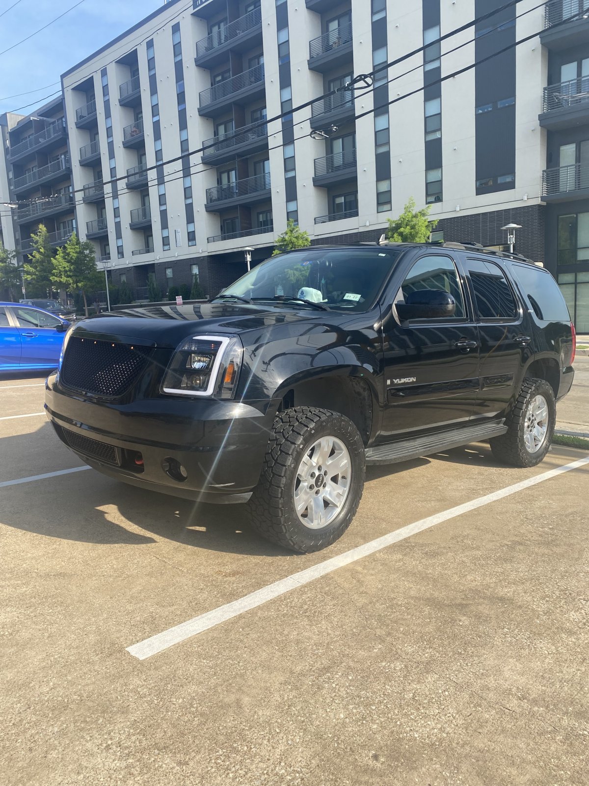

From here I went through different random repairs, failed starter, alternator, battery, oil leaks, ANOTHER HUB WITH BROKEN LUGS. All fixed.
Cut my fun stuff savings down but the irresponsible me was itching so.. drawing inspiration from this dude was a sick obs Silverado on Instagram (@logan__william) - I got a rough country light bar and Baseline Overland rack light bar brackets.
Loving where I was at this time.

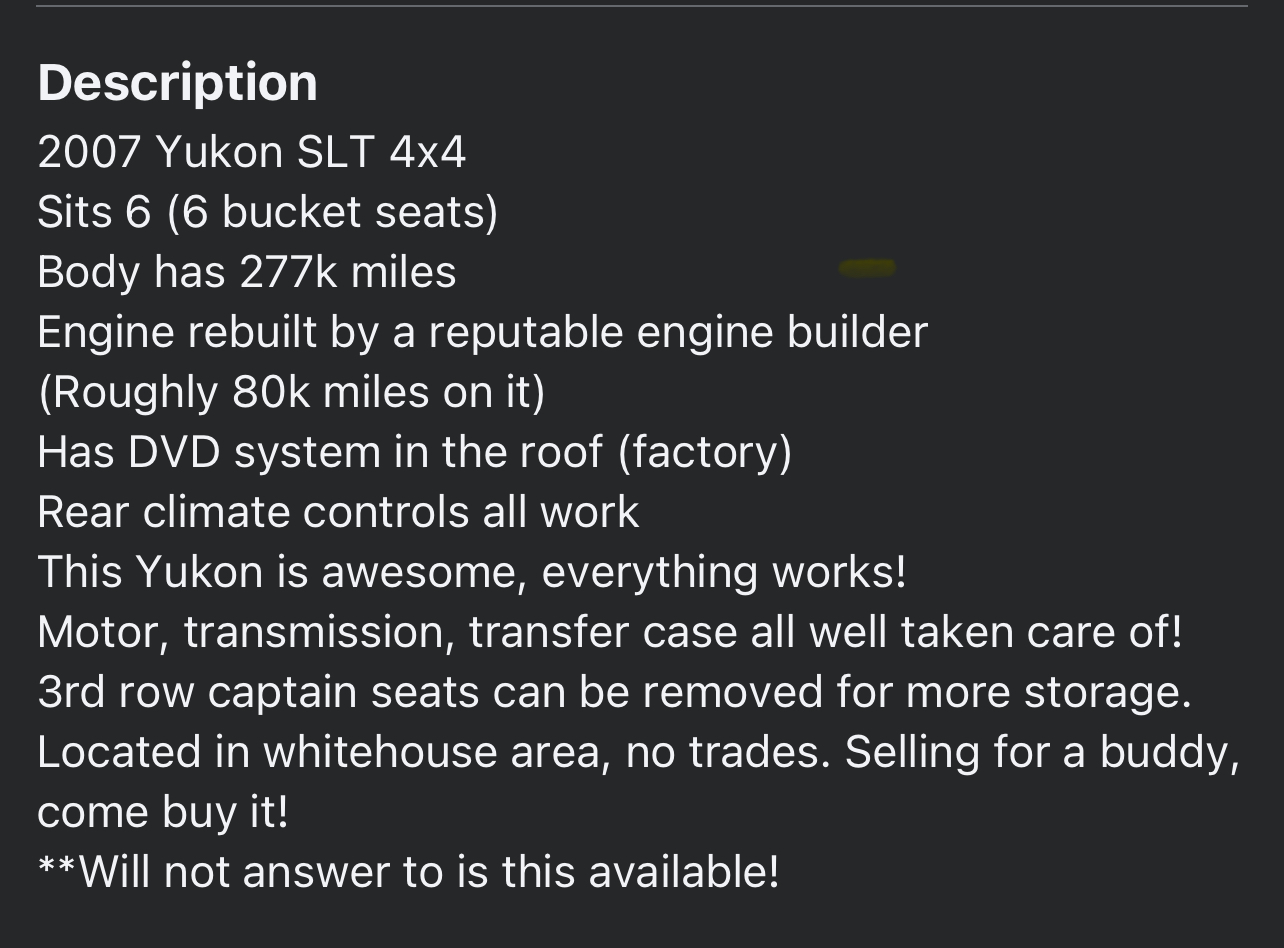

Found a solid deal on one that was 4WD and the motor was completely rebuilt from the block up and included the DOD delete and tune.
So I started the buy process.

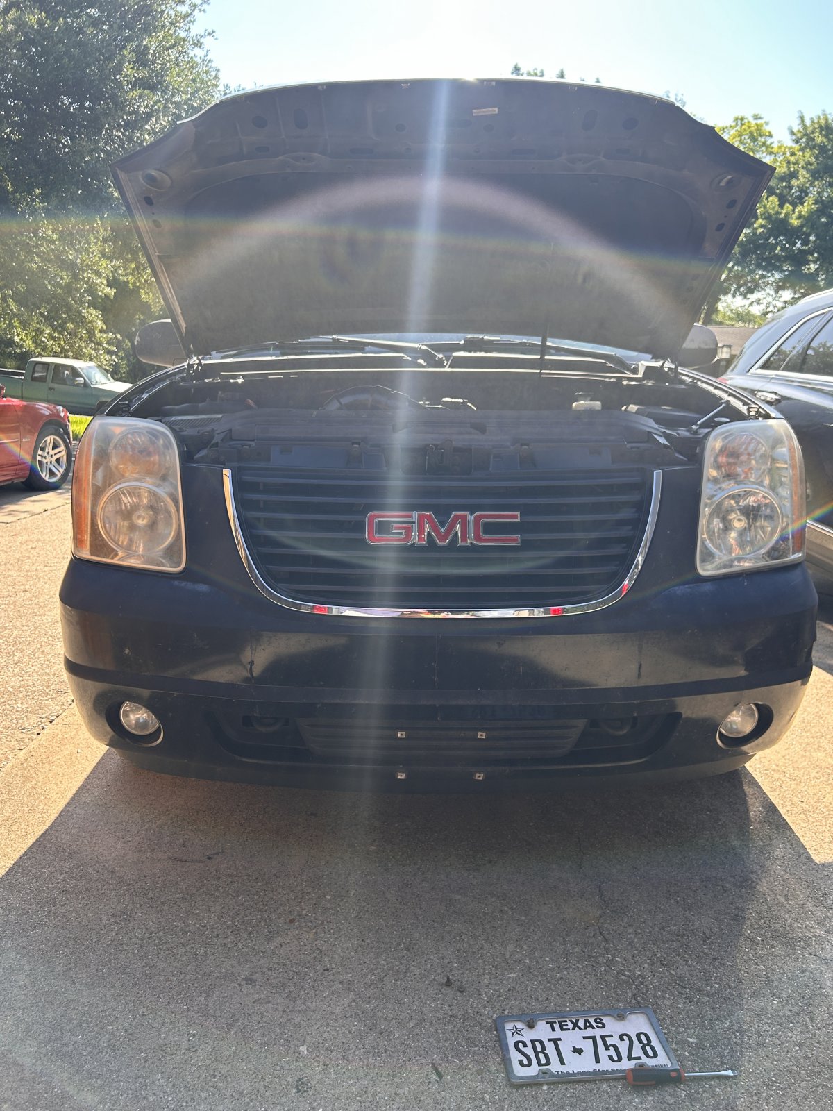

BUT WAIT - while going back and forth with seller… I took another look at the Yuk. Popped the valve cover off and had my mechanic’s stethoscope out and sure enough, I found the issue.
One of the rocker arm bolts had just popped out. So it was clattering around as the push rod moved. After inspection, nothing was stripped so I ratcheted it back down. Torqued it to spec (plus a quarter turn). And all was well.
Except, I was already committed to this other Yukon.
I found out that the mechanic who did the work on this actually did it while he owned it.
  • 799 Heads
  • New crank
  • New Injectors
  • New Cap
  • DOD delete with BTR Stage 2 cam
  • Tuned

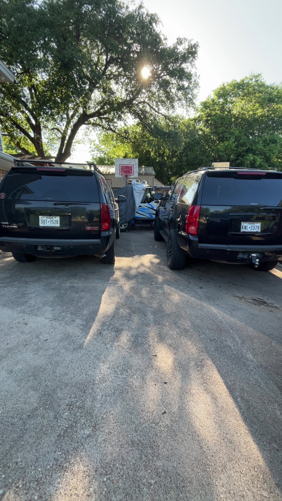

And it’s a 4WD.. which the seller just serviced the whole system last year. Did all the researched and verified what I was told.
So I went and picked it up. Hello, Yuk 2.0.
