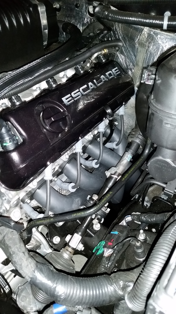

started on headers today. Should finish up tomm

^ interested in how easy/difficult they are... i'm thinking about a set

its pretty easy the 5.3 and 6.2 have room. I hava feeling the truck will be way to loud. I have a big resonator. we shall see soon

headers installed. the pipe clamp they give i didnt like i will be welding it up this weekend on the y pipe. Other than that sounds better and pulls harder for sure.
