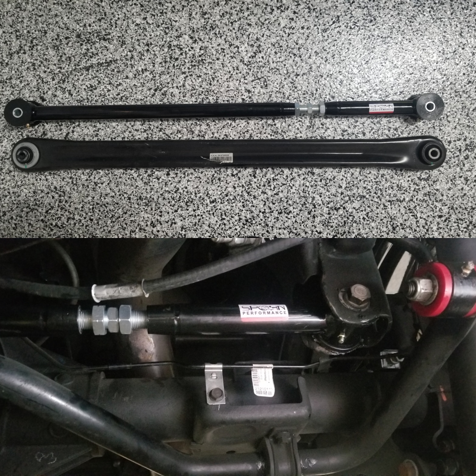

Time to start hitting the rear suspension on the Escalade. Took the flimsy oem panhard bar off and replaced with the adjustable @spohnperformance adjustable pangard bar. I am a distributor for all Spohn items so if you want to save some $$$ on anything they make just give me a yell.
Also this will fix the offset rear end when you lower the gm suvs. On any 00 to 19 gm suv the lower you go the more the rear end gets pushed to passengers side. This fixes that plus a much stronger replacement.

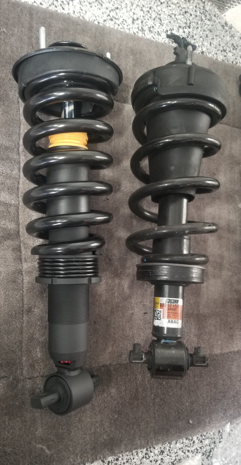

Kw coilover vs the stock magride strut. I adjusted to 11 compression and 7 on rebound. Way better ride. Only thing is that eacalade sits about 1.25 inches higher then before. Ill drive about 200 miles and then adjust the height. Its adjustable up to a 3 inch drop
Currently front is only available with rear kit but working with belltech and front i will offer by itself
