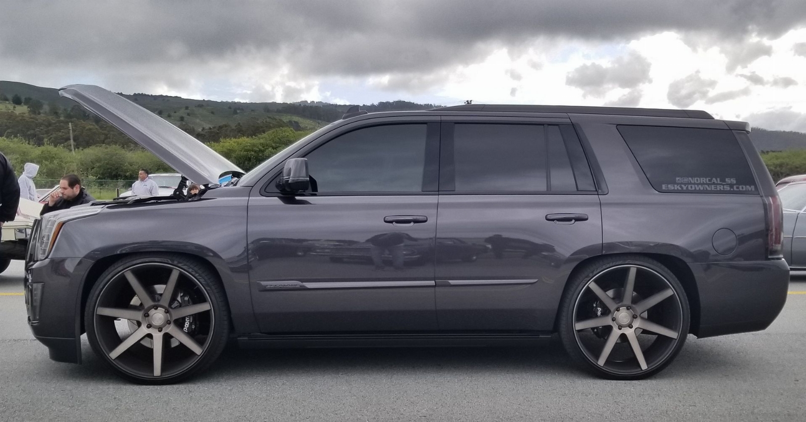

Starting a 416 build. :)
I got the truck out of the shop last week and had all the chrome colormatched/tinted front/rear/3rd brake light and also had them color match the top portion of the escalade tail lights since i hated the look

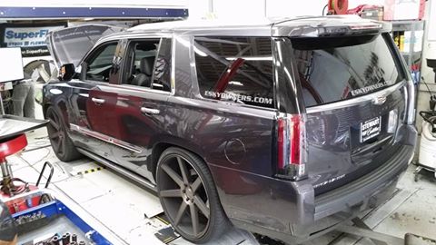

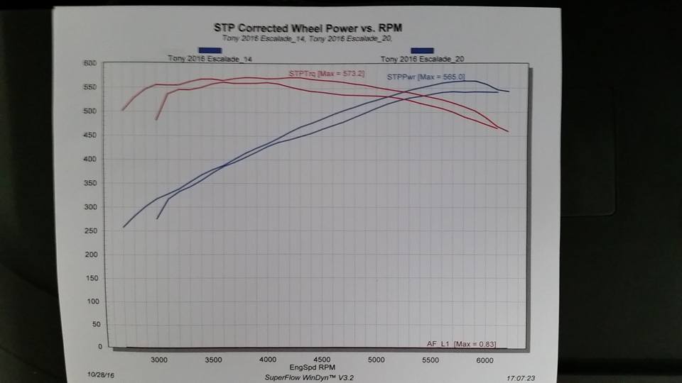

WELLLLLLLL my Whipple 2.9 Escalade making more power :) Very happy with numbers. 7.5 psi/91 pump gas/ARH Headers/3.5 MagnaFlow cat back/z06 fuel pump/fuel line mod and @gptuning tune. 565/573. Old run was 543/566 with 6.5 psi. What peak numbers don't show is mid to top end 20 to 30 rwhp/rwtq increase. We let off the run early that's the dip at end. I'm a full Whipple dealer and if your interested in a kit give me a holler.
Oh I'm also a Alky control dealer and so I have a meth kit coming. Goal is 600/600 at wheels at 7.5 psi with no internal mods....on 26s lol
I'm almost done with this project and its been fun.

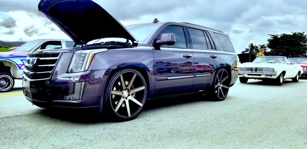

Ok so I decided to give this picture a little edit and I think it's my best one so far. Please let me know what you think about it!

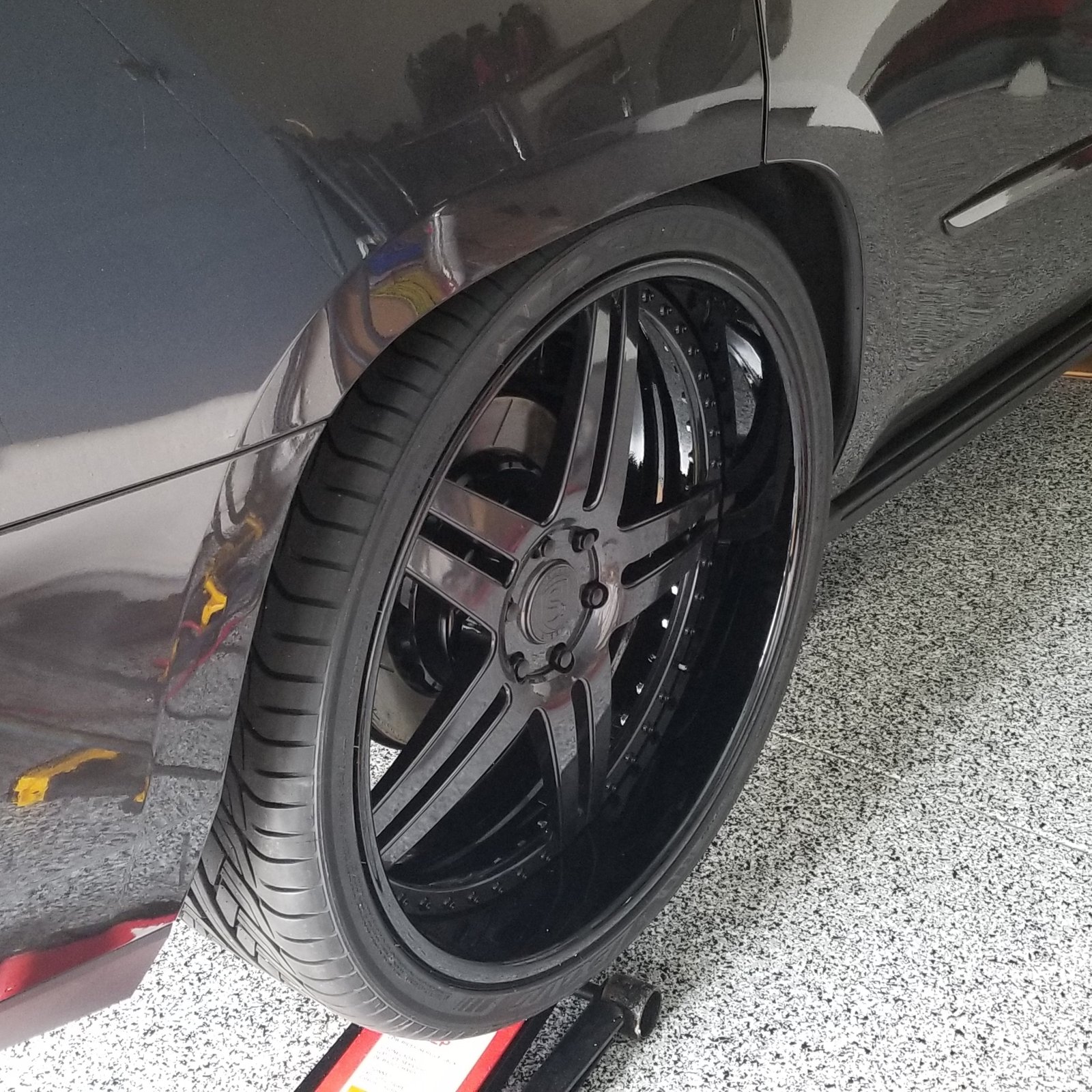

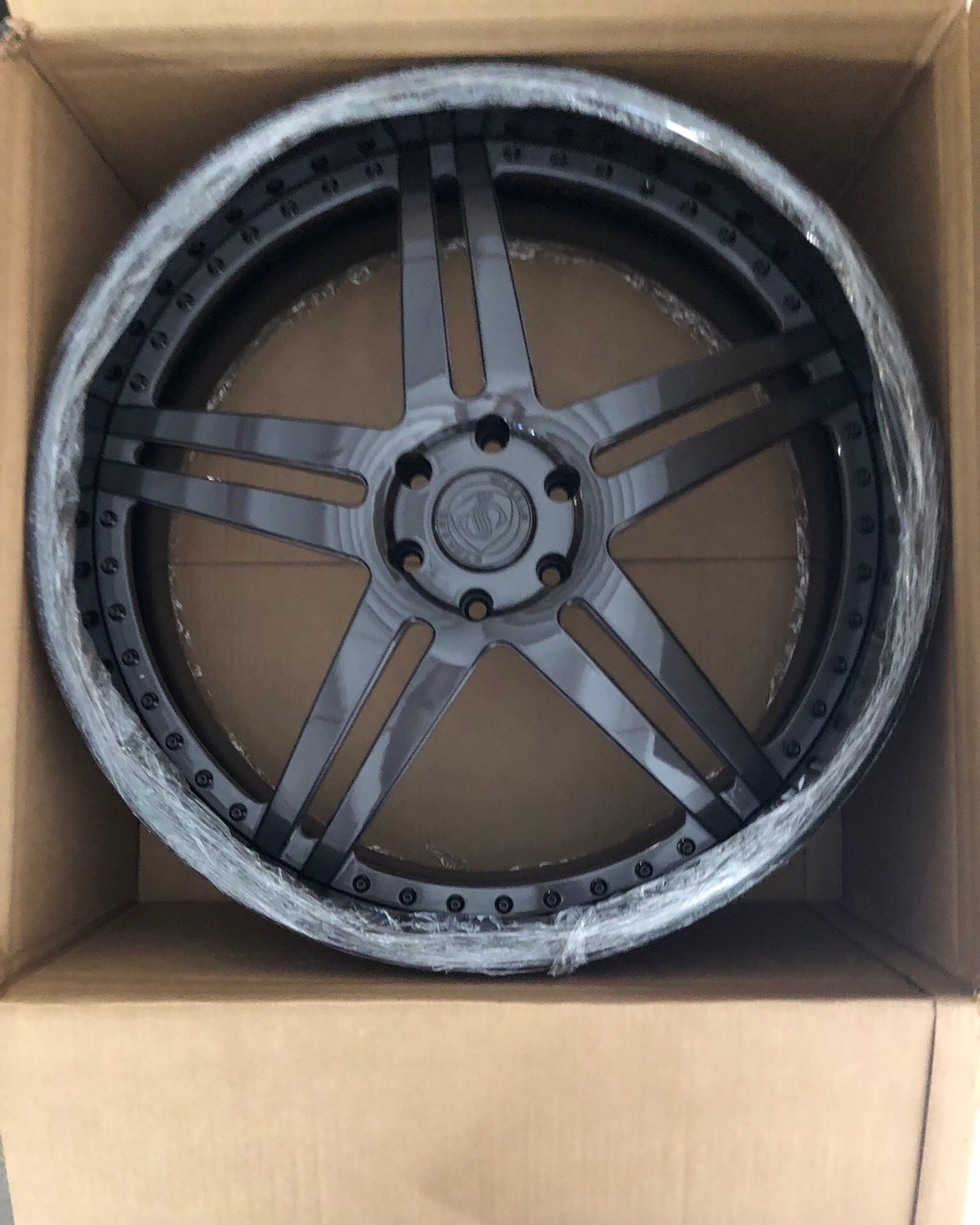

Well new rims are here. 26 inch 3 piece strasse forged. I will be doing same 295 30 26 front but resr 305 30 26.... my new 416 stroker should be here next week. 1000hp will be fun.

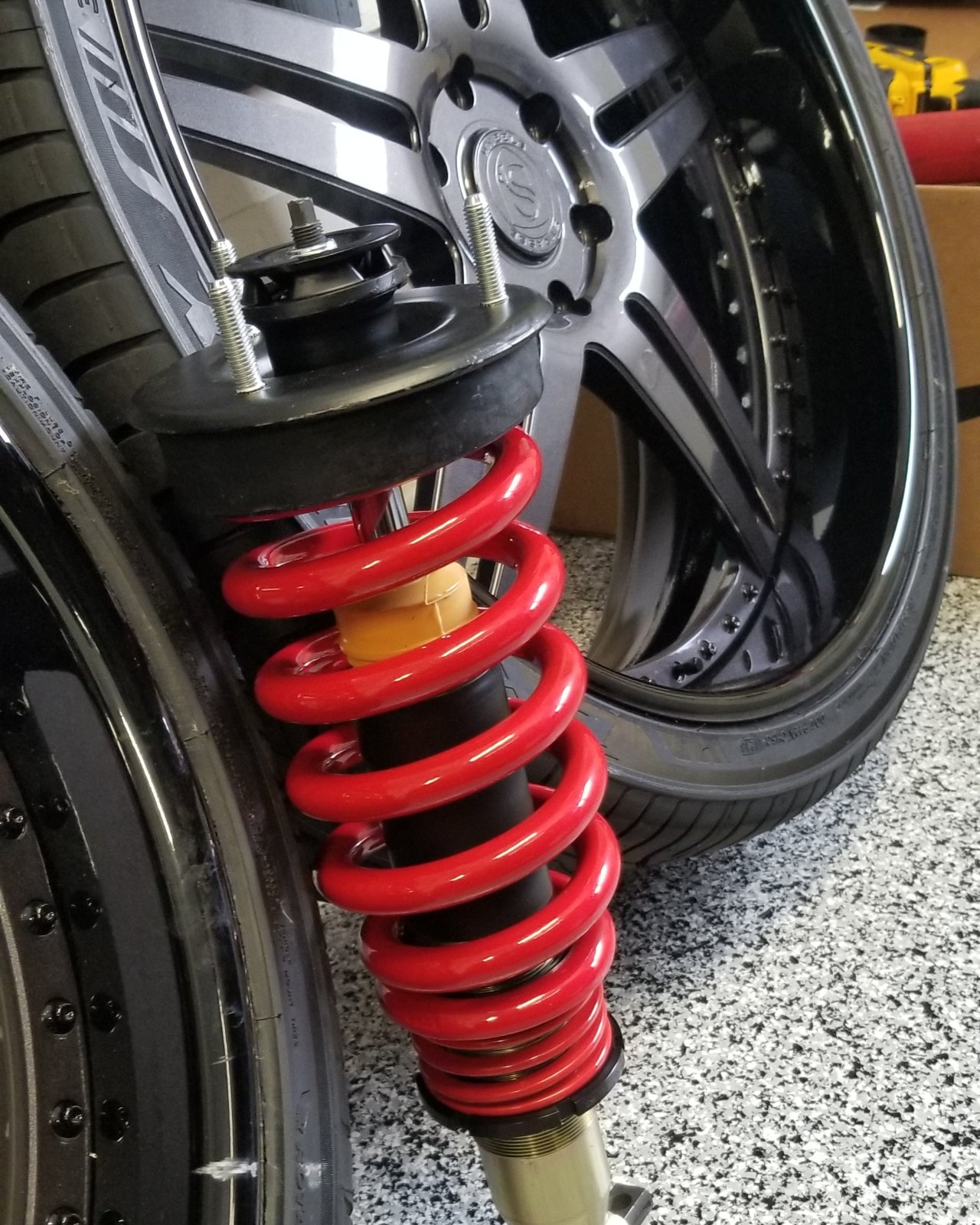

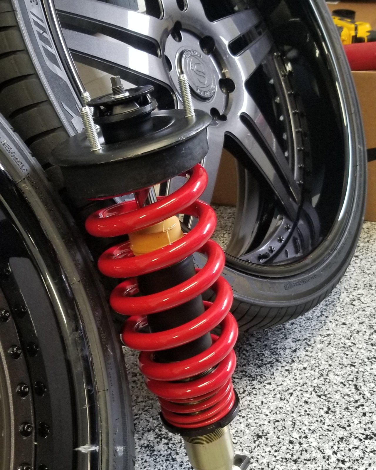

FINALLY HERE!!. I will be testing the @belltechsporttrucks coilovers for all 07 up gm suvs. This is a double adjustable combo and for magride 15 up vehicles i offer the bypass kit.
The rear shocks should be here in 2 weeks which is also double adjustable and due to my ties to belltech I will have the best pricing around.
Due to my ocd I will be powdercoating the springs black and body black also.
