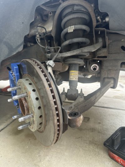

I decided to replace the outer tie rods ends because the boots were looking worn. I replaced them with the MOOGs and while doing it, saw that my inner rods were toasted as well. So then I had to order some MOOG inner ones and replace those. On to the alignment shop next.

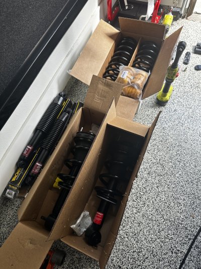

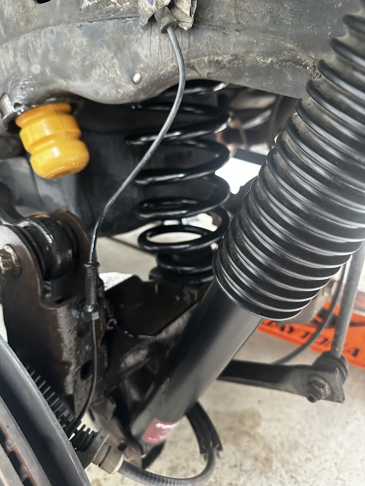

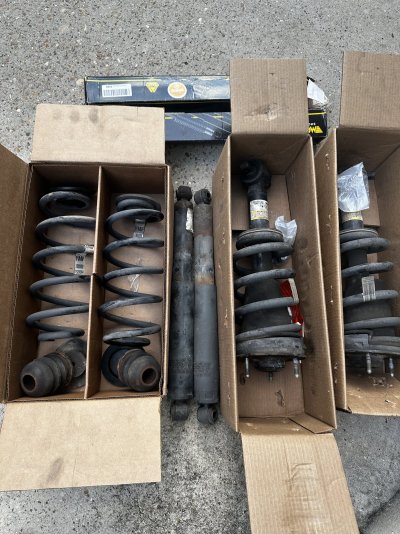

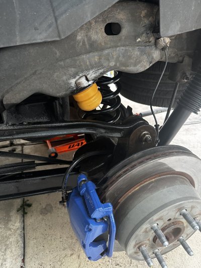

I finally changed out the front struts, rear springs and shocks and bump stops. I converted it from PPV to a civilian suspension and it raised the car 2-3 inches for now. According the to the wife, the ride quality went from 2/10 to 9/10 with the new suspension and tie rod ends. The steering wheel is super firm and tight and the car soaks up the bumps. Took about 3 hours to do (cleaning every old surface with a wire brush and brake clean)and no spring compressor was needed.

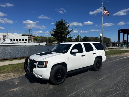

Road tripping from Houston Tx to Door County Wi. Stopped in Hotsprings Ar and Peoria Il on the way. Hanging out in Door County for a few days and then heading back. The car feels awesome with the civilian suspension.
