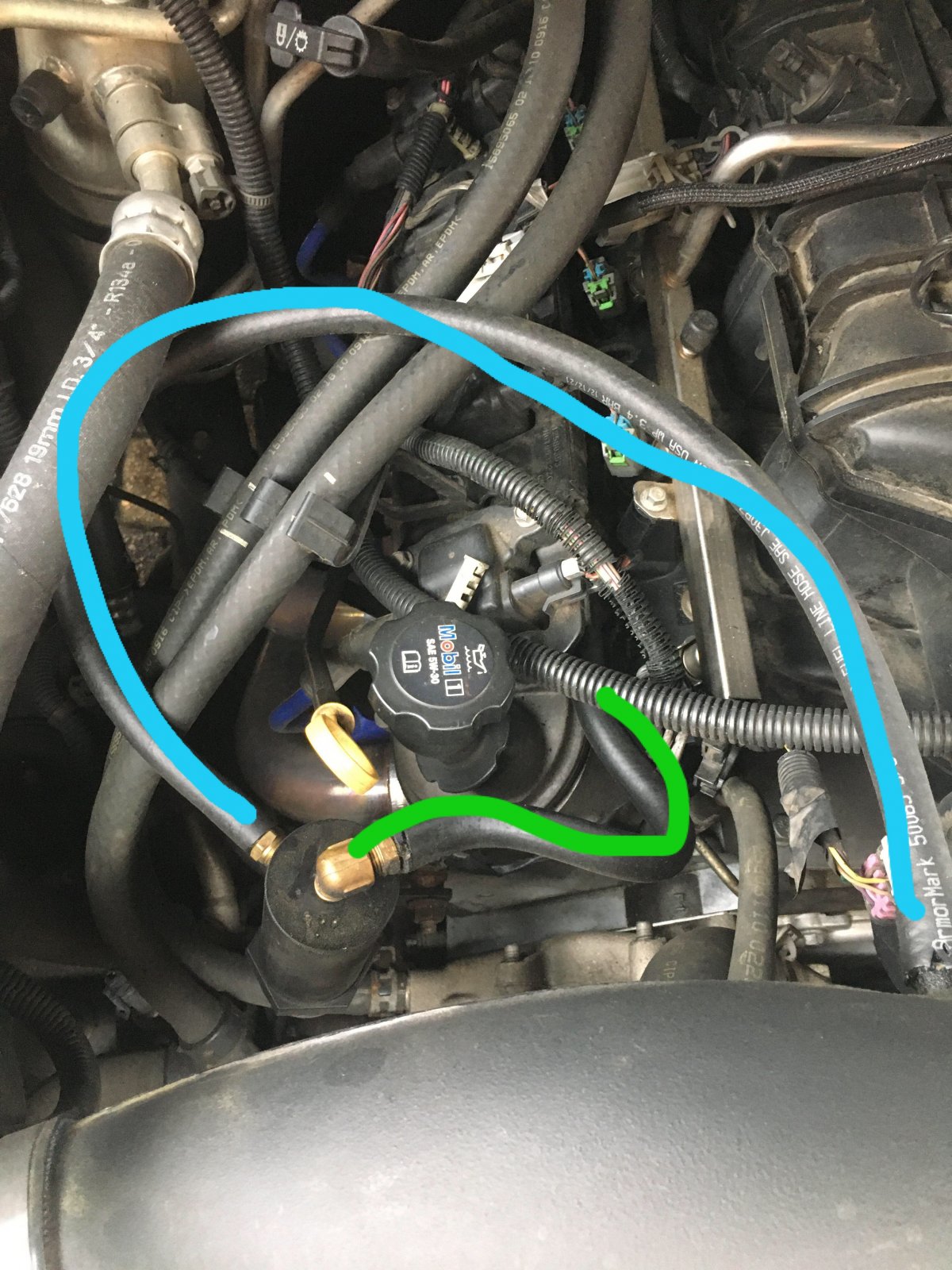

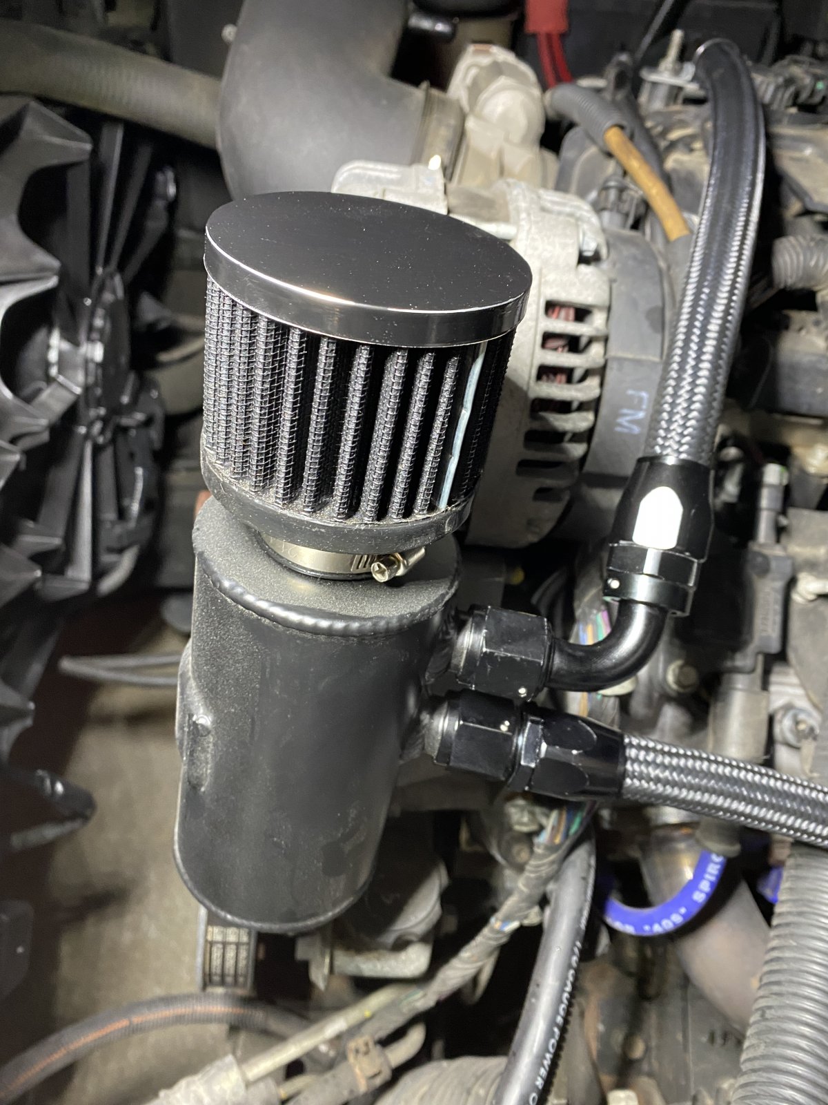

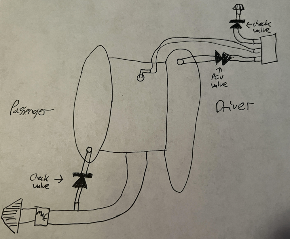

Also finally caved in and got a fancy catch can. After talking to the Might Mouse owner at LSfest two years in a row and asking all kinds of questions, I got the gen 5 XL can with -10AN fittings.
Let's call this PPV PCV rev. 4 and final PCV configuration. I love this, it works, its easy to drain and observe oil level and combines everything my rev. 3 setup did into a clean package with additional capacity. I feel likeI've made a string of good decisions to dial this PPV in up to this point now, things are looking pretty good!

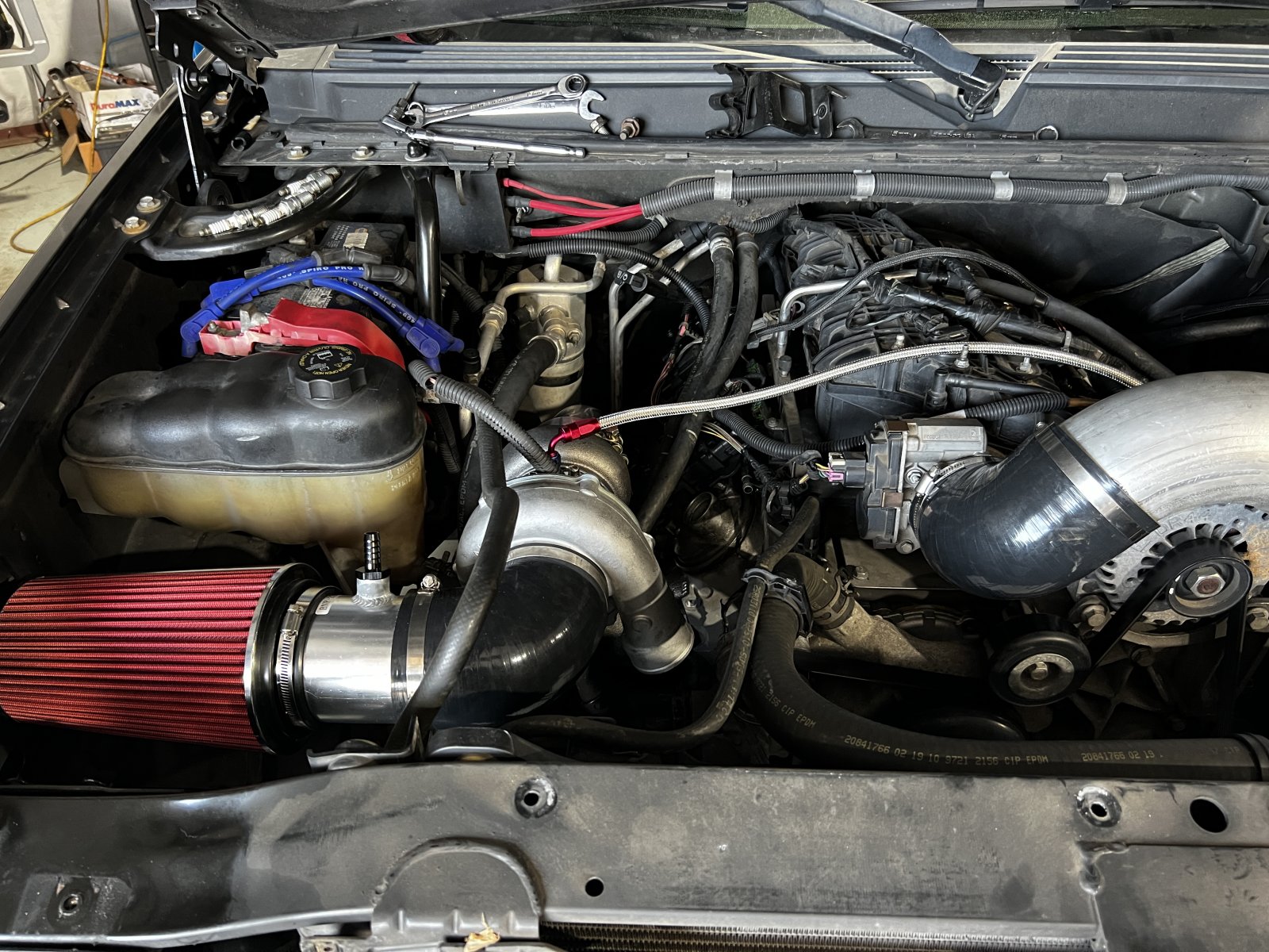

Its now July 2023, been driving it for a few months and partying with this little 62mm turbo. It's on spring pressure at about 6-7psi at this point and I am racking up miles as much as I can and saving up my pennies for a regear and trutrac. Unfortunately, I start hearing a tapping noise and dig in to investigate. I got these carnage pics to share, its a major heart break.

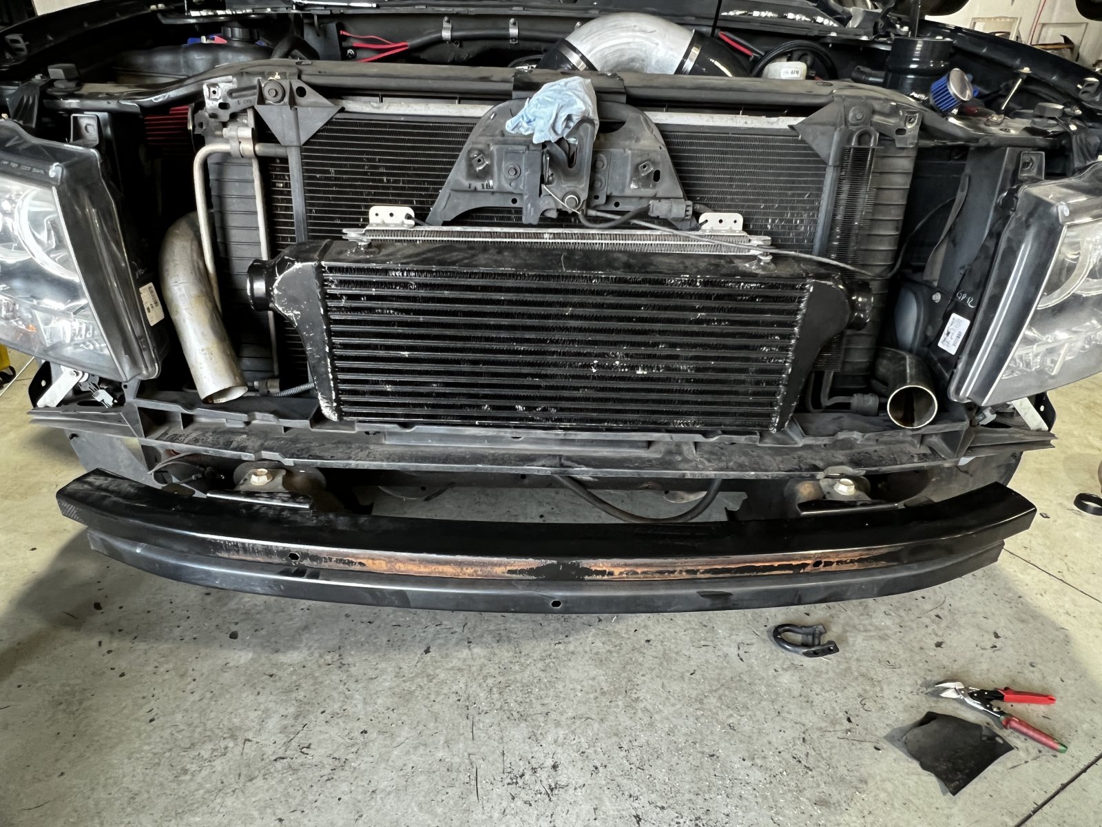

Also a good time to heat wrap that downpipe. This stuff really sucks to work with but its a big difference in under hood temps.
I also take a quick peak under the valve covers and make sure things aren't going sideways on me again. She's mint bud!

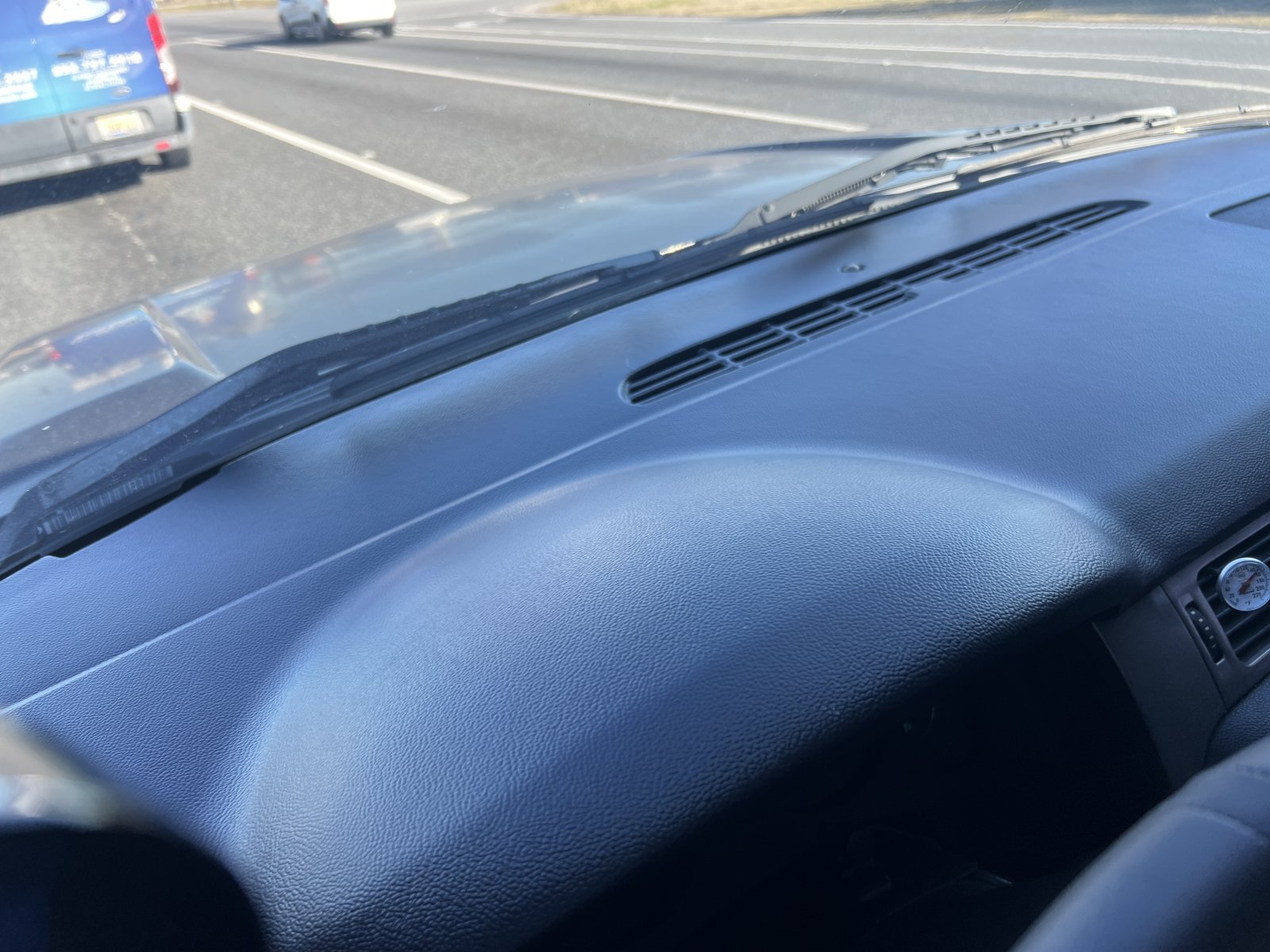

Christmas came and my wife...I mean Santa brought me some goodies. New Dashskin dash cover and headlights landed. She's seen the headache I've been through and also drives this car from time to time and wanted to get me a little something.
Like every GMT900 vehicle, the dash cracks. Luckily I had all the pieces still and plastic welded everything up to reinforce it the best I could before putting the topper on.
Installed and silicone setting up, I put about 20 books and tension rods on this thing to hold it down for 24 hours. The smell lingered around for about a week.
All cleaned up and out on the road, this turned out very nice. No more rattling!
