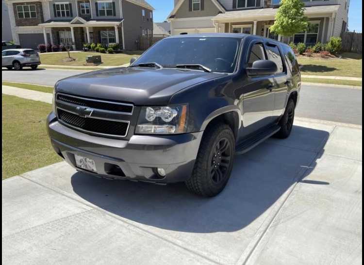

Hi, I am car enthusiast or perhaps a professional idiot. Either way, I have a 2010 Tahoe PPV and I wanted to start a build log to share with the class my journey with this vehicle and perhaps shed some light on GMT900 ownership in the good and bad ways. I believe the forum format lends itself well to a build log and while I have had the PPV for a minute now, its in a place where I want to share the process.
In June of 2021, I was having some issues with my daily driver. At the time, I needed something with a hitch and decent tow capacity. Having two dogs to haul around and needing a hitch makes an SUV a logical choice for me. I happened across a dark gray PPV that was in decent shape exterior-wise with a very clean interior AND an LS3 already dropped in it. This really scratched that itch for me to have something fun and unique to daily. With an LS motor even souped up should make for a reliable daily. Here it is the day I bought it and brought it home.

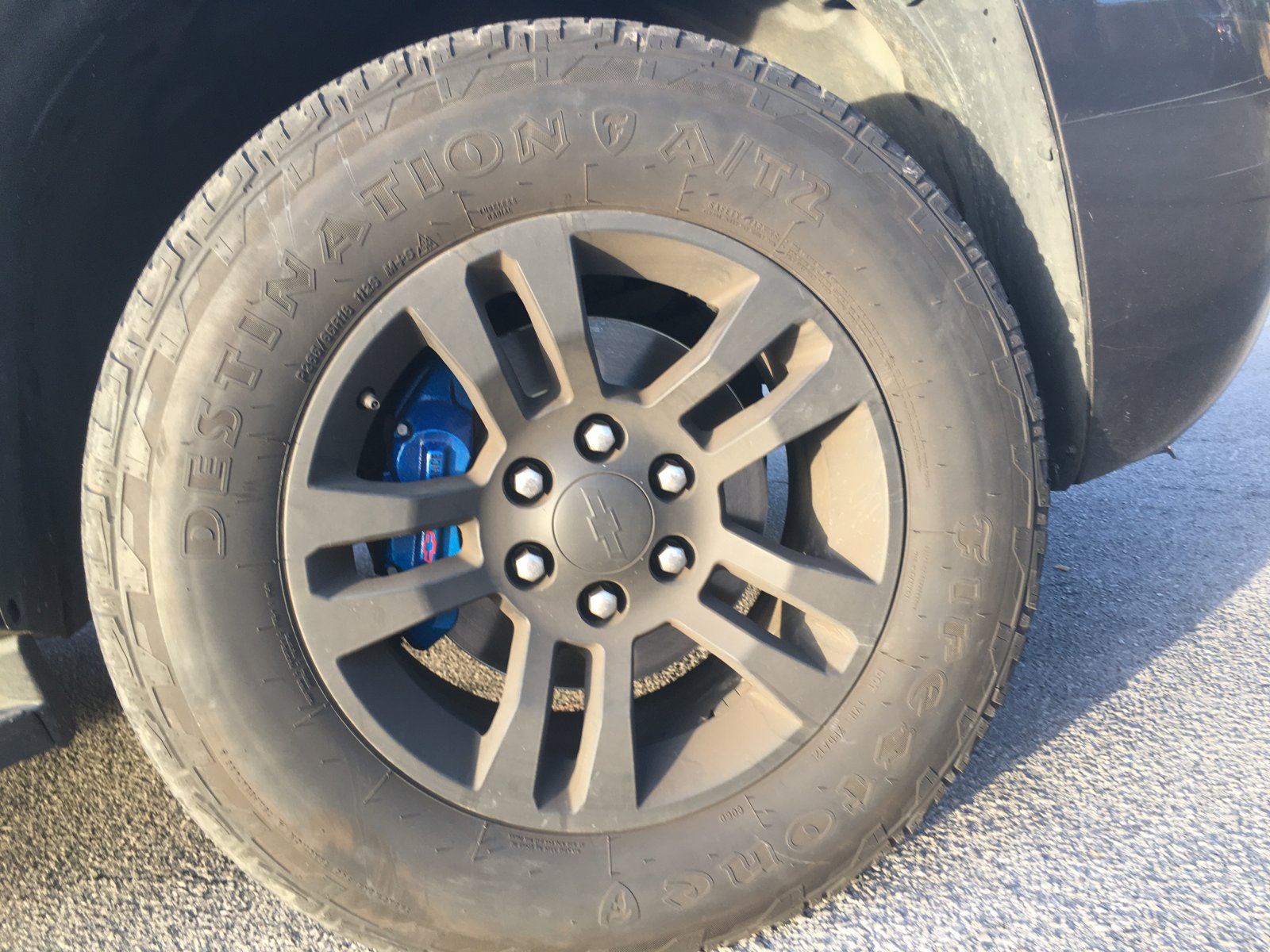

Plasti-dipped stock wheels aren't my favorite but I bought this car for the spec and drivetrain. We can fix that later...

But some of the cop red/white lights still worked so that's cool. This PPV only got a 3.08 rear gear open diff housed in a basic chevy 10 bolt rear end. I'd later come to realize how a hog ass cam, high stall coverter, LONG highway gear and heavy vehicle are not well matched together.
Documentation on the GMT900 PPV: LINK
Seller advised me that the 6L80 needed a tune, engine needed an upgraded valley cover and better catch can. (Oddly specific recommendations, hmmm...) He tried to do a burnout but with an open diff it just boiled one tire. I paid for the vehicle and headed back home 4 hours away without incident
Sweet idle video seller sent over:
Me behind the wheel somewhere near Atlanta on the drive home :)

I had the PPV for about a month before I started to mod it. I found it needed some new front brake pads and well why not just do new calipers? Its got 200k on them, probably original anyways. From these forums I discovered the 4 pot bolt on brake upgrade from the 2019+ silverados. I ordered a set, powdercoated them and put them on along with a new oem brake booster. Very nice improvement in pedal feel, definitely more confidence inspiring than the "heavy duty" gmt900 ppv brakes. Not bad for less than $500 all in!
2019+ 4pot brake upgrade
Brake Swap List
Caliper Front Right 13536580
Caliper Front Left 13536579
Splash Shield Left 84080138
Splash Shield Right 84080137
Front Rotor 13514522 ....13.5" rotor
OEM Pads 84847749
Disc Brake Pad Pin Kit 13513399
As I previously mentioned this thing was on tow duty, brake upgrades are always a good idea for a tow pig.
