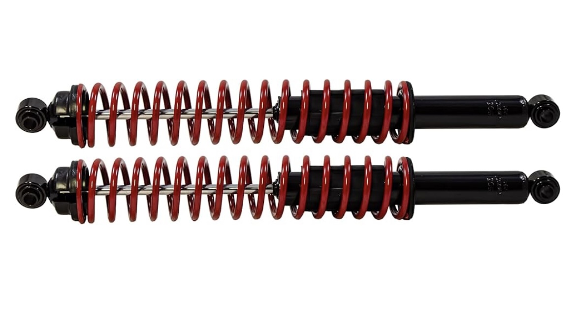

Do you have any idea on the FRONT strut/spring assemblies? Some posts state “same as all other Tahoes,” but some manufacturers exclude PPV on fitment specs.I just bought rear Gabriel 43181 “towing” Shocks with springs along the sides, to hopefully raise it some. (Looking to tow a 3,500lb RV), but can’t find any options for front strut spring combo. I’ve searched the threads, but all of that information is old and the part numbers are outdated. I’ve called and searched the web and found one $500 option but that’s ridiculous. Just want a standard or even softer ride. Waiting to find parts… already bought tie rod kit control arms. (Have to pay mechanic because I can’t physically do this on my own.) Thanks for your help!
