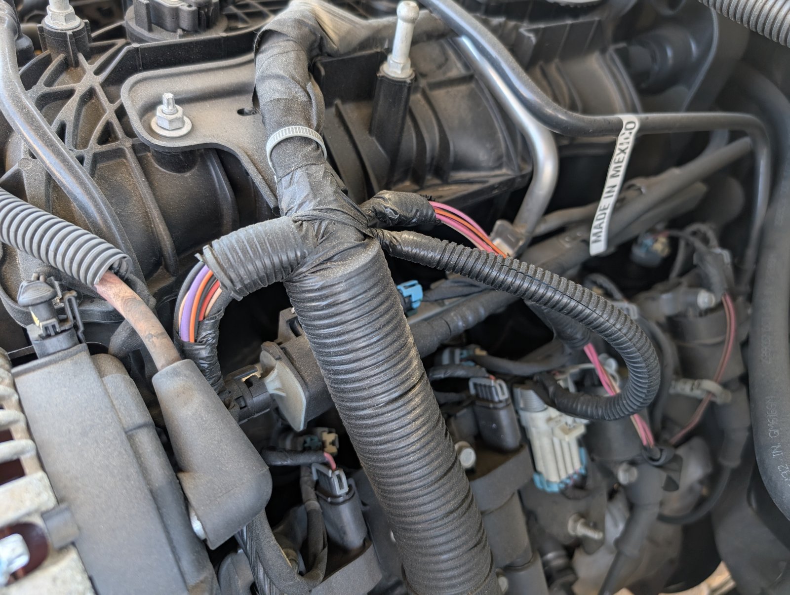

I'm looking now at starting cheaply with a cold air intake then exhaust system. Here's some pics of the engine. I can't tell what kind of intake manifold is on this. It's black, then there's some sort of silver thing attached with a cross beam that matches on the other side. I'm learning. I'm all very new to this but I am obsessed with this SUV and want to tune it over time.

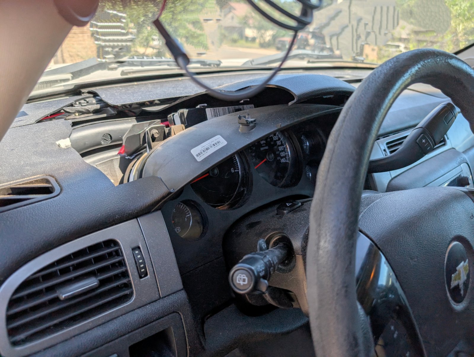

Due to the Texas heat the dashboard which was already cracked when I got it continued to crack even worse. The pieces have just come right off which is super frustrating cuz that's $500 part plus all the time to put it in.

Don't waste time / money with a cool air intake. They sound cool? I guess, but they barely improve power, and only @ higher RpMs.
Better to put that money toward an ecm / tcm tune.
The engine will perform better (might even get better MpG depending on how you drive)
Engine will last longer by disabling Engine Half@$$ (enable it over 230F, so you get a hint before you overheat!)
The transmission will be more fun, when you decide to assert yself
Believe it or not, you can ALSO improve on GM's OE Tow / Haul mode pattern for more durability / longevity
To add REAL towing / hauling capability, instead of the 3.08 axle,
upgrade to 3.42, or 3.73 if you want to tow over 5,000lb often enough.
Your metro / urban stop'n'go MpG and acceleration will improve too.
The highway MpG penalty won't be as bad as you think -
you'll spend more time in 6th & 5th on the highway.
Thanks these are great ideas. I will look into the axle that's a big move so gotta wait. But I was thinking of doing ECM/TCM tune. If you have any recommendations for a good one let me know. Or a thread for PPV ones
Marky Dissod
Mar 3, 2023
4,227
6,167
(718)-
But I was thinking of doing ECM/TCM tune. If you have any recommendations for a good one let me know. Or a thread for PPV ones.
I recommend pcmperformance.com. BlackBear Performance also comes highly recommended on this forum. I'm sure there are other worthy options.
Best bang for your buck is for the tuner to be in your car with a laptop for an hour or two, to better customize it to your tastes.
3.42 or 3.73 might be 'big', but it'll be the best bang for your buck.
I'd recommend axle gear and a tune over cam & heads or a 6.0L for the vast majority of people thinking about getting more performance from their engine.
After that, it's all about tires / brakes / steering / suspension, which I'm still learning about (thinking about trying PPV torsion bars).
