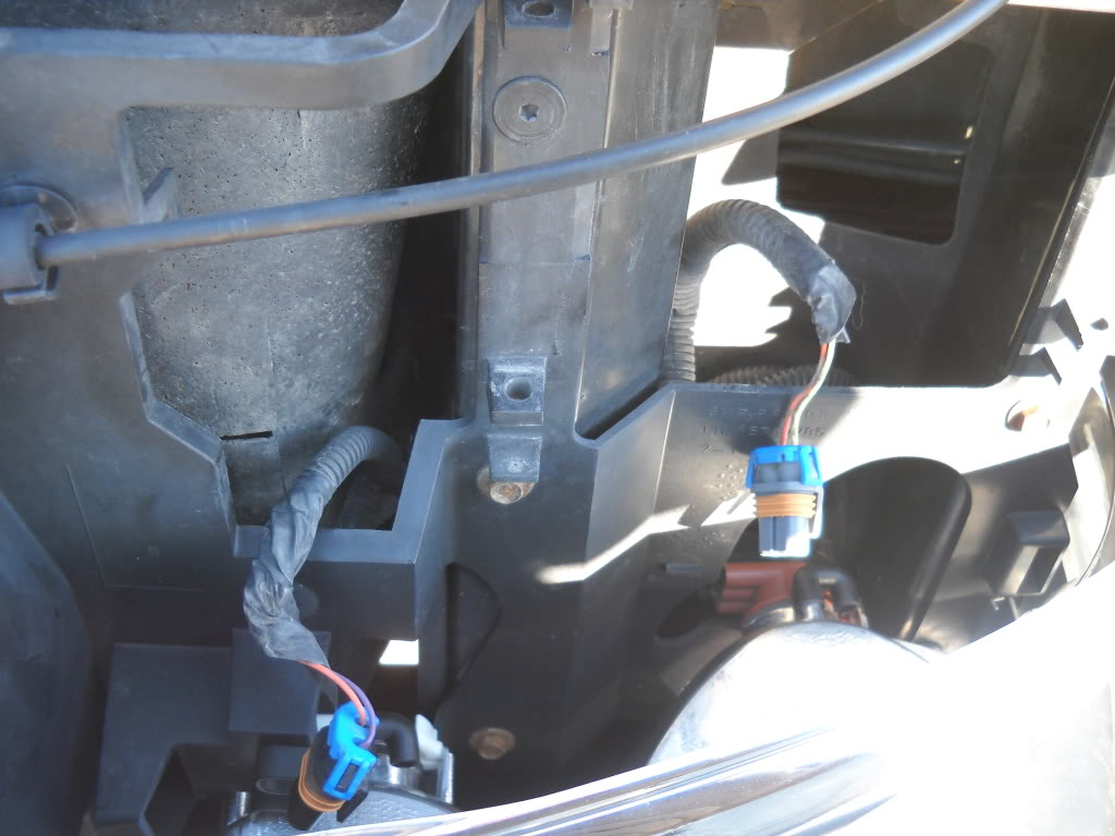

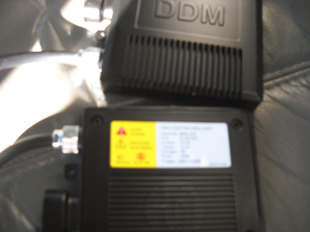

ddm 55w 8k hids for high and low beams and 8k 35w for the fogs
clear headlights and signals with amber led corners

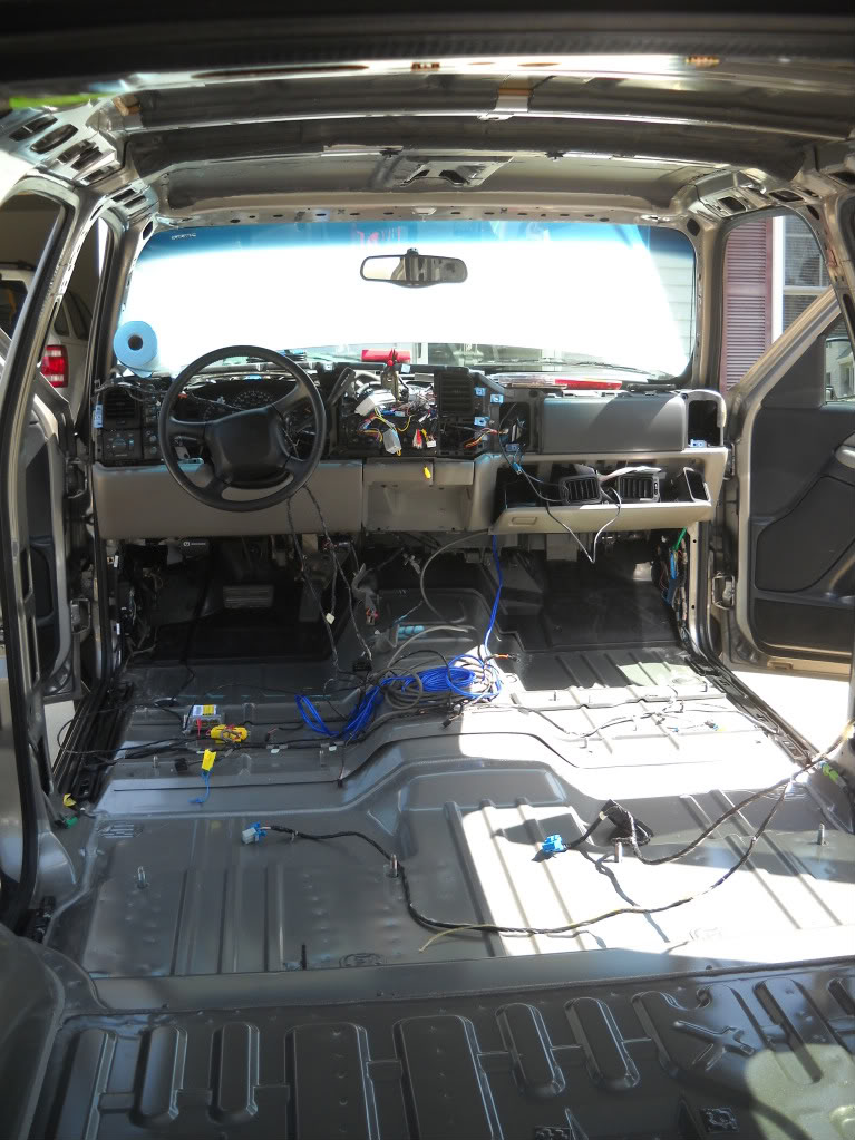

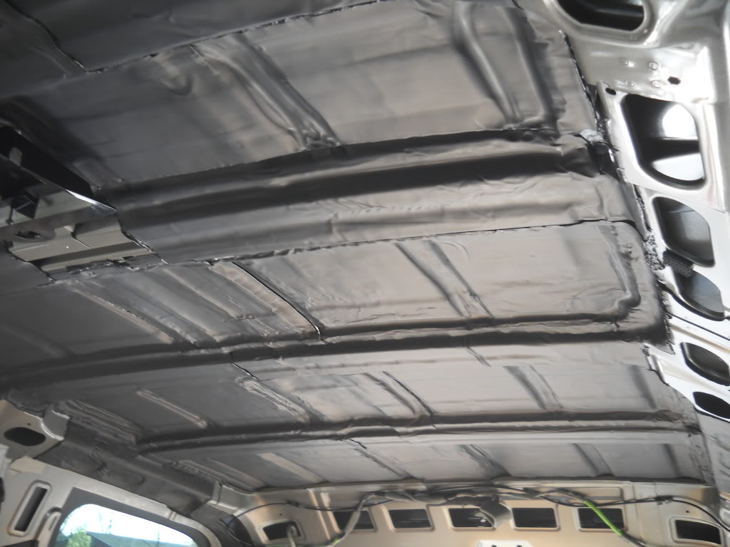

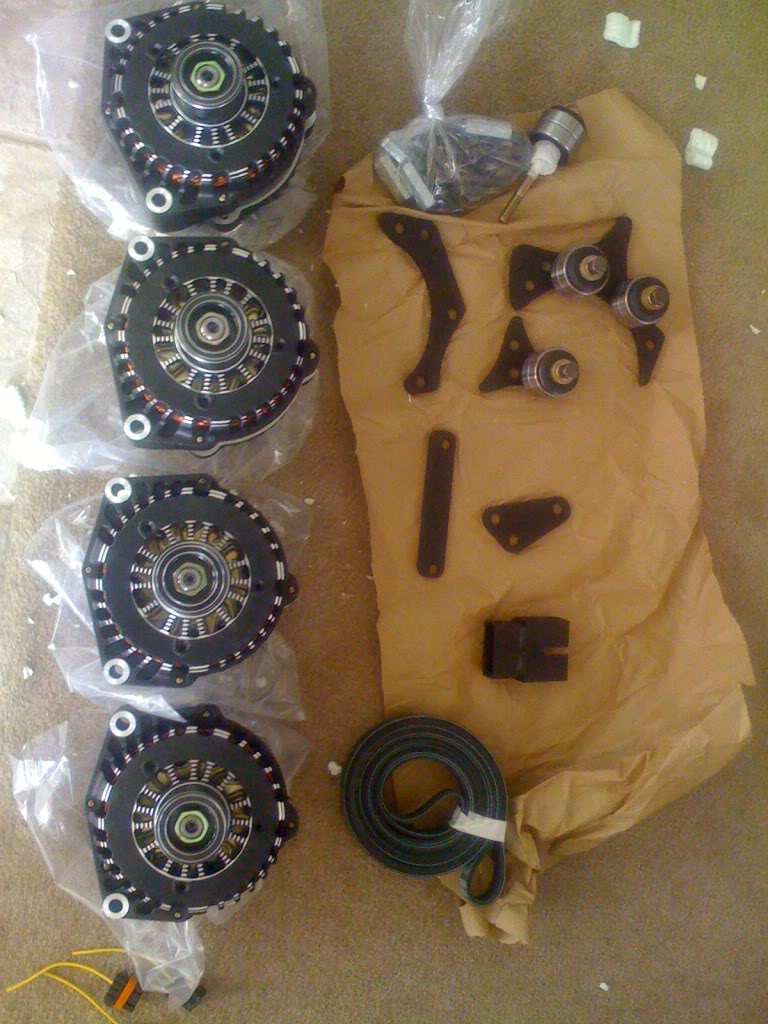

gutted and deadened. 2 layers on the roof, 1 on the floor and rear quarters

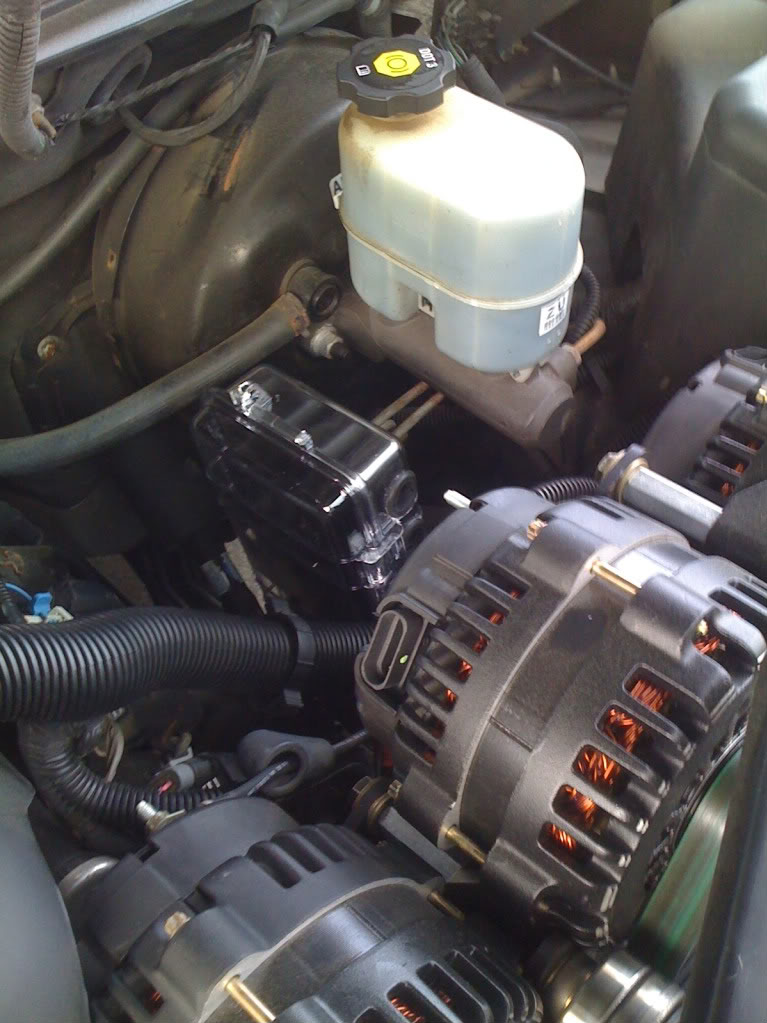

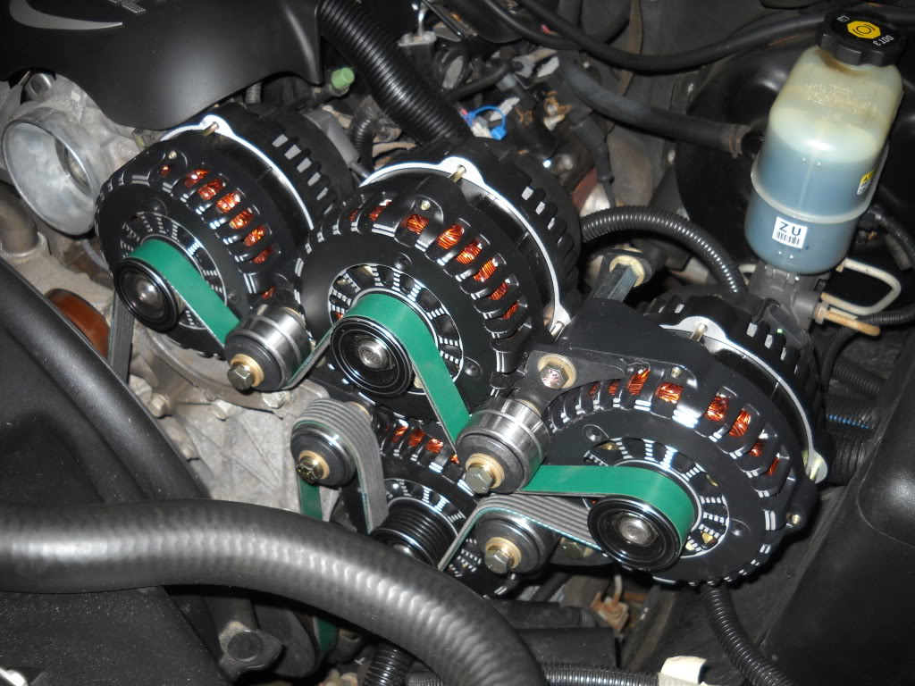

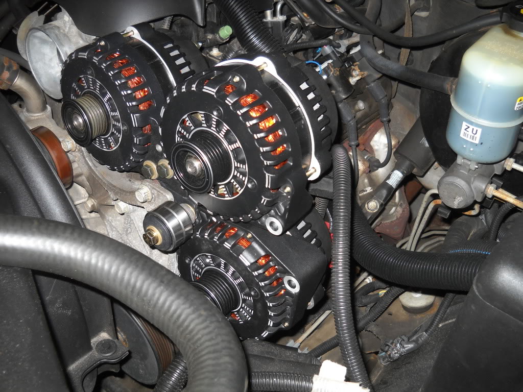

quad alt kit

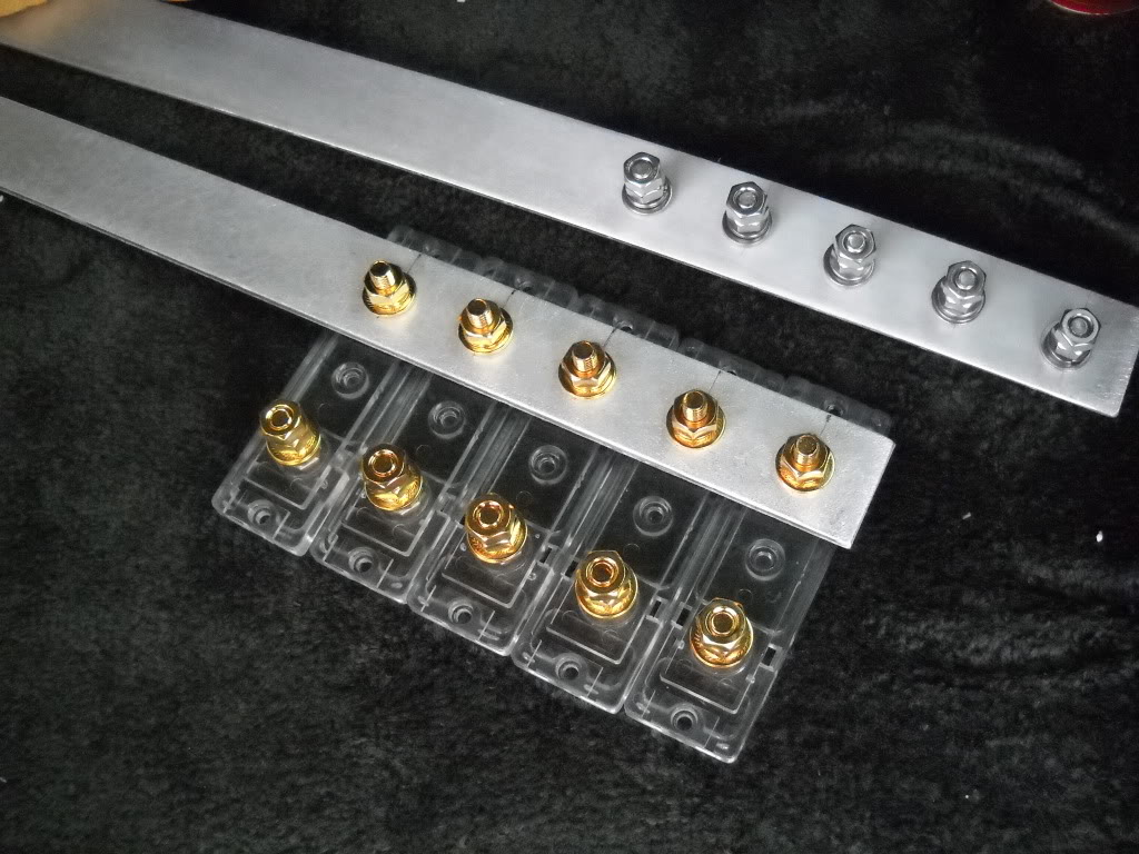

fuse block i made
mounted to the frame
---------- Post added at 09:44 PM ---------- Previous post was at 09:42 PM ----------

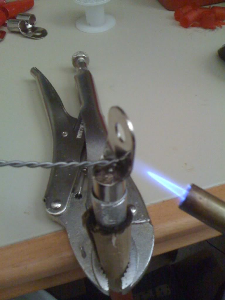

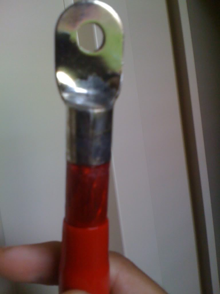

all the ring terminals are soldered
for the alts and front battery

Damn man, I like the attention to detail :waytogo:
that's some crazy amperage, where did you pick up the brackets?

Those alts are sexy, and that fuse block is badass. Where do I get one?

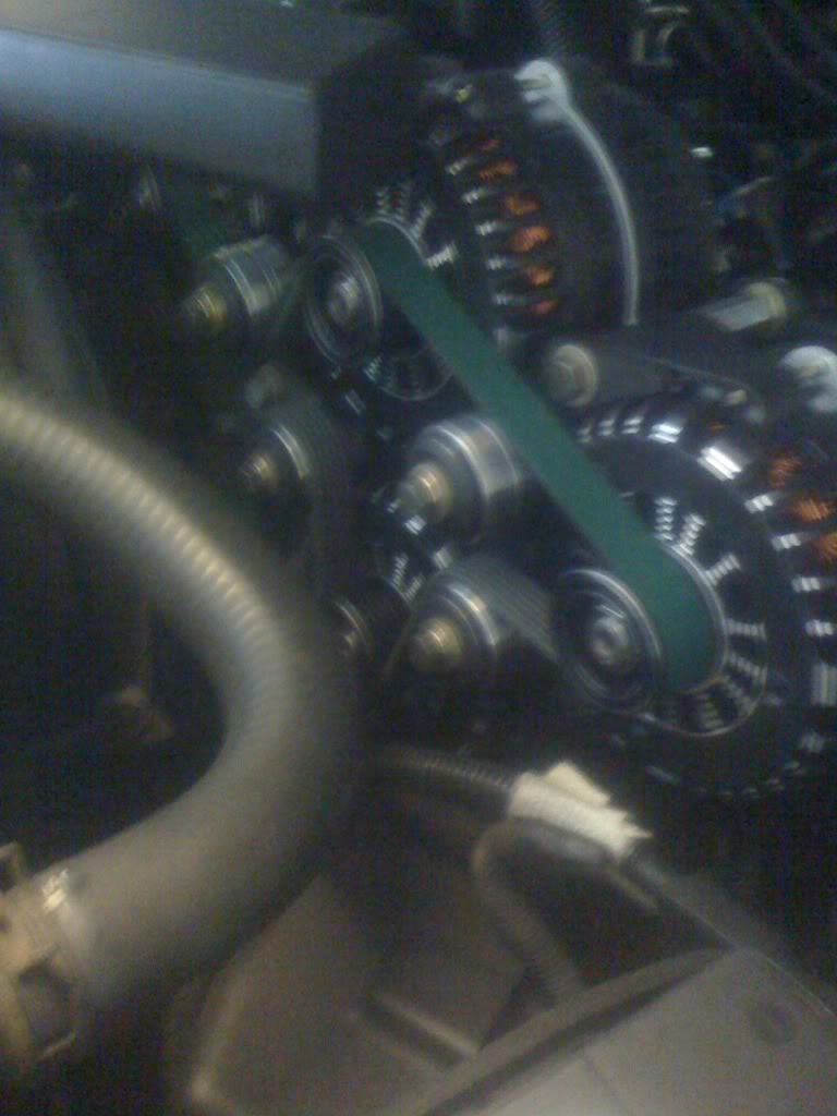

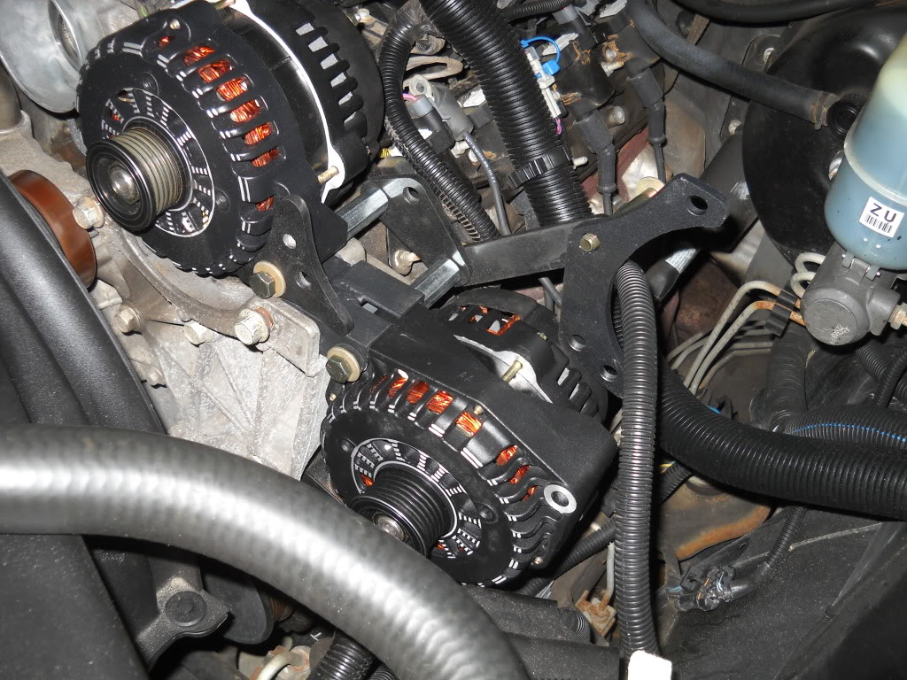

i got some old pics that i didnt get to put cause my sd card reader shit the bed on my laptop.
heres of the alts when installed them
more of the interior
---------- Post added at 11:39 AM ---------- Previous post was at 11:39 AM ----------
second skin
1 on the floor on the flat ares 90% coverage and rcas and 12g stinger wire under the carpet for the doors and wire ran for the a-pillars and kick panels for the future

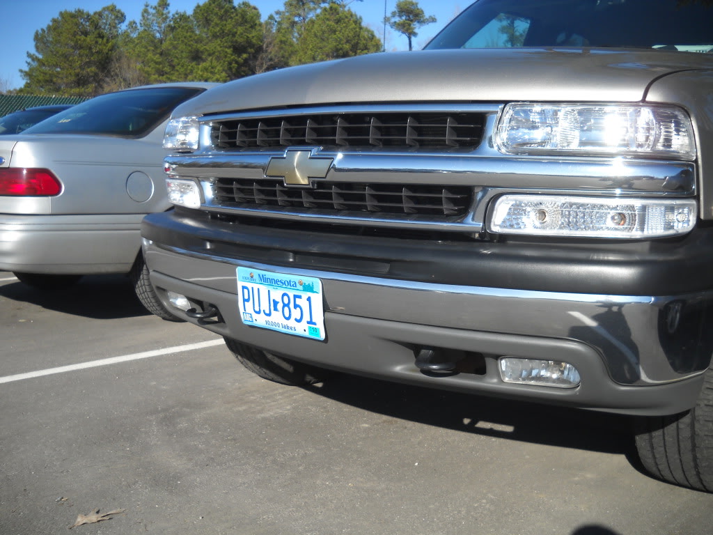

hids and clear headlights/signal lights
before
after

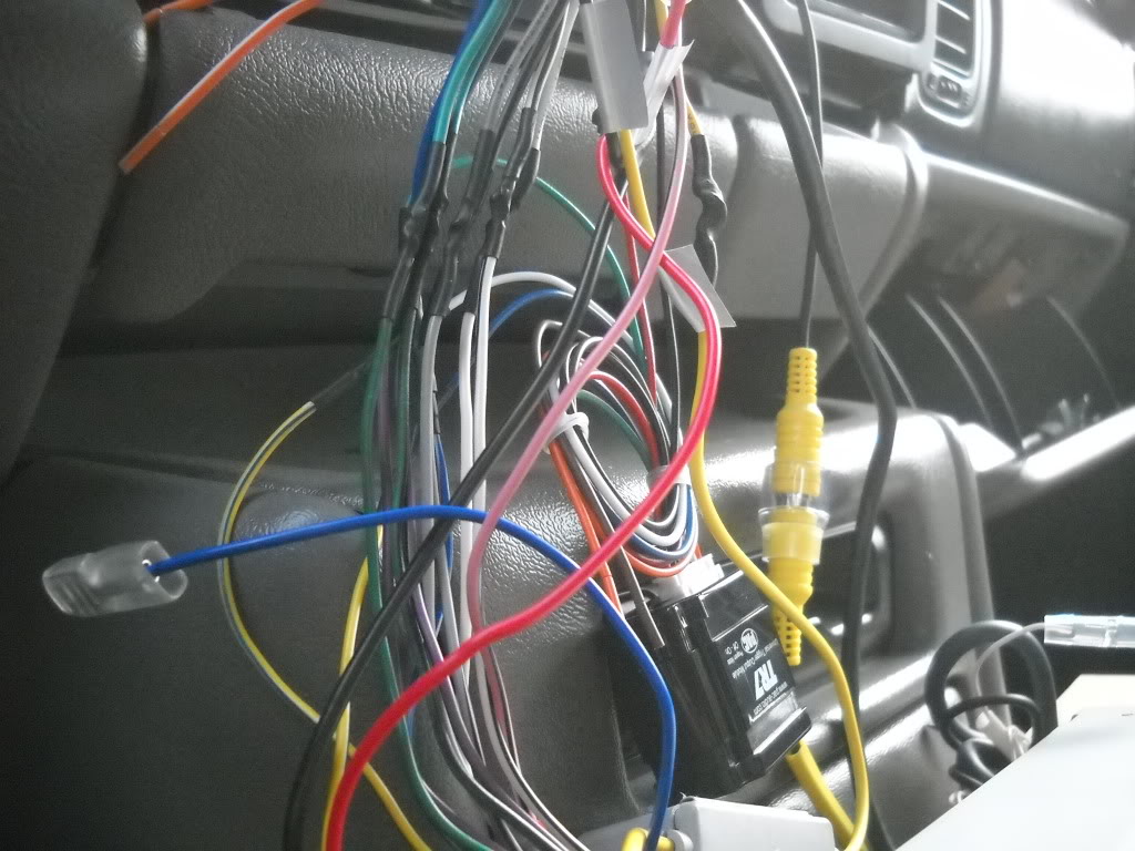

headunit before
bluetooth

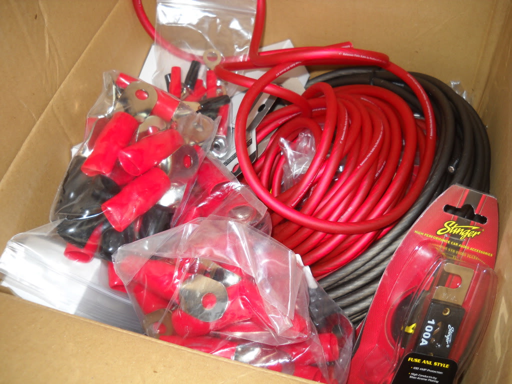

some equipment

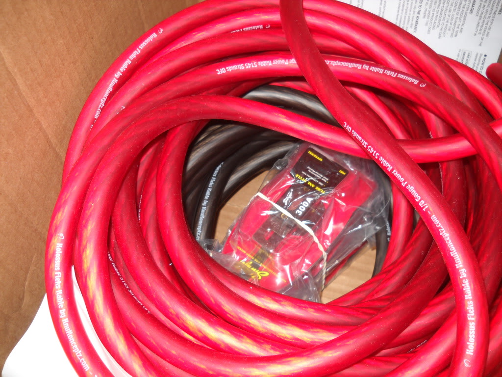

100' 1/0 kolossus flex and 8g, fuses and a ton of ring terminals

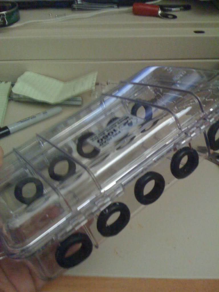

i built the fuse block using an old pelican case, grommets, spray painted some framing brackets and some nuts,bolts and lock washers. good luck on your build

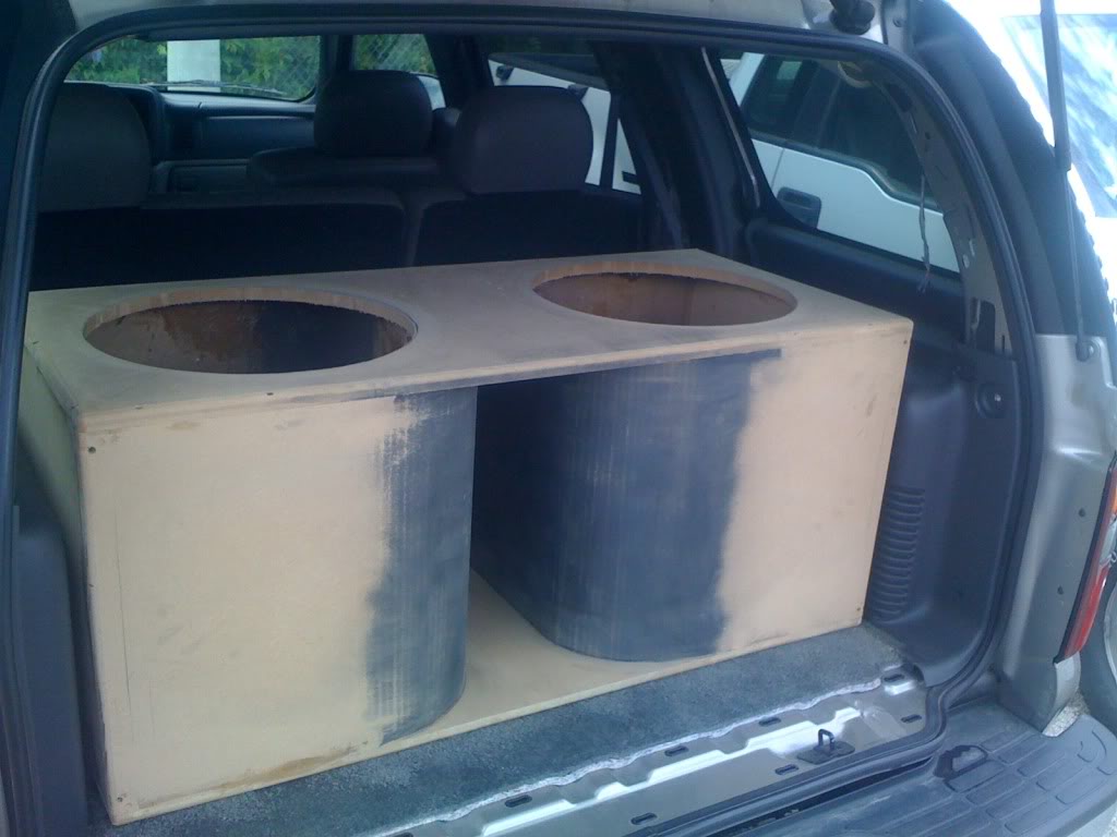

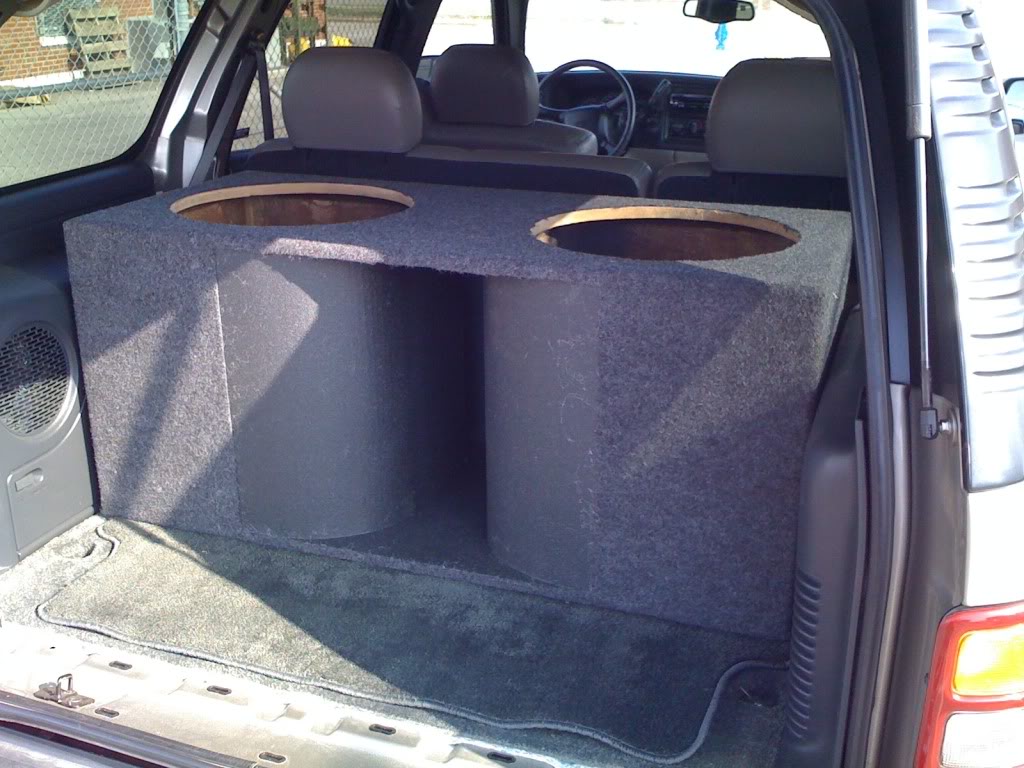

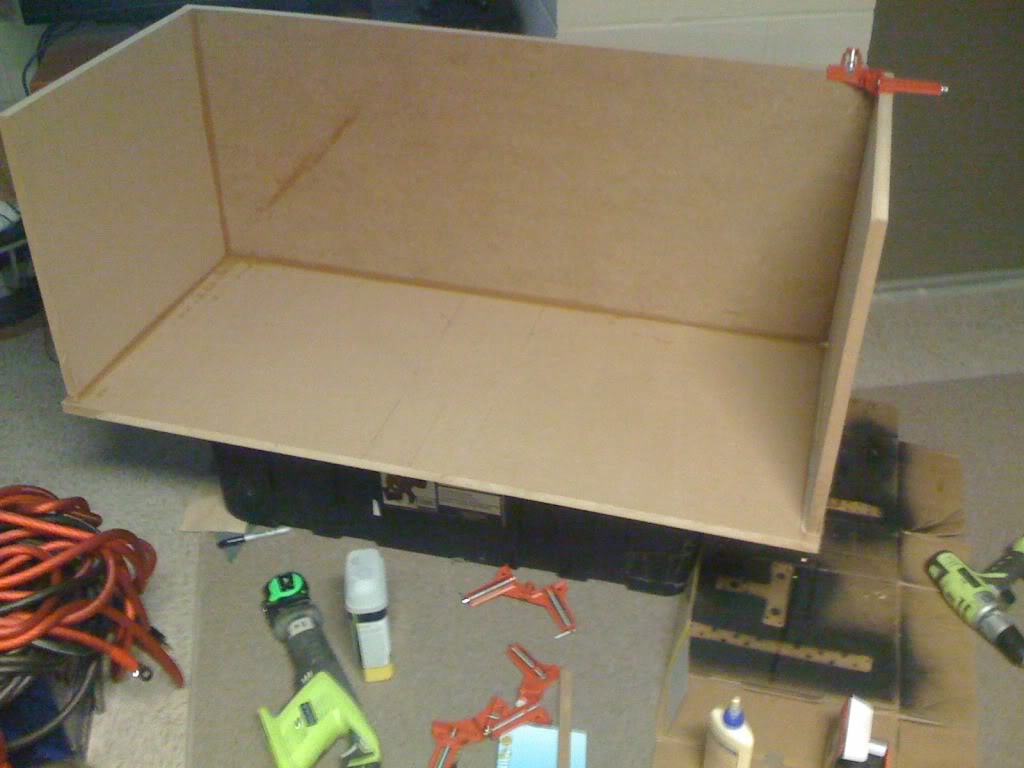

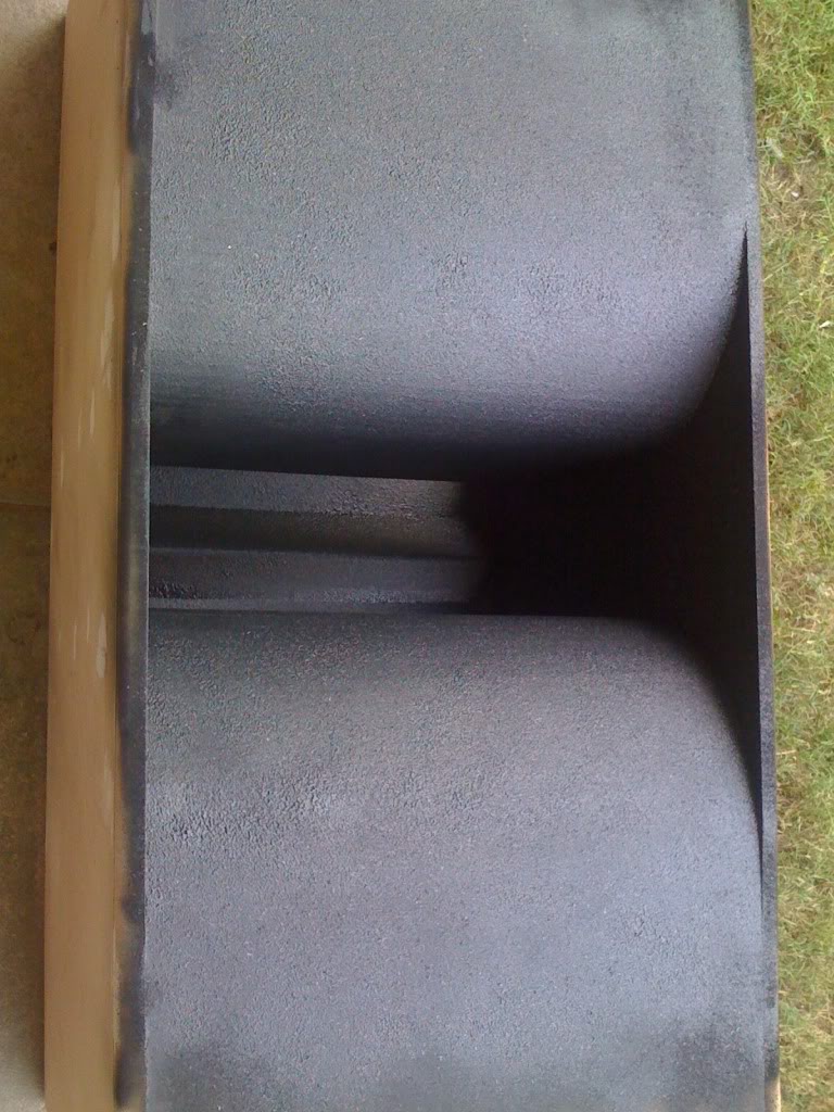

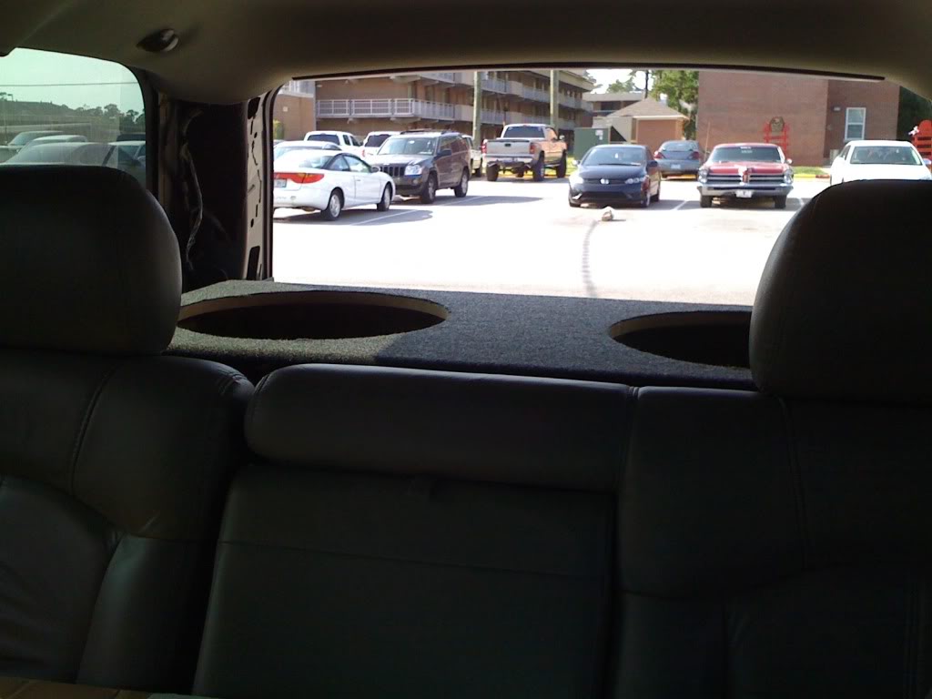

Well the box is built. Now I'm working on a new build for the next step

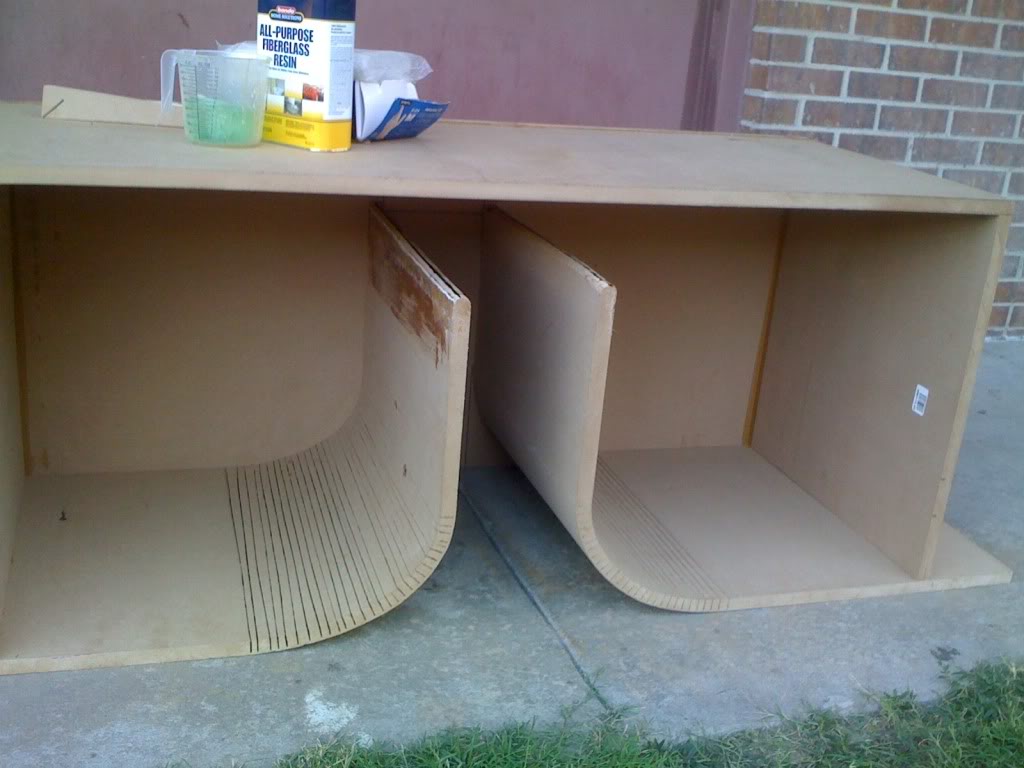

built it in my room
getting the kerf lined up
making it strong
rounding over the corners
---------- Post added at 11:30 AM ---------- Previous post was at 11:20 AM ----------
Seperating the chambers
cutout the holes and test fit
Filled in the screw holes, sanded, glassed/45'ed all the corners
sprayed the port with splatter paint
---------- Post added at 11:41 AM ---------- Previous post was at 11:30 AM ----------

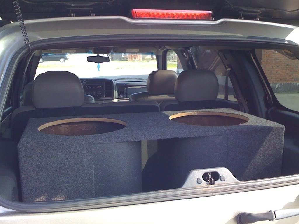

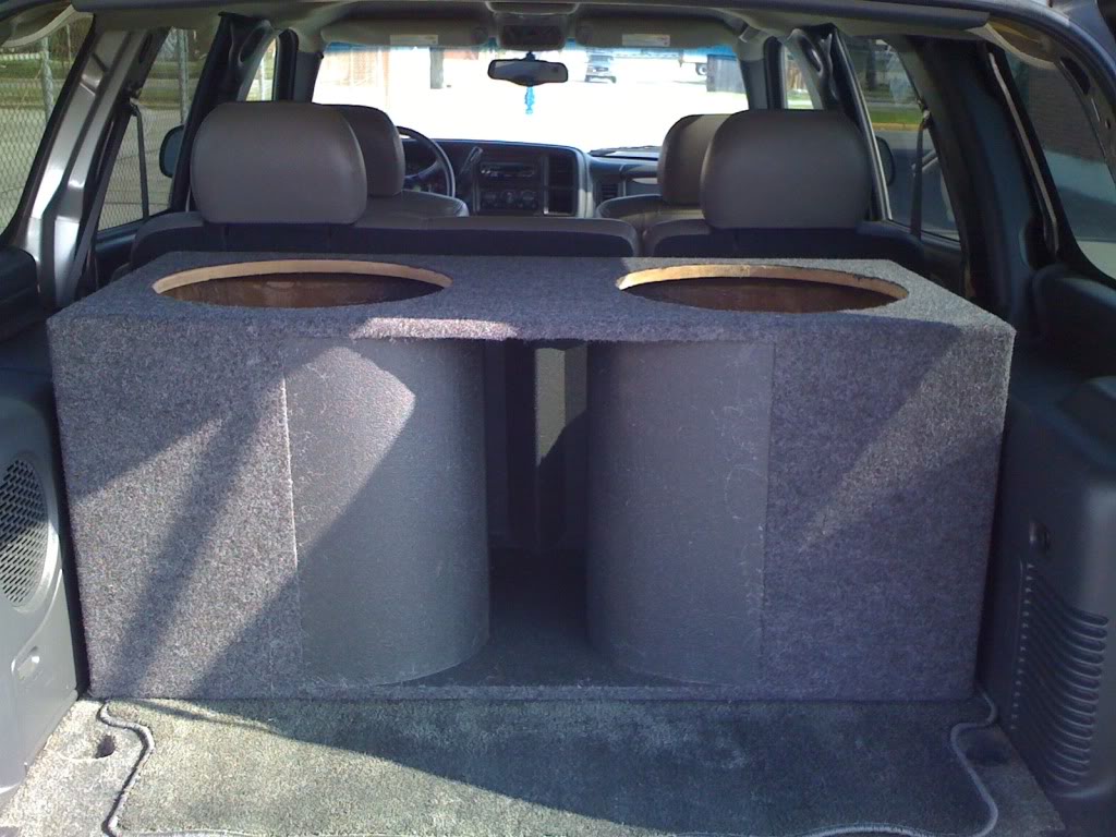

Wrapped and ready to load. Just needs some finishing touches
4.75 cubes after displacement tuned around 32hz
---------- Post added at 11:46 AM ---------- Previous post was at 11:41 AM ----------
What do you guys think for a temp box and first time kerfing wood? I think it cane out all right.
