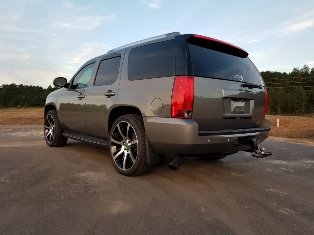

husky I've had mine on for almost a year they seem to be holding up just fine and they do the job, that was one of the first things I noticed when I went to the nnbs freaking mud all the way up to the windows! my nbs never did that
this is the correct set right here
https://www.ebay.com/itm/Husky-Line...731-/302213622700?vxp=mtr&hash=item465d55ebac
install was pretty easy, you may want to take the rear wheels off if/when you install the rears, I drilled a couple holes in the rear wheel-well plastic to make them more secure, the fronts went right on real easy because you can turn the wheels for room

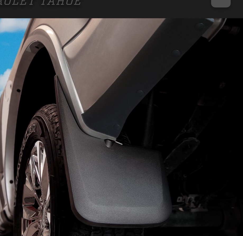

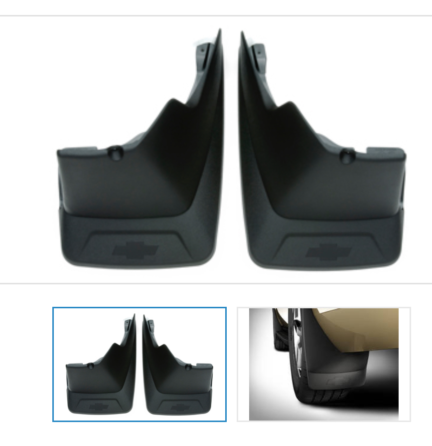

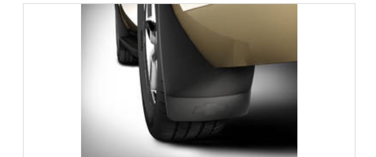

Dont get GM... whichever you decide on make sure they do not have the bulging part that has a rubber edge that rides on the fender or bumper/quarterpanel. Get the straight type that just follow the wheel liner and outline of the wheelwell. The gm brand with bump out/rubber strip rubs the paint and leaves a line. Look closely at @93blkongreenpro .... get that type.... Ask me how I know...
Get first pic type not bottom
