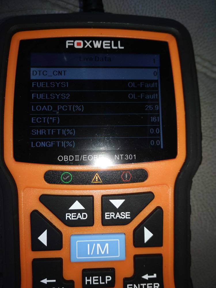

Got rid of the multiple misfire and only got the cylinder 4 misfire now but in scanner it's showing ol fault when you go in to deeper info on scanner. Still haven't tried switching injectors yet. going to today. Saw some where about collapsed lifter online. If I do have a afm lifer collapsed wouldn't it make a tapping sound?
