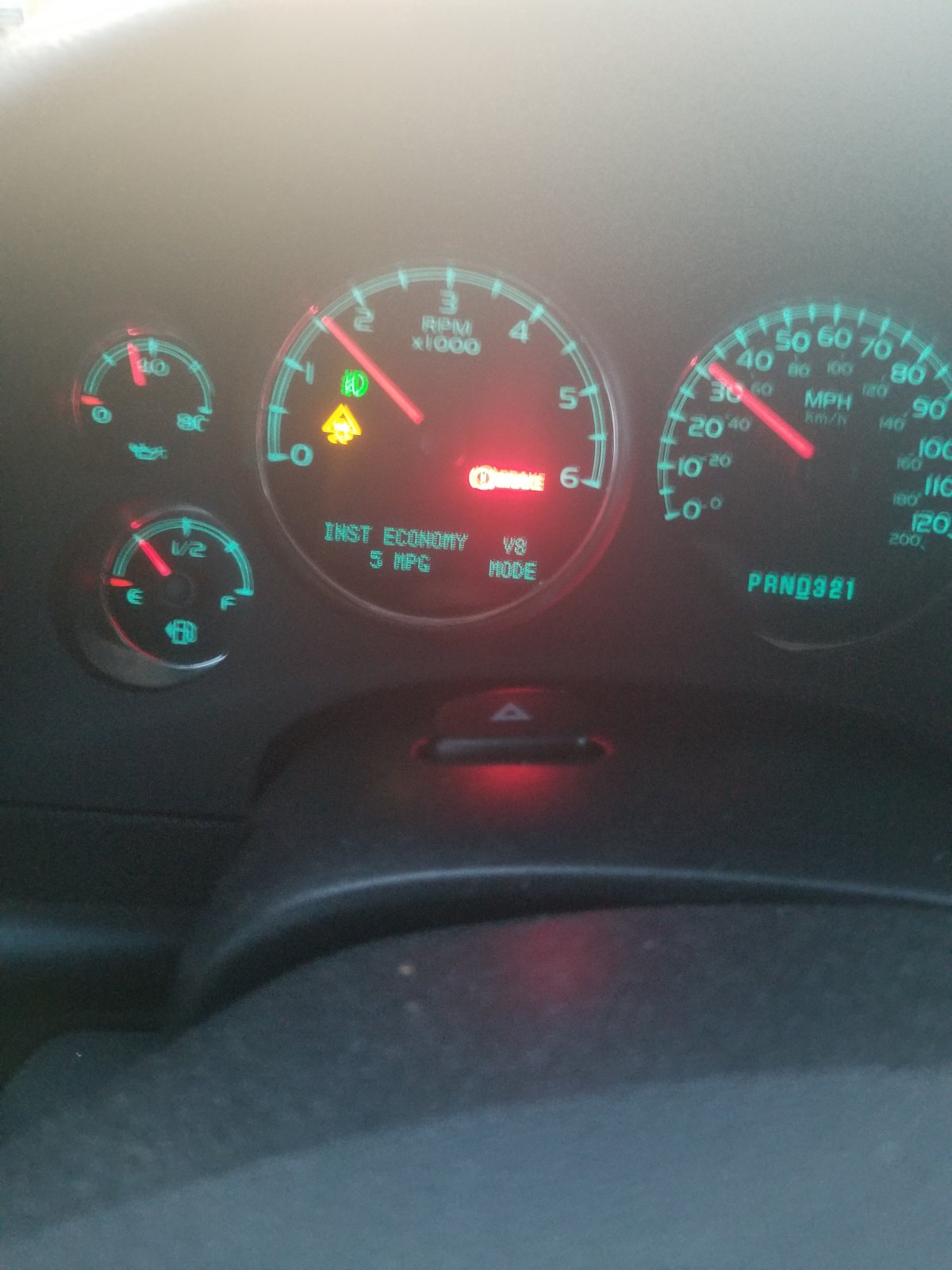

07 Tahoe LTZ just had a misfire on cylinder 7, got that fixed now engine is shaking again at idle, no check engine light yet like the first time. What could it be? Also traction control and brake light are on simultaneously. Please help
When you say "got that fixed"... what exactly got fixed???... plug, wire, coil pack, fuel injector, AFM lifter???
The TC and ST lights will come on any time you have a misfire.
A scan tool like the Tech2 or even a bluetooth OBD2 scanner with the Torque Pro app would be very helpful as you can look at real time data to determine the cause of the misfire.
Only the Spark plugs and wires were replaced....where do I get the tech 2 and or scanner?
