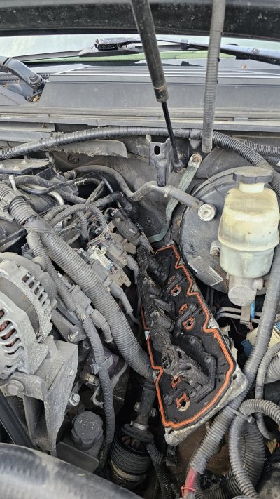

Currently falling into the dod rabbit hole. Continuous misfire and only pulling p3441 & p3425 for cylinders 4 and 6 deactivation solenoid control circut. Previous owner just told me he had it deleted. I can verify it has an after market valley cover but the oem dod cover is sitting beside the right valve cover still plugged in. He also had a range technology plugged into the obd port. When I unplug the dod solenoids the misfire gets worse. What im really wondering is if I get it tuned to have the dod disabled, shouldn't this just bypass the two dtc's?

I would start with getting it turned off in the ecm and see how it goes. since it needs to be done anyways
beyond that, not all deletes are same. a cheaper Amazon/ebay kit can cause more problems than it fixes sometimes. without doing it yourself, you really don't know. but judging by the old cover plugged in and dongle still in. had to say what was used.

I am pretty sure that that motor should run just fine with that DOD cover plugged in on the side there WITHOUT the range disabler plugged in. But it sounds like some of the AFM related electricals are damaged so I would proceed with getting a proper AFM delete tune with the expectation that there is probably something else going on as well.

The optics of that AFM delete speak volumes about the quality of workmanship..... Or rather the lack thereof.
Definitely get AFM turned off in the ECM and throw that VLOM in the trash.
From that point on you're diving into the unknown. Did the previous owner even change the camshaft/lifters? And the whole list of other items that you won't know without digging into it.
My instinct tells me the previous owner was having an AFM failure of some sort, probably an AFM solenoid. Slap on a flat valley cover, plug in an OBD2 dongle, leave the old VLOM hanging by the harness and sell it ASAP as a vehicle with a delete kit. Sorry, hated to say that, but that's what my gut tells me....

+1 for this. Not only do you need to get a non AFM tune flashed onto the ECM but you also need to physically verify the AFM components have been removed. Maybe remove the valve cover and look for new head bolts or can you see the edge of the head gaskets and do they look new?

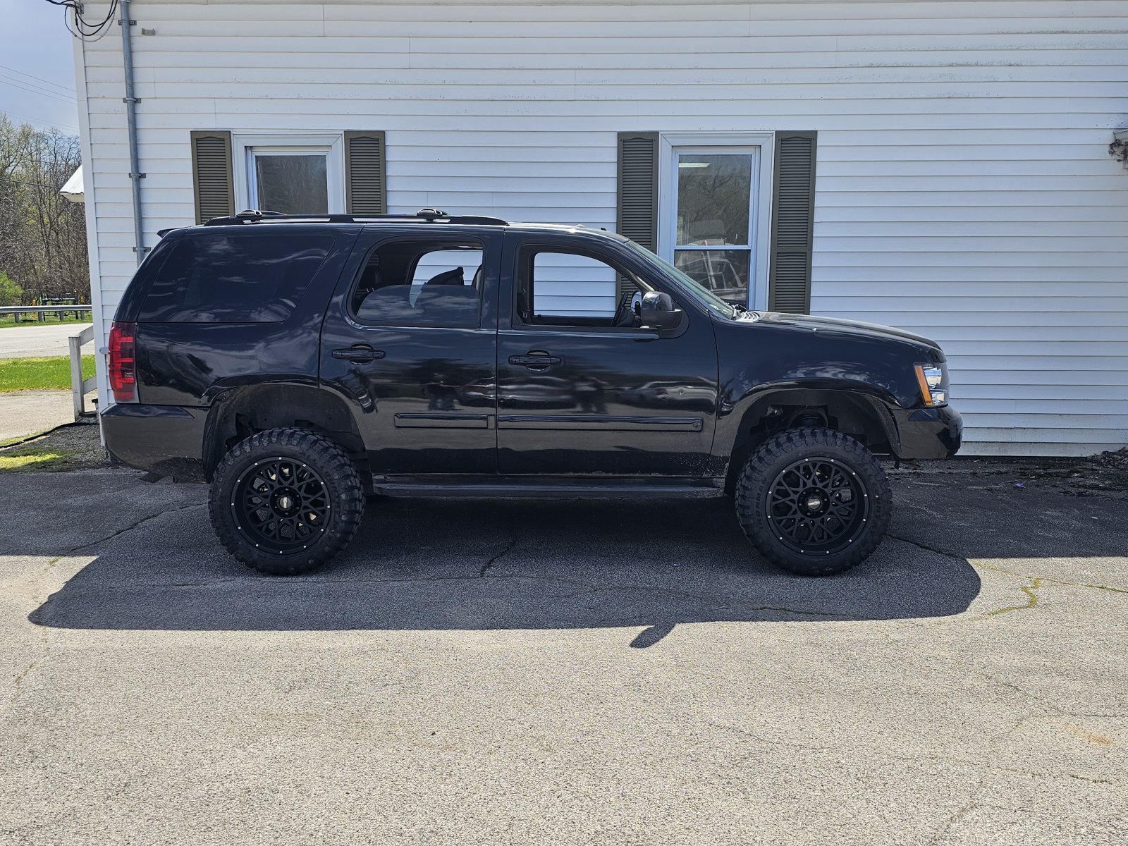

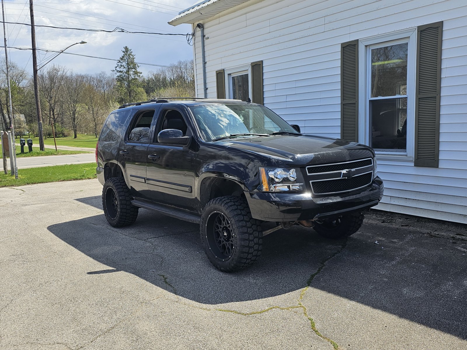

Also here's the pics of the $500 beater

That ground strap in the picture looks a little suspect. You should test it to see if it's still providing a good ground. If it's bad that can cause all kinds of electrical gremlins to run about. And move the clamp on the brake booster hose over to the booster.

Yeah, for $500 you got a deal. And right down the road from Michigan Motorsports? You are all set.

it's nice that he linked you to the kit he used, I was going to say there's a 99% chance it's got some kinda non afm lifter in it to be running with a flat vlom cover. if you put a flat cover on afm lifters, it blocks the oil ports and runs about 5mins before a afm lifter gets stuck. they basically have to be vented very well.
I have seen a bunch of threads about cheap non afm lifter being used, and failing. pretty much instantly and having to go back in. I don't blame anyways, you don't know till you know kinda thing. I have no idea if the cams and any good. I've heard people say the heat treating might be suspect on them too. but don't know.
that said, I think I'd still turn off in the tune and trouble shoot little deeper

Going to be hard to troubleshoot until you get the AFM turned off in the ECM. If you're getting a code for one of the solenoids, that means the ECM is expecting to see AFM. And if it's doing that, trying to deactivate some cylinders, it shuts the fuel off to those cylinders.
