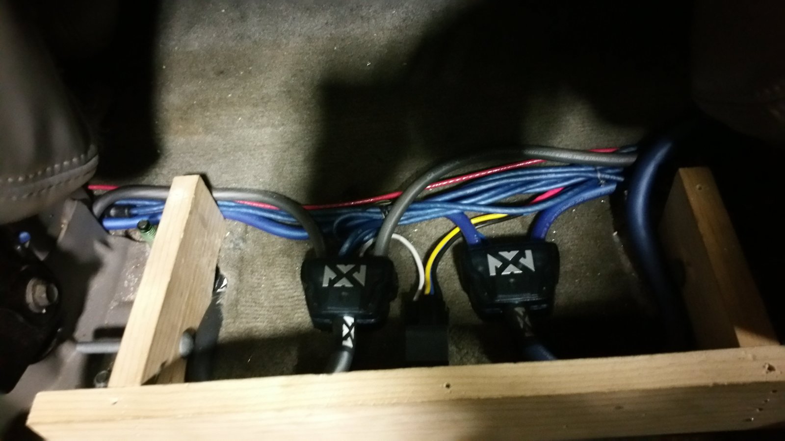

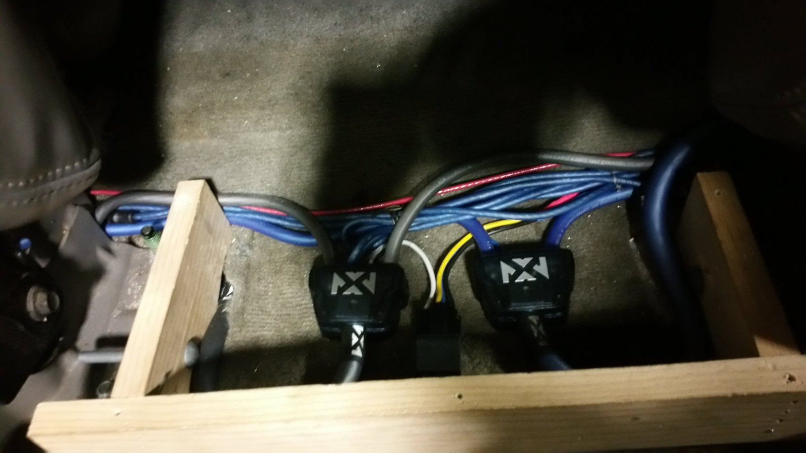

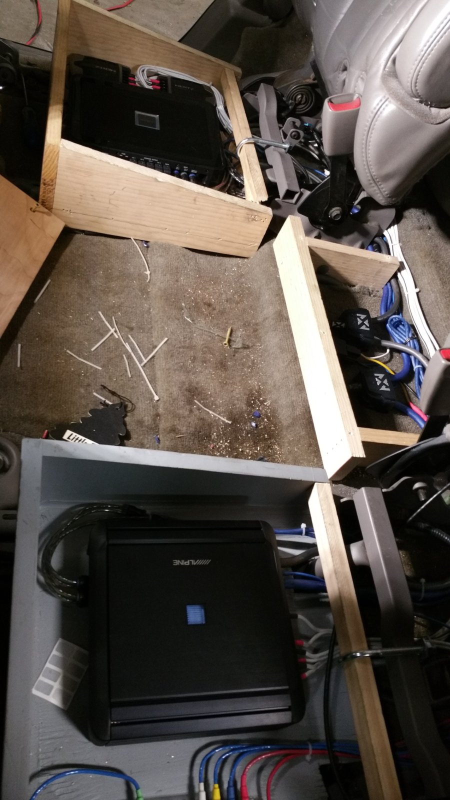

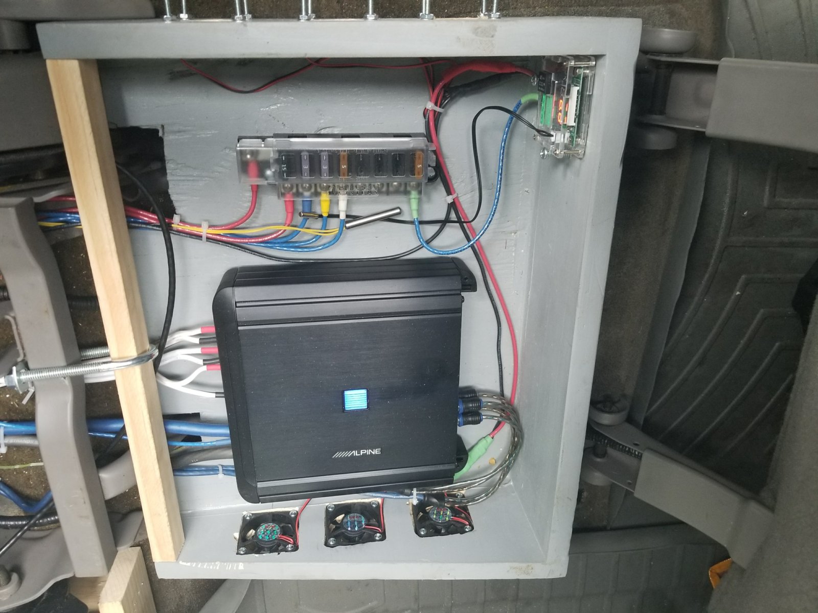

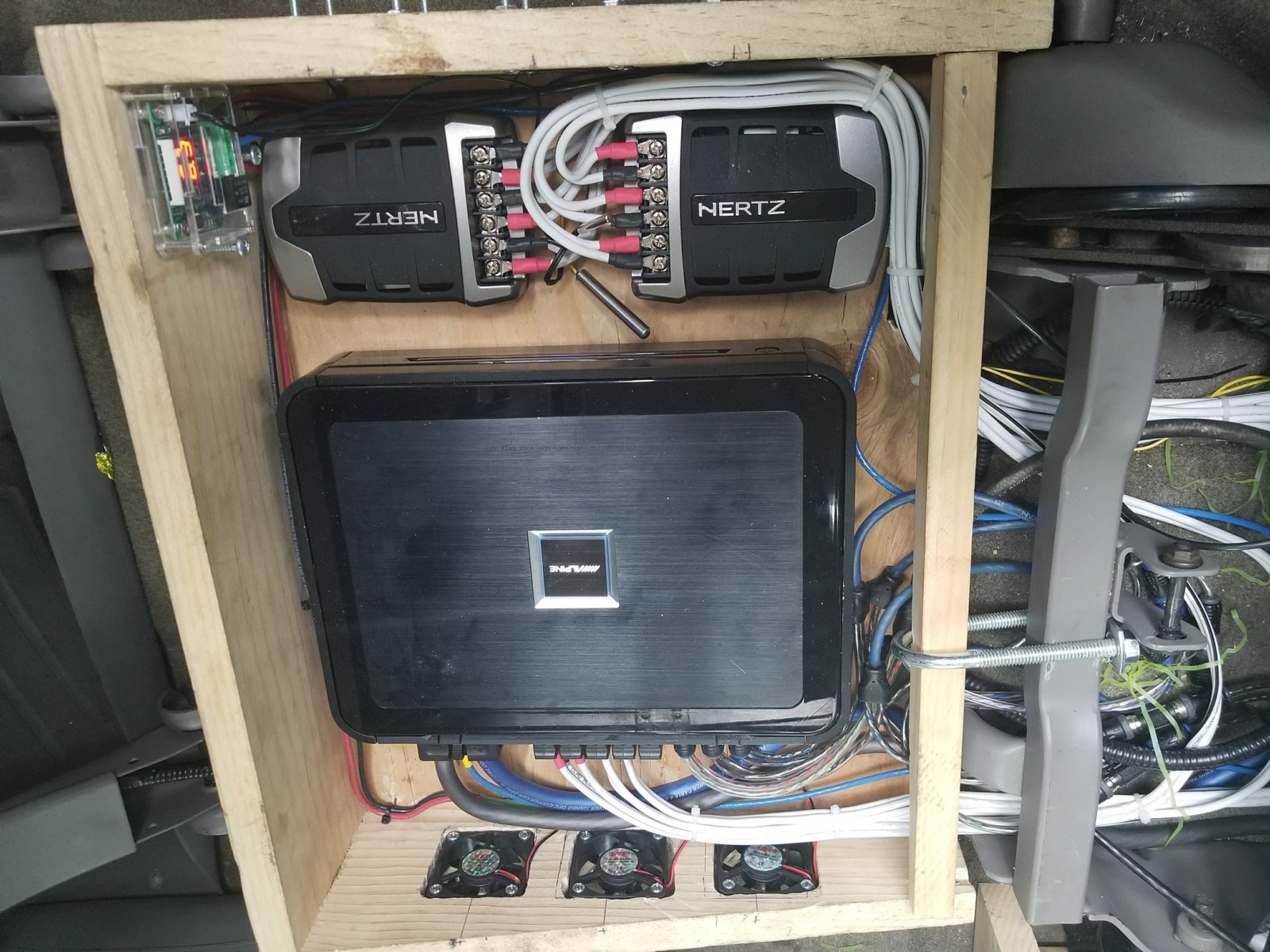

Here's what I started doing. Still a lot of little things to do when I have time, but some ideas since you have captains chairs. Any questions, let me know
