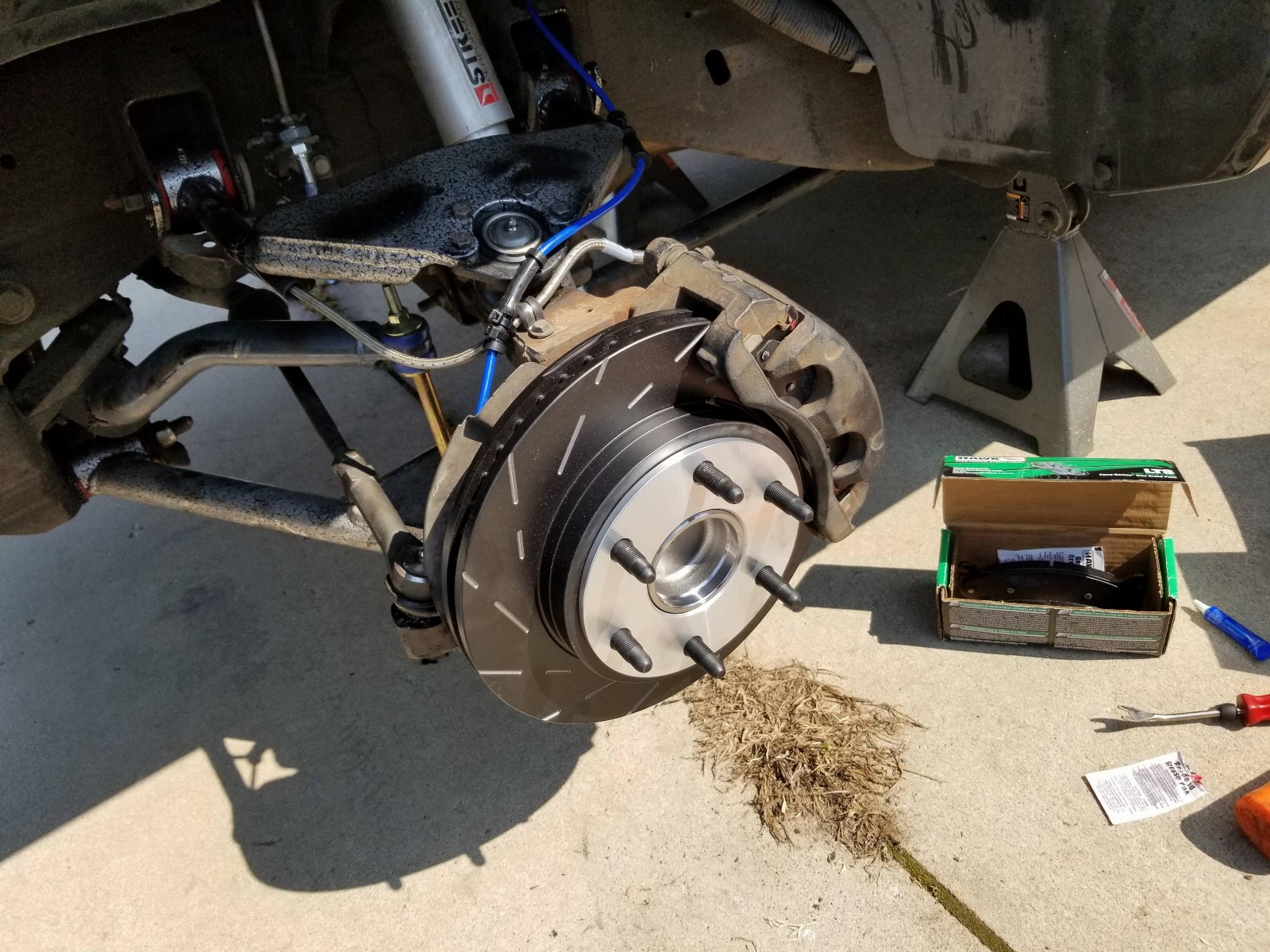

Yesterday I replaced rotors and pads all the way around. I found EBC USR series rotors for the rear for $71.71 shipped on a price mistake on Amazon. Actually they were supposed to be the GD series and they ended up shipping USRs. Either way I saved about $150-190 and so I bought the fronts to match and then I found hawk LTS pads for the rear for $35 on eBay on a 40% off sale and had a 25% off coupon to stack making them $30 shipped and then bought the front pads on Amazon to match making my whole upgrade $315.21.
All rotors front and rear were factory somehow after 185k miles and not completely worn out. The new EBC rotors just look sexy as **** though.
Unfortunately my front driver side hub decided it was going to feel gritty as shit and have lots of play in it so I went to Autozone and grabbed the one Moog hub they had and I'm very impressed with it.
I finished everything up and put on my new 1/4" spacers in the front which has, along with my upper control arms, completely eliminated the tire rubbing on my sway bar.
I then took it to Hibdons to get a lifetime alignment at which point I assume they ****** up. What I am guessing happened is they didn't see that half of the alignment cams were replaced and now had fixed positions and they cranked and cranked and eventually cracked one of the factory alignment cams on the driver side and on the passenger side it appears they might have actually broken the alignment pin the cams work on. Either way I got it and brought it home and I'll deal with it later. My roommate doesn't love doing alignments on his dealership rack but he will after he sees their handiwork.
