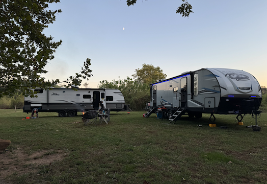

Adding some pics from our adventures with it so far. Towing with it feels effortless in terms of stability, braking, and power with the 4.10 gears. It's more stable than our 2012 Yukon XL Denali (3.42 gears) and spends most of its time on the highway in 5th when towing instead of 4th, with less downshifting needed. Engine and transmission temps are cooler as well, with all factory components. I'd made considerable mods to our 2012, including a cam, thicker radiator and upgraded fans from the K5L package, and a bigger Derale 13960 transmission cooler, but the big burb trans stays 30ºF cooler than our 2012, also likely due to the 4.10 gears. The coolant temp gauge has never moved above the center peg, either.
Lots of folks on the interwebz comment on the factory rated towing capacity on these being only 3,000 lbs., but from an engineering perspective it's actually more capable than the GMT900 2500's were, with bigger brakes, rear axle shafts and springs from the 3500 SRW pickups. But you gotta remember that these were built primarily for armoring, so GM just never bothered with the J2807 towing test for it. It doesn't mean that it can't safely tow MUCH more than that. And as long as you're within the GAWR, GVWR and hitch ratings, they won't even bat an eyelash if you ever get flagged into a weigh station anyway.
I stopped at a weigh station before heading into the tunnel under Chesapeake Bay for the routine propane bottle inspection and I chatted with the guy there about it. He confirmed that they don't care about rated towing capacity and would only look at the GAWR and GVWR placards, and only if they had obvious safety concerns or I was operating as a commercial vehicle. If I'm within that, I'm good, but RV's don't have to worry about stopping at weigh stations in most states anyway unless there are signs that specifically say so.
Misty Mountain Camp near Charlottesville:
Drove it to the Earl Scruggs Music Festival in southwestern NC in August and caught Marty Stuart and Jerry Douglas live, among many others we love:
Did some boondocking with friends out on the James River near Scottville, VA:
Another trip out to Deltaville, VA:
And finally, a weekend birthday getaway to Elkton, VA:

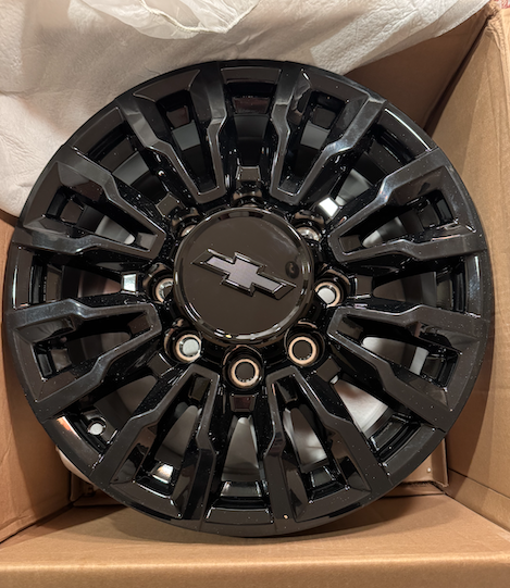

Decided on these wheels (OEM) from a Silverado 2500 in 18". Smokin' deal at $209/ea.
Haven't driven it hardly at all since the fall - just sitting in the garage waiting for camping season to start.
Does your chassis use the old 8 x 6.5 or the 8 x 180 lug pattern?
The GMT900 2500s kept the pre-2011 pattern all through production.
